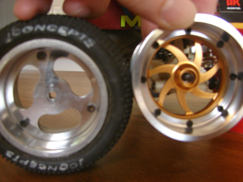

I have a dumb question, (but please bear with me as I"m into mainly Tamiya's) I've just got my hands on my new wheels & it seems as though the rear wheels centre hole for the axle is way too large for my axle? Am I supposed to put bearings in the rear wheels as well to support the centre? I have alloy wheels currently on my rc10 to show as a comparison.
What has everyone else done?
Again, sorry in advance for the stupid question
regards
Jak

That was my concern and question. Emerson said to try a bearing after I was trying to make a spacer. I have not worked on my solution yet.

Also, what bearings did u use on the front wheels as the standard rc10 ones are too big?

My plan is to drill and axles size hole in a bronze bushing.

shodog wrote:My plan is to drill and axles size hole in a bronze bushing.
And that's why I never throw anything away.
For the fronts, I'm using flanged bearings and a ~3MM spacer.

I had the same plan. What are you guys spacing your front wheels with? Also are any of you using the rings to make the wheels wider?shodog wrote:My plan is to drill and axles size hole in a bronze bushing.

The rear wheels go on fine and can be held in place with a standard lock nut. I don't plan to run the wheels so this will be fine for the shelf but I still wanted a little nicer tighter fitment.But then what did the other guys do and no mention of this?

I had some bronze bushes in my kit box (I think Astute ones) that fit well, used them on the Graphite and the Ultima rears.RC10resto wrote:But then what did the other guys do and no mention of this?
