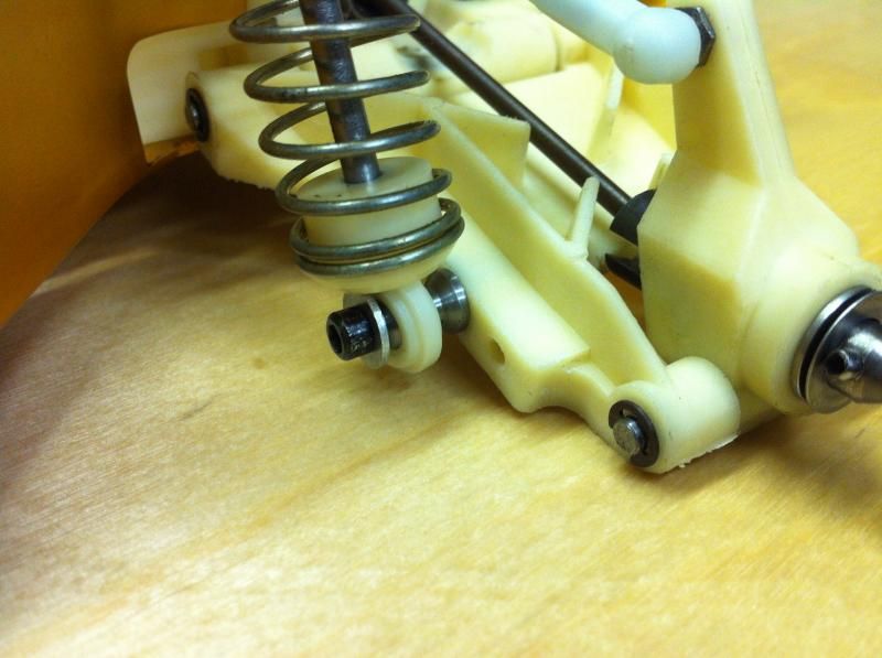

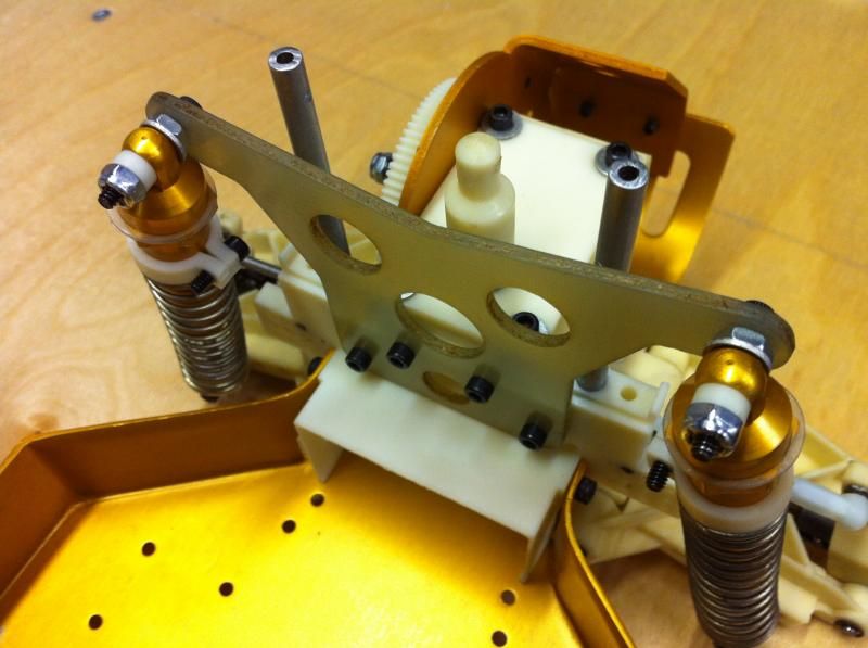

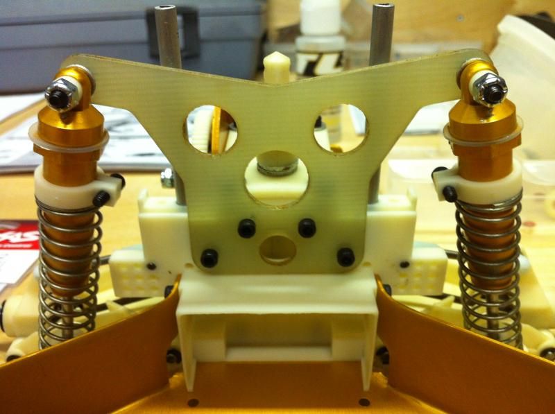

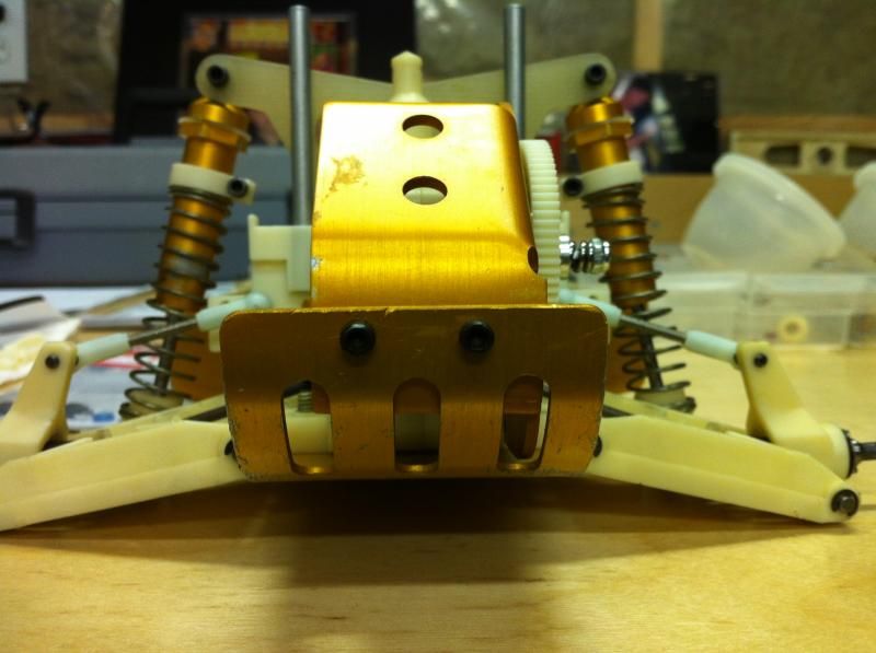

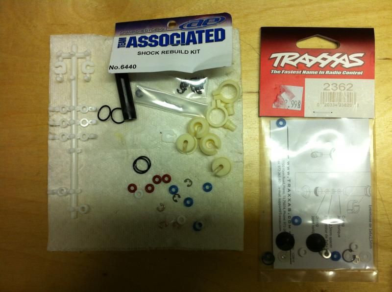

Re: Help Me Rebuild My Original RC10
I have the rear suspension together and I thought I'd post a few comments in case in the future there are others in a similar situation to myself.....rebuilding a Classic that they know nothing about! haha
You'll notice that the shock bodies are built from the bottom, not from the inside like the ReRe's are. I bought these two shock rebuild kits (x2 for the Traxxas actually, so that I'd get x4 'C' clips and larger nylon washers) based on the advice received earlier on in this thread.
From the 6440 Associated kit I used the small nylon washer, the red o-rings, and the big nylon spacer.
From the 2362 Traxxas kit I used the big nylon washers and the 'C' clips (*neither found in the Associated kit).
I also used the black cap cups from the Traxxas kit instead of the o-rings from the Associated kit after first trying the o-rings and experiencing air/oil leakage. I even reused the big nylon cap washers from the Original car which aren't even included anymore in the ReRe. With the black cups and the nylon washers, I have no leakage and perfectly adjusted shocks.
I find this suspension VERY heavy. I'll have to see what it's like with electronics, battery and motor installed, but I'd be surprised if this is a good spring weight and setup. You'll see that I put the upper spring collar down 0.25" as the original instructions indicate. Interesting that the ReRe instructions are pretty much the exact opposite. I guess I'm not surprised. I have a feeling I'll be raising the collars all the way to the top at a minimum, if not replacing the springs entirely.
Hareware is installed to Original specs as far as order of nuts and washers and direction of nylon piece in cap. I found this made the shocks a little bit more vertical (fore/aft) vs. the ReRe instructions which have the nylon piece in the cap facing rearward which kind of bends the shock more than I thought was a good idea. There's also a washer on the bottom screw which is not mentioned in the ReRe instructions.
Like I said earlier, the stock springs are way too stiff. You'll want softer springs if you care about handling at all.
Ya I don't doubt you one bit after setting this up.85Edinger wrote:Like I said earlier, the stock springs are way too stiff. You'll want softer springs if you care about handling at all.
Any recommendations front and rear?
Okay. Why? Original and ReRe instructions say to use this one.mikea96 wrote:You should move your shock all the way to the outer hole on the suspension arm.
They handle better without the shocks standing so straight up and down and you can even drill a new hole on the tower that is slightly more inboard
