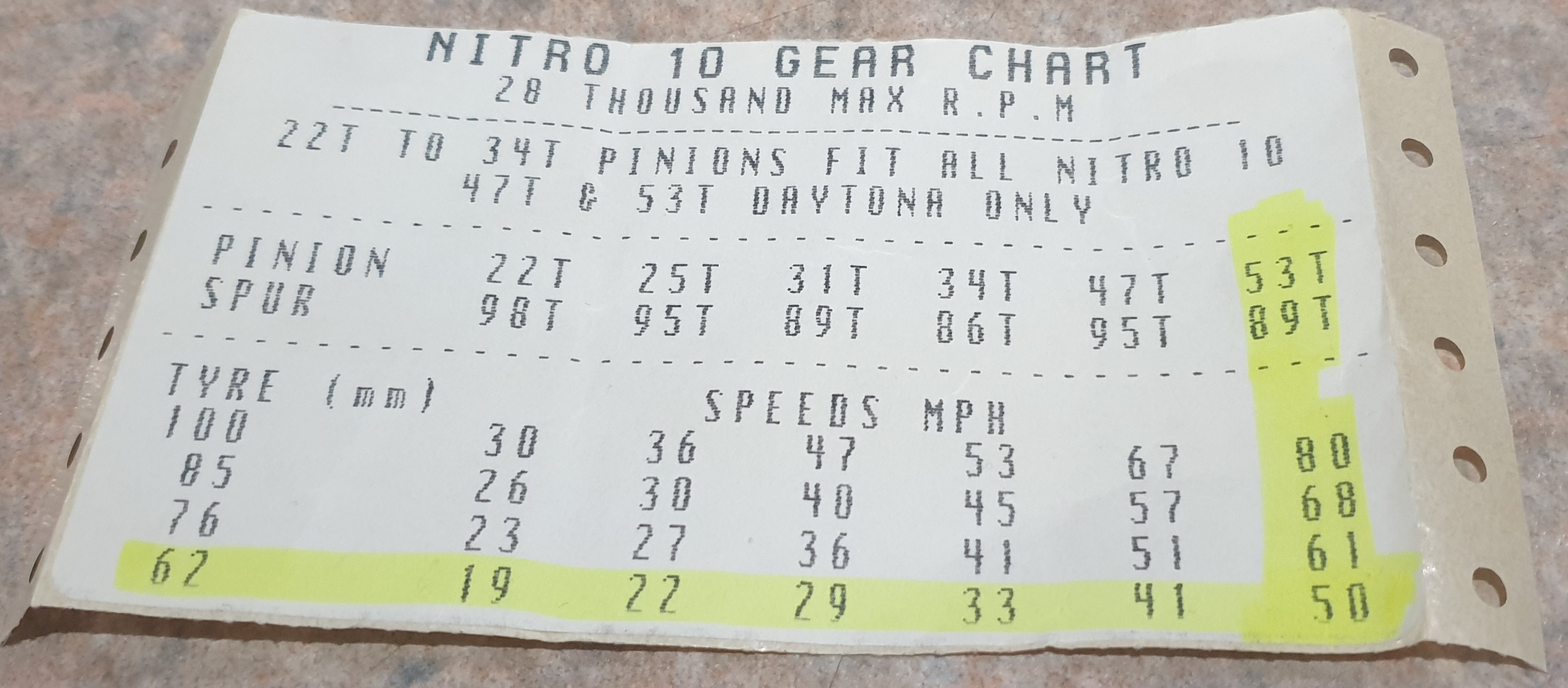

I've been working on the gear mesh ever since I mounted the Irvine engine. When I sent it to RJ for him to play with, I sent up Nitro 10 versions, which come with smaller clutch pinions (25T in this case). The Nitro 10 range have pretty much set ratios (pinion and spur pairs), so I needed to provision accordinglty. However, 25T in the Daytona would only equate to a top speed of 22mph (35kmh), which would mean too much acceleration, and plenty donuts (with my terrible driving skills).
The Daytona does, however, have it's own optional pinions available - 47T and 53T. These should be able to give some much nicer top speed, and I'm sure I can sacrifice a little acceleration for such a good cause! They are fairly rare parts, but luckily for me, I have new spares of each, and so picked out a fresh 53T bag from the collection.

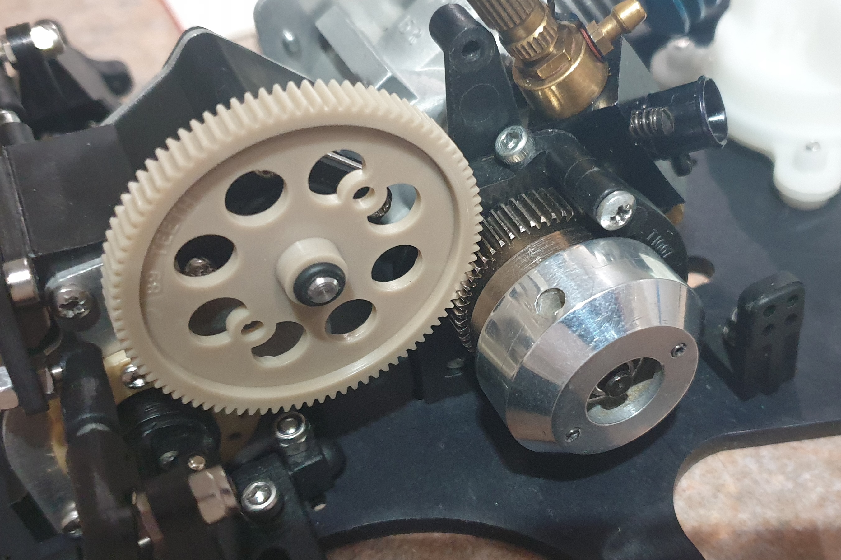

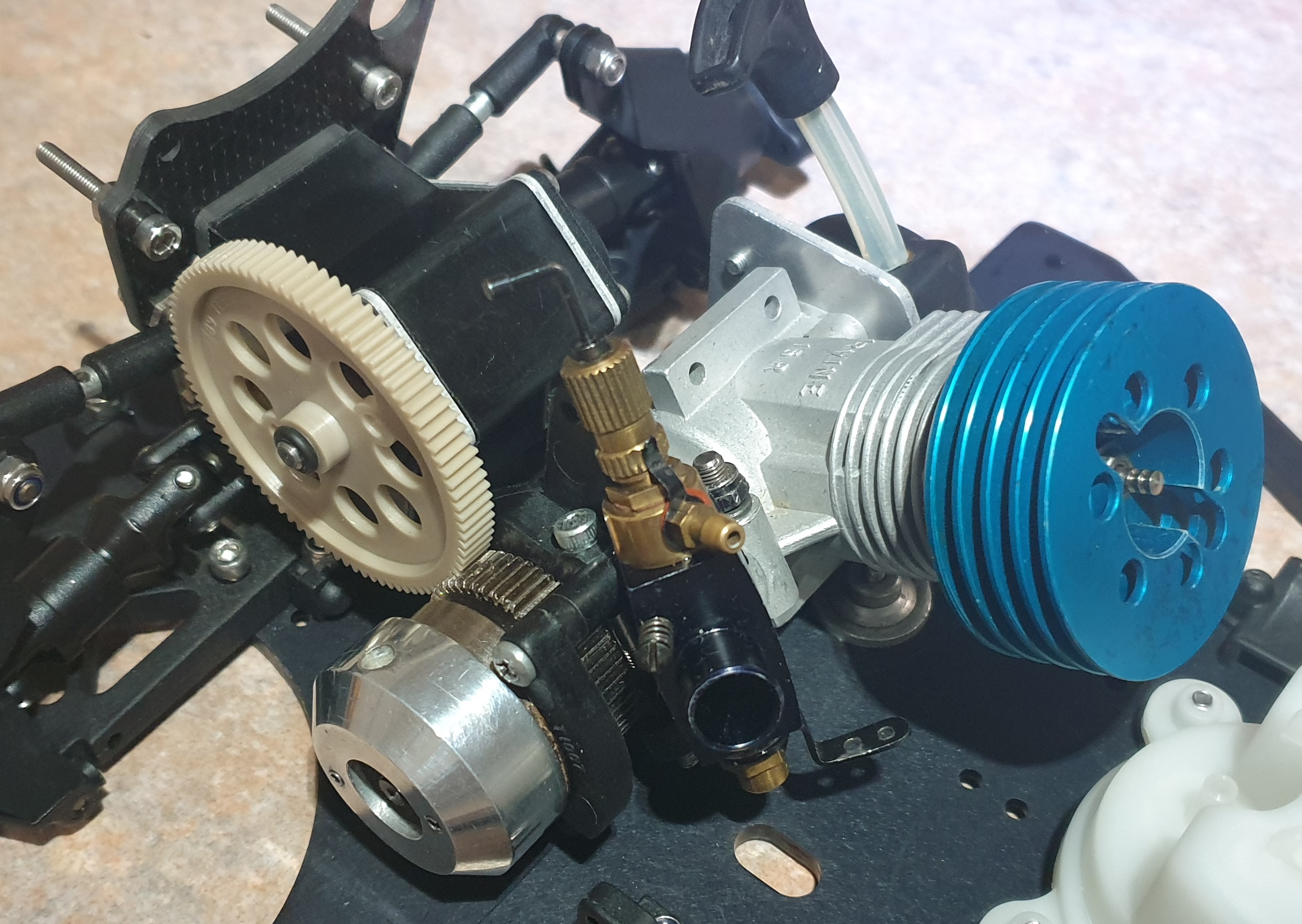

- So next step was to mount the spur to match (89T, according to the gear chart). This is where the next issue presented itself.... the combined spur / pinion total for the standard gear ratios is 120 (i.e. 95T spur, 25T pinion). Given this figure, the 53T pinion would require a 67T spur, in order to fit in the allowable space! The gear chart says use an 89T spur though, which gives a combined count of 142T..... NEVER going to fit in the space! This is where I realised why the Daytona chassis has an extra set of engine mounting holes... so the engine was unmounted AGAIN, and put in the now correct holes. Would be good if there was some sort of instruction to mention this :shock: :roll:
The build came together further from this point, with the installation of the reactor plate and engine tie rod next on the agenda.... and here, the next issue showed itself. The engine tie rod is a brace that mounts from the rear shock tower to the top of the engine mount, and consists of a threaded rod with a rod end at one end, and a pair of nuts at the shock tower end. The one I have..... would suit the engine mounted in the stock position.... to use the larger pinions, I need one about 10mm longer! Dammit..... back to the shed tomorrow, to start looking through parts for a suitable shaft / threaded rod / turnbuckle.

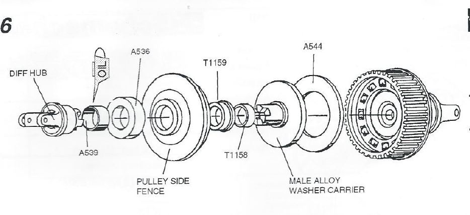

1911Colt wrote: Wed Dec 27, 2023 8:27 am An 80 mph nitro car that appears to have the same transmission as a Top Cat. :D Were the internals upgraded for the Daytona? Released in 93, so Cougar 2 Works internals, perhaps?

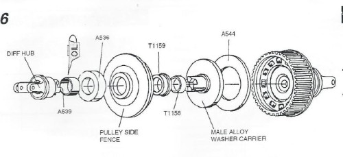

The transmission internals are certainly improved over the TopCat and original Cougar. This is the Daytona diff from the manual:

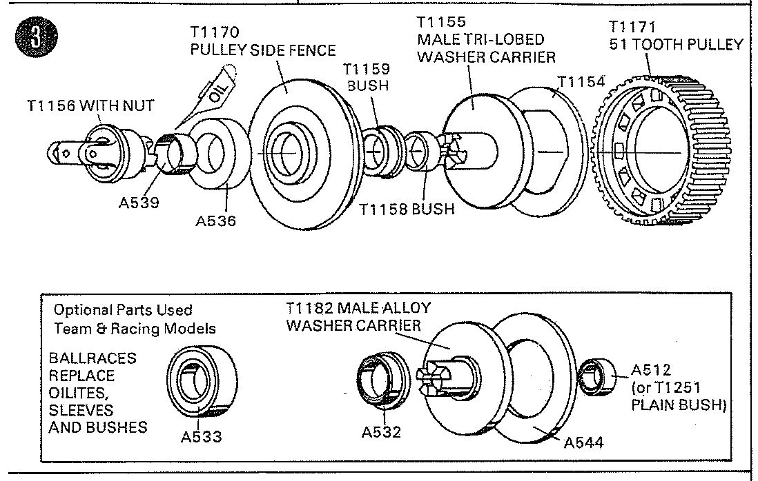

According to the manual, it utilises the alloy washer carriers and round diff washers, as seen in the Cougar2 Team and Works, but with the bushes usually seen in the normal Cougar2 version (plastic trilobe plates and washers). This is from the Cougar2 manual.
I am pretty sure mine is not alloy, but I'm too scared to pull it apart, as it just feels so smooth. Might have to look at a few of my others, and see if any of them have alloy washer carriers.

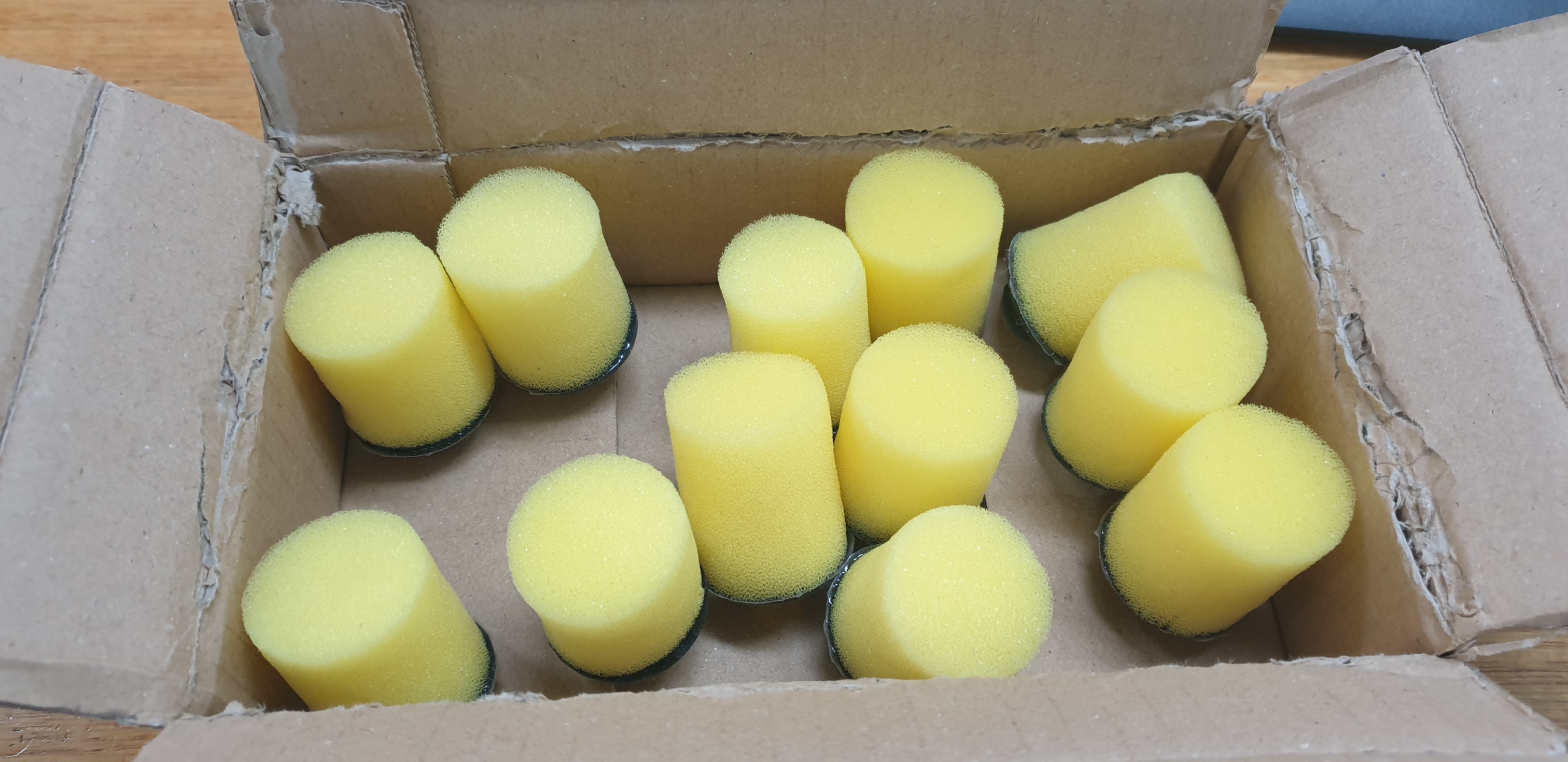

Quick six monthly update.... got some awesome repro Irvine air filters from my good mate Andy in Slovakia....
Just the thing I need for keeping my @RC10th-rebuilt motor safe.... plus, extras for alllllllll the other Nitro 10s as well (well, almost :P )
