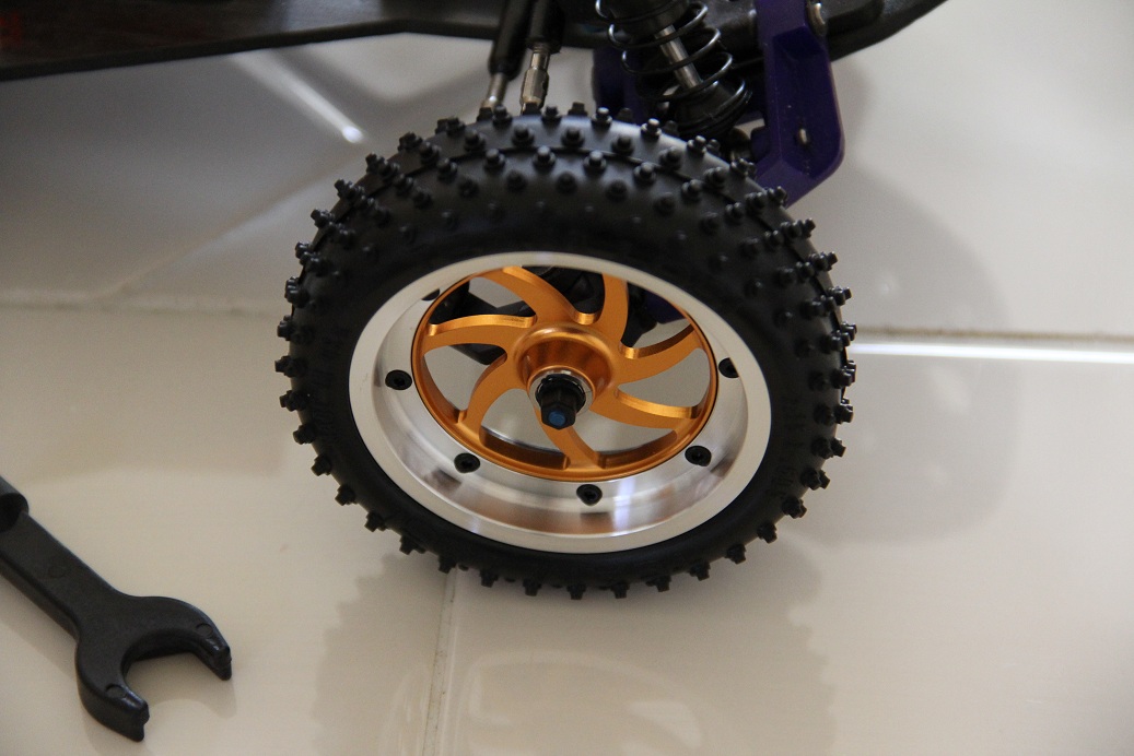

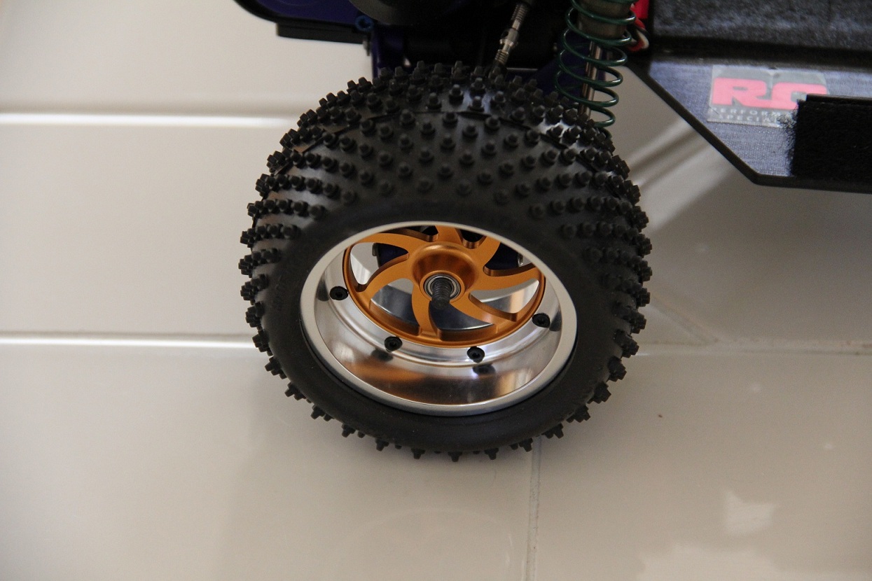

I used current b4 diff bearings on the rear, and old school smaller flanged on the front.
front
front
rear
rear

RC10Sprinter wrote:I used current b4 diff bearings on the rear, and old school smaller flanged on the front.
Where did u get the tyres from?, brand etc, also are they a soft M3 compound?
regards
Jak
"Don't underestimate the power of a backhander. They F&^%ing hurt" SuperWog
RC10Sprinter
Posts: 22
Joined: Tue May 13, 2008 11:18 pm
Re: Lohas has essentially remade the tecnacraft wheel
Post by RC10Sprinter »
They are losi step pin tires. fronts seem a little hard to find, I have been looking for some for a while. Rears are silver, so not that soft.

Can someone post the size of the bearings for the front (the older flanged) and the rear (the b4 style). I want to place an order.
Thanks!!
RC10Sprinter
Posts: 22
I am pretty sure they are the same size, just flanged and unflanged. 5/32 X 5/16. You could actually use unflanged on the front, but might need to use more spacers. As well, you could actually use the flanged on the rear. This is the size I used, it is a inside b4 diff bearing. The bearing has about 1mm play inside the inner rim. And fits snug on the rear axle. Hope this helps

original rc10 front wheel bearings are 3/16" x 5/16" flanged. rear hubs for b2/b3 are 3/16"x 3/8" unflanged(with 3/16" axles). B4 can have either the same as b2/b3, or a larger outer bearing.

jwscab wrote:original rc10 front wheel bearings are 3/16" x 5/16" flanged. rear hubs for b2/b3 are 3/16"x 3/8" unflanged(with 3/16" axles). B4 can have either the same as b2/b3, or a larger outer bearing.
The inner diff bearings are 5/32x5/16 on the B-4.
