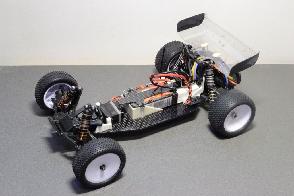

This is my latest test layout. Used it in a race last weekend.
Completely new track to me and suffered also strange power cutoffs so there are not much to tell about the race itself. Too many crashes in Q1. Q2 went really well, car balance was good but two rounds after mine, we had a "shock oil on track" incident. Rest of my day went cruising with massive understeering... and power cutoffs. Nice. Shorty-lipo in most forward position and wide front wheels were not enough to compensate changed track conditions. Did not have time to do more setup changes because I was trying to figure out the power cutoff problem. Might be the ESC switch. Receiver change did not do much. Now there is no ESC switch anymore. Just a jumper wire.
No weight limit in our Stock-class so I tried to go as light as possible. Car weights 1385g without front box 25g weight.
-Niki-
-Niki-

Re: RC10B2 (B3) Graphite - NIXconcepts
Standard Length car or extended?
What front wheels are you using?
I knew the shorty pack would eventually make its way into the car,
. You seemed almost defiantly against it when I suggested it a few pages back, Haha....
I'll give you another idea to refuse to do, but eventually try at a later date.... Big Bore Shocks,
Standard B2/B3 length, chassis NIX9200.
Front wheels: U6607 Schumacher Mini Pin - Yellow (4wd front)
I was thinking of maybe putting B2/B3 shocks back. It would give me more down travel for rear arms. Or then B3 FT rear shock tower and Deja-Vu body... or... big bores...
-N-
