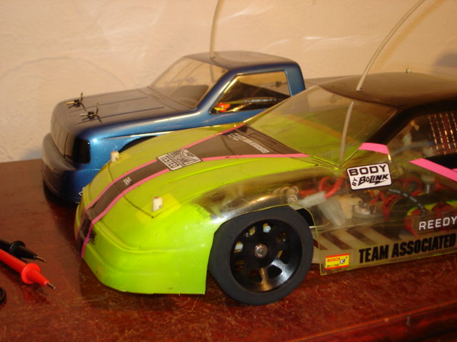

Walmart sells a product called "citristrip". It comes in a metal can for around $4, and is safe for all plastics as well as other surfaces, and it smells like oranges. Apply it with whatever method that you like, I usually just soak the body in a small bucket or basin, and the paint will come of in a matter of minutes. It doesn't fog or frost. Just be sure and wash the body really well afterwards or, your next paint job won't stick...I've been doing this for years and it works really well.....oh, and be sure it's the clear liquid and not the orange gel..
- Posts: 822
- Joined: Mon Aug 07, 2006 11:05 pm
- Location: Florida
http://www.rc10talk.com/viewtopic.php?t=855&start=0&postdays=0&postorder=asc&highlight=
I used the same process here as described in the link above.
I know Citristrip works great on furniture but never thought to try it on lexan.
