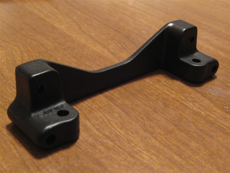

i see your asking about an rpm worlds front bulkhead. which arms are you planning on using, the rpm team car arms? they won't work with that bulkhead. they're to short, and they won't mount to the bulkhead, either. and you'd also have to narrow the front of the chassis to even attach the bulkhead to it. you'd need to find one of the rpm 1 piece front bulkheads for the standard kickup. they only came in black.

this is the rpm 1 piece bulkhead. i don't remember the part number off the top of my head. they pop up on ebay every now and then.
andy's had one that was very similar, too. i don't have a pic of one on my laptop, though.
