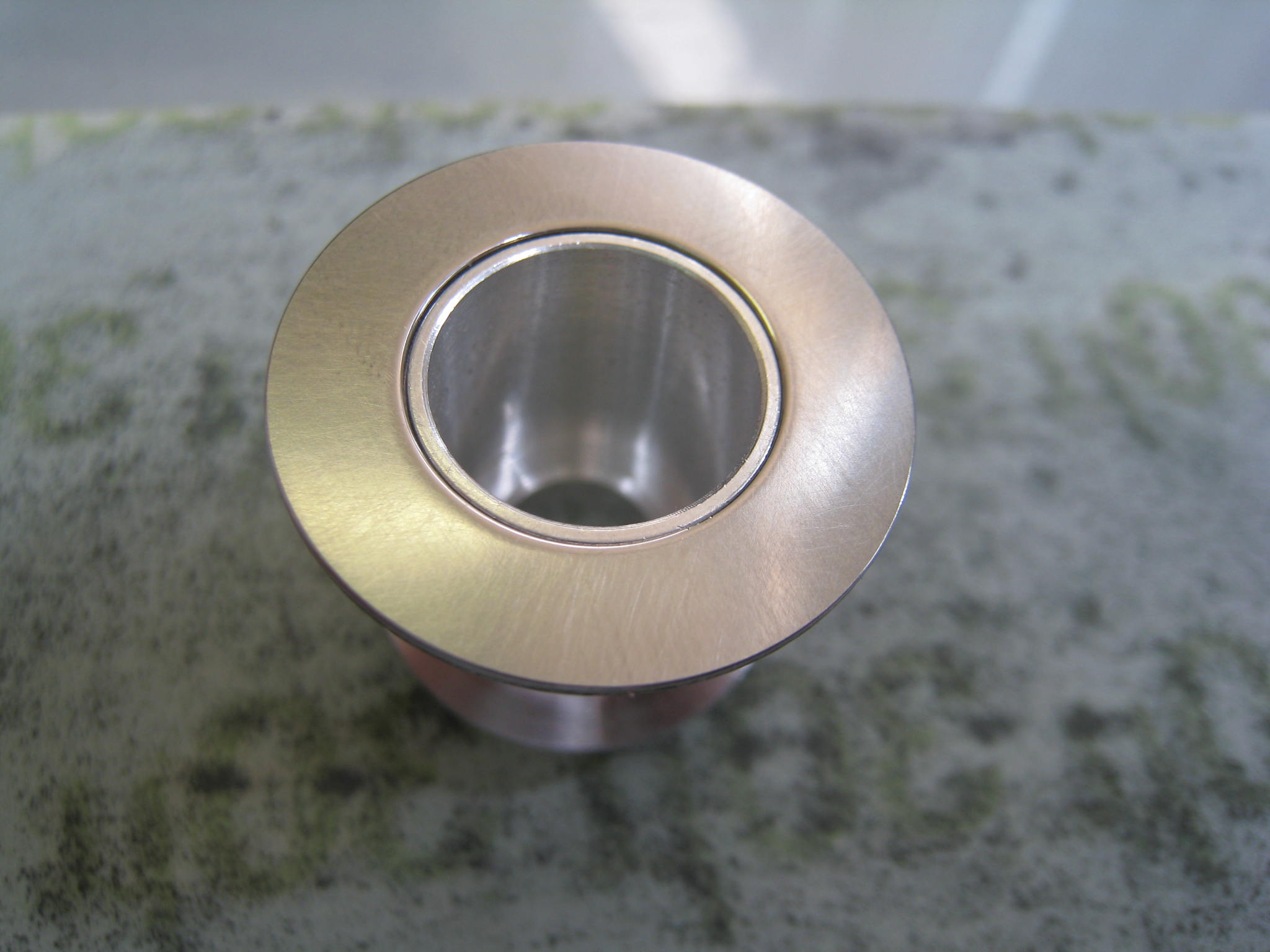

Here is showing you how to use Micro Finishing Film to Grind & Polish the 1/12 Diff. Ring.
This is the Associated Diff Ring ( 12LW). The ring is “cone”when punched out during in the manufacturing process. So, we need to use the micro finishing film to “grind” it flat.
Besides, we need to gently "rough" the surface, so the steel / ceramic balls can grab on the rings instead of slipping.
We use Micro Finishing film because it provide a better Bearing Surface area on the diff rings than conventional abrasive sand paper. But, it is a bit costly.
You diff now run super smooth, and you don't need to over-tighten your nut, the balls also last longer. :D

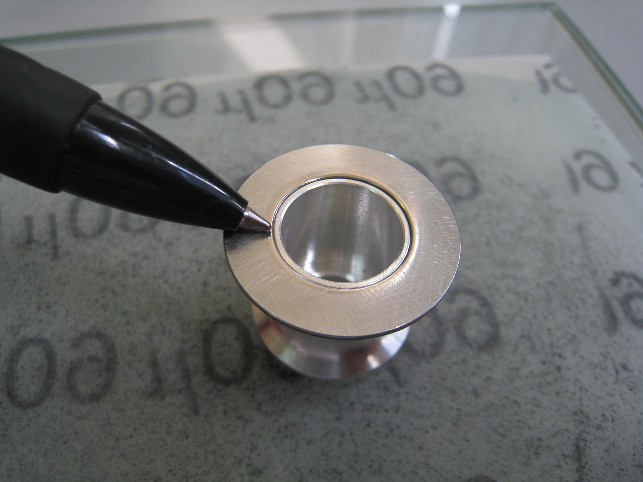

Spray water mist on the glass surface, place the 60um grit micro fin. film on it. So the film is “sticked” on the glass.<br /><br />You can spray water mist on the micro fin. film, or just use it in dry grinding. You should use the “figure 8” motion to grind the ring, Do not use the ‘circular’ motion, because this will not “flat out” the ring surface.

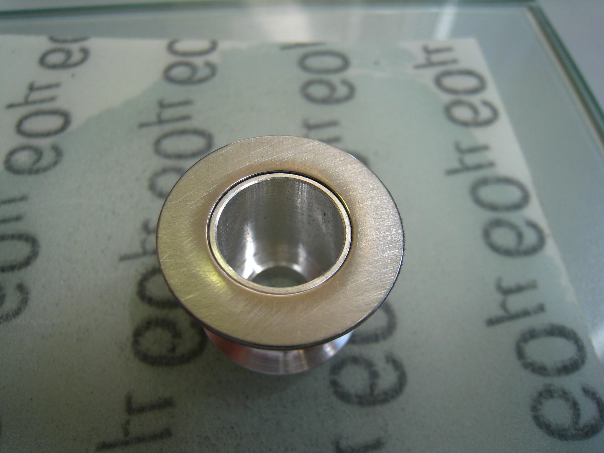

After grinding for a few minute, you can see the ring is “inside cone”. ( The inside of the ring is not touched by the micro finish film

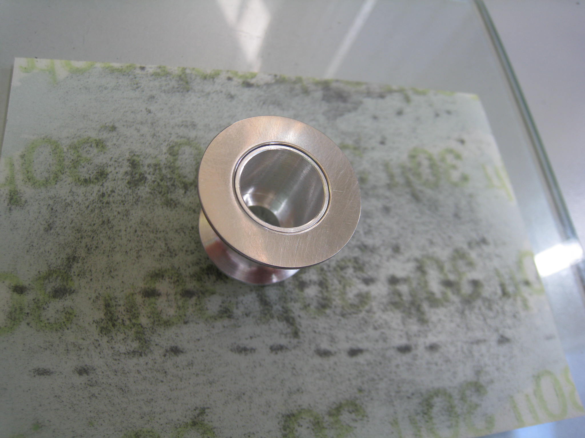

Keep grinding until it is flat. You can see the “inside ring” is now grind by the micro fin. film

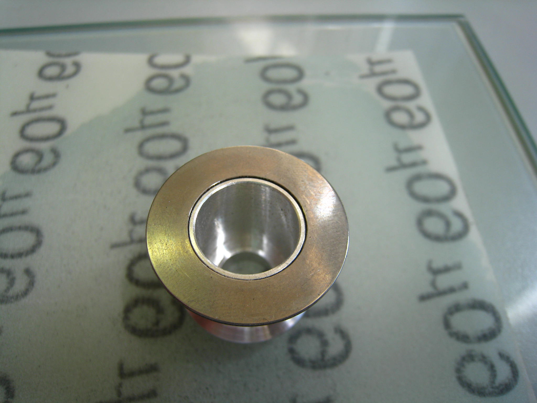

Now, switch to the 30um micro fin film to “polish” it.  You can use it in “wet” or “dry”. It is up to you ! I personally, prefer to use it “dry”, because it is less messy. Make sure you use the “wiper” to clean out all the debris on the ring &amp; glass surface after grind and polish.
Now, switch to the 30um micro fin film to “polish” it. You can use it in “wet” or “dry”. It is up to you ! I personally, prefer to use it “dry”, because it is less messy. Make sure you use the “wiper” to clean out all the debris on the ring & glass surface after grind and polish.
Now, it is finished !
