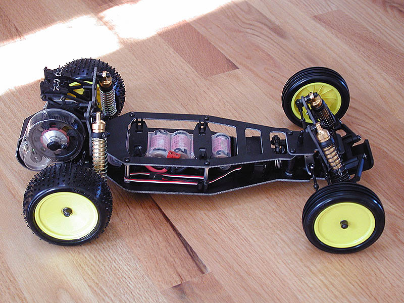

JR
Posts: 85
Joined: Sun Aug 06, 2006 7:03 pm
Location: New Hampshire
Post by JR »
Not much to look at yet! Heres the Gearbox done.

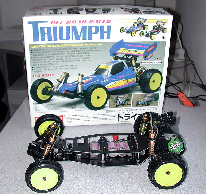

teshreve
Posts: 358
Joined: Mon Jan 29, 2007 2:27 am
Location: Oregon, USA
Has thanked: 31 times
Been thanked: 27 times
Post by teshreve »
Here are some pics of mine...

JR
Posts: 85
Post by JR »
Here are more crappy pics of the build up. Its done finally after 4 years of saying it was going to get built. Now its time for some era correct electronics, a le mans motor, and paint up the body. I was lucky to snag this kit NIB for a measily $65. Yeah not a total steal, but I like the price.

teshreve
Posts: 358
Post by teshreve »
They might look good, but they perform not as well as they look. The dual belt tranny rolls like a flat tire, the diff it typical crappy Kyosho (it slips until you tighten it to the point of not functioning), the drive hex that mates to the tire is held onto the axle with... friction. I was reasonably successful with it after putting a Stealth tranny in it. I tried the Dynastorm right after the Triumph and it was far better. Then I just finally went back to AE. Being the only person at the track with your car gets kinda lame after a while. ...and so does relying on Tower Hobbies for parts (and that was pre-Internet!).
