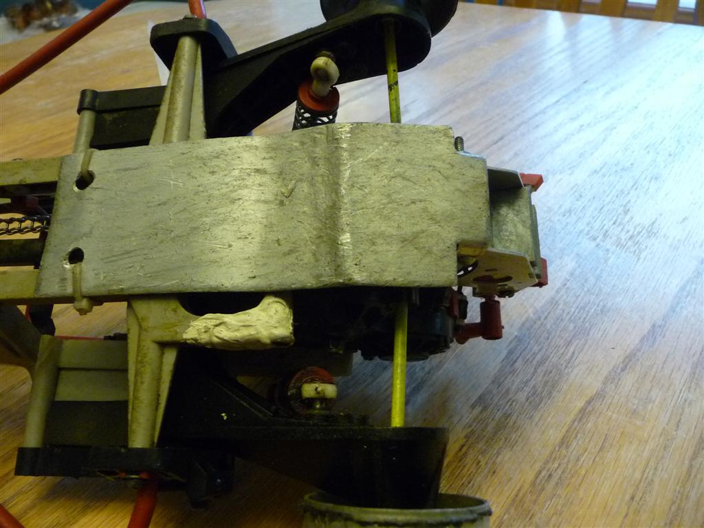

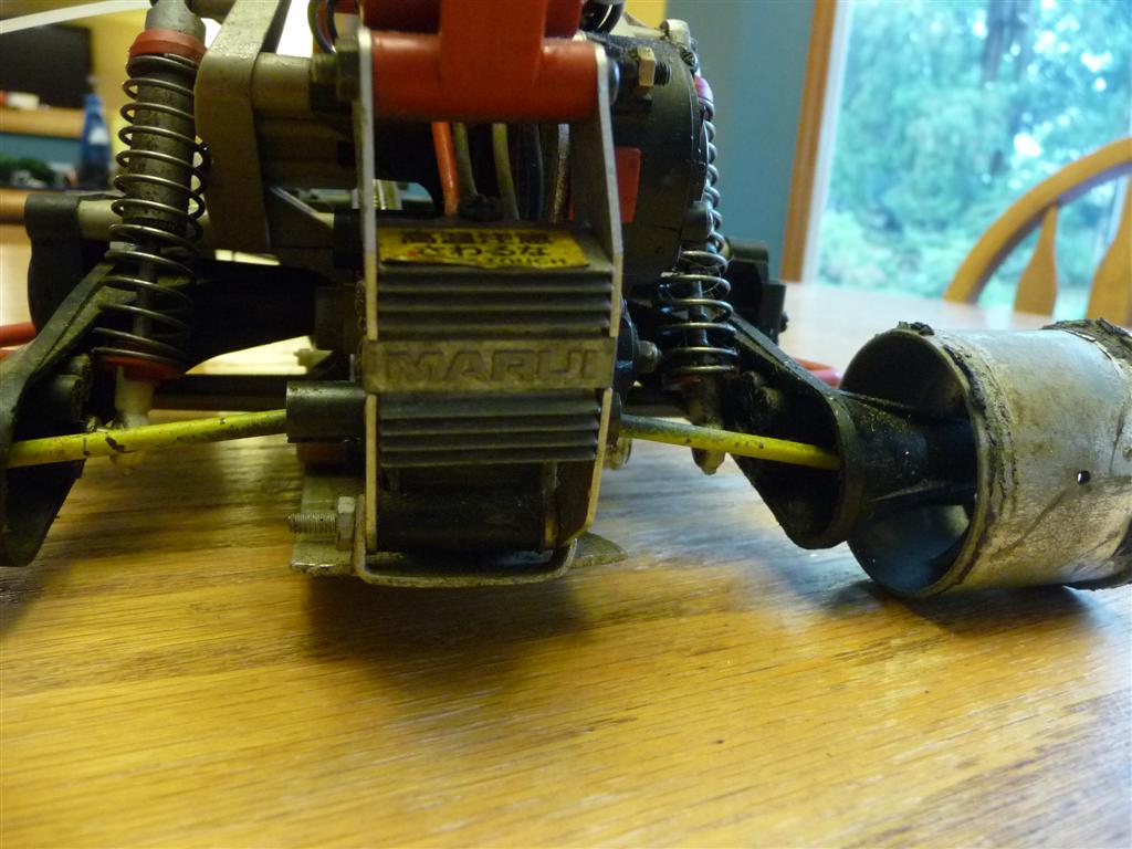

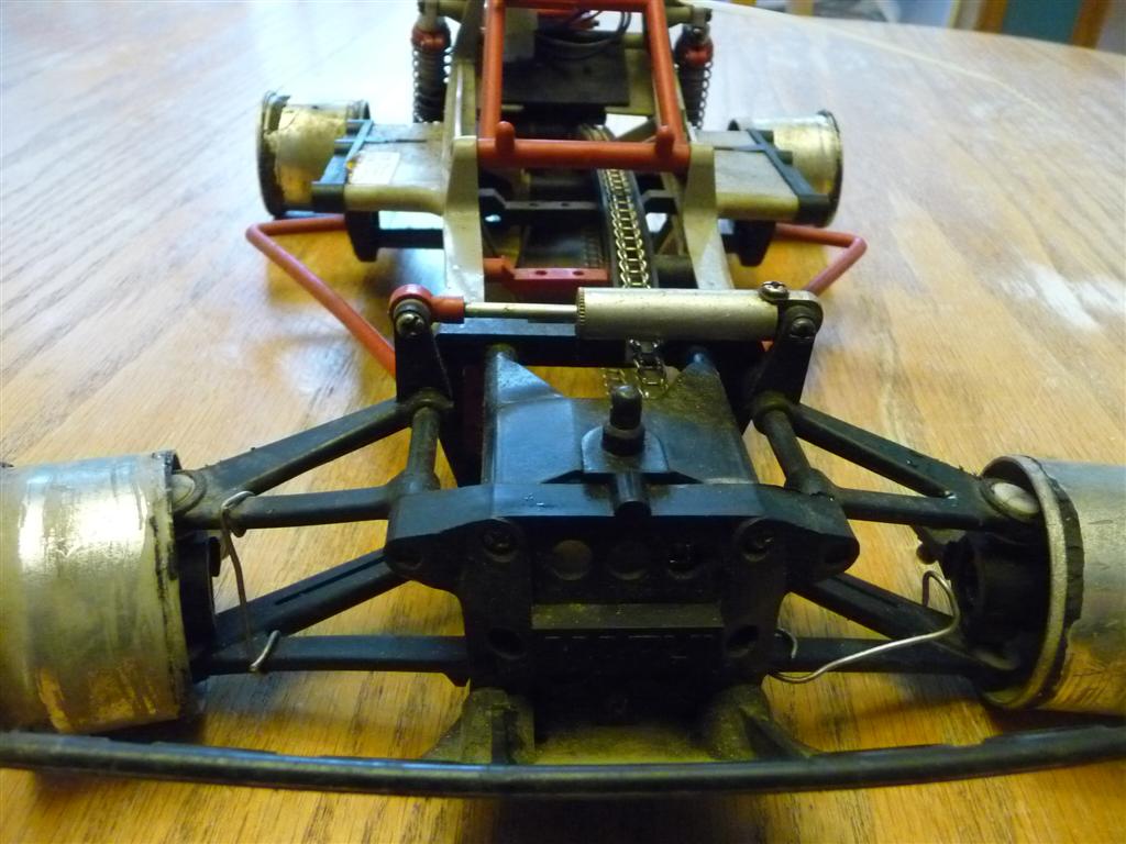

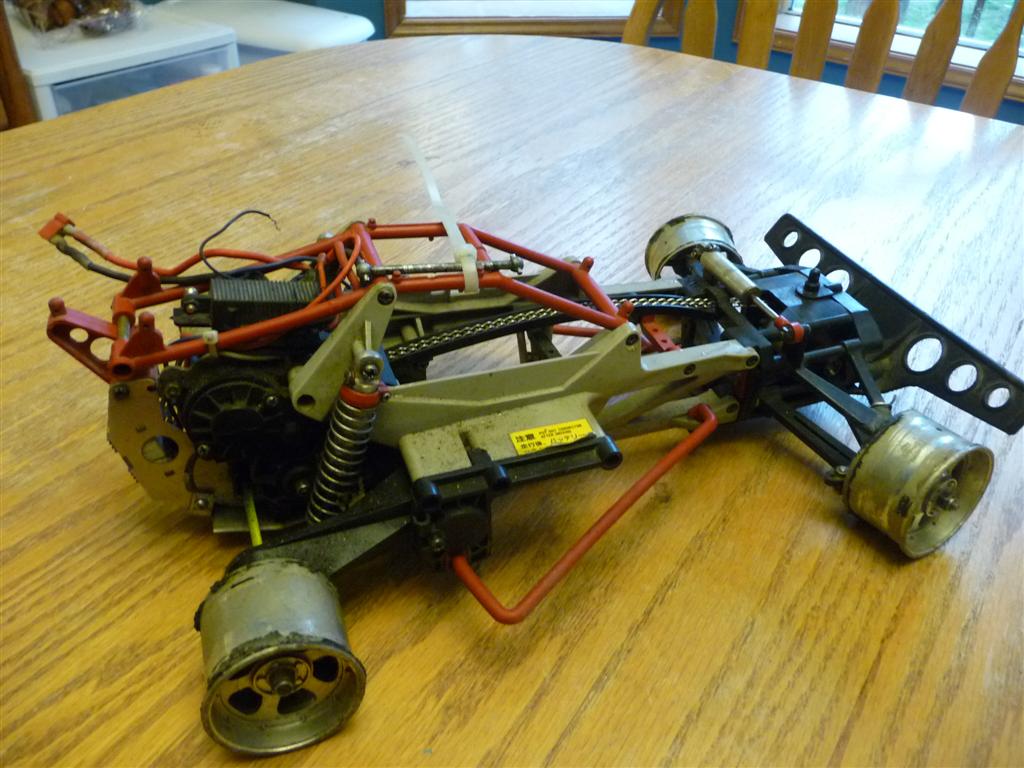

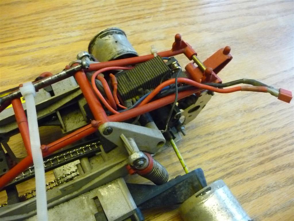

I think this a Marui Samurai. Found at a swam meet in pouring rain. Got it cheap.
It is missing one dogbone and has some interesting bondo work as well as a home made skid plate. Probably missing a bunch of other stuff. I know nothing about these but I always wanted one. I know parts are hard to find. What else can you tell me?

I have found a perfect modern match for the Samurai dogbones. Redcat Racing 61mm dogbones #02003 (search for tbrbumpers as the seller) have the same crosspin size, the same ball ends and the same pin-to-pin dimension. Wheels and tires are htf and expensive when you do. I am going to try to find some hex adapters that may work.

I'm afraid this one needs a chassis.
I see a seller has a chassis on ebay for $68 bin.
I don't like this car THAT much!
