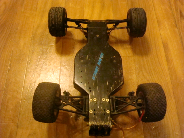

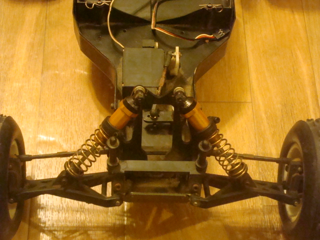

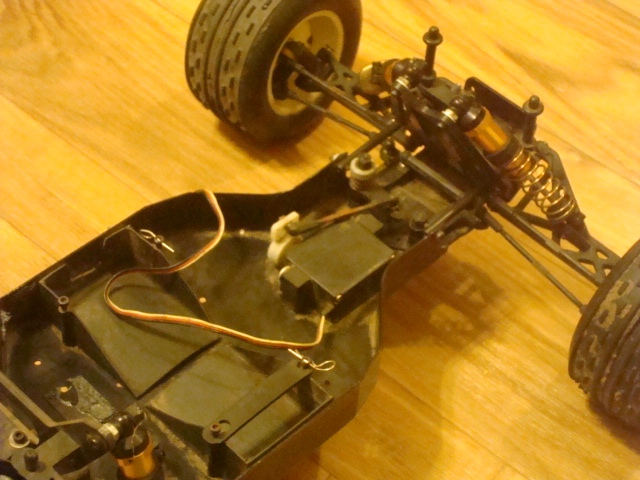

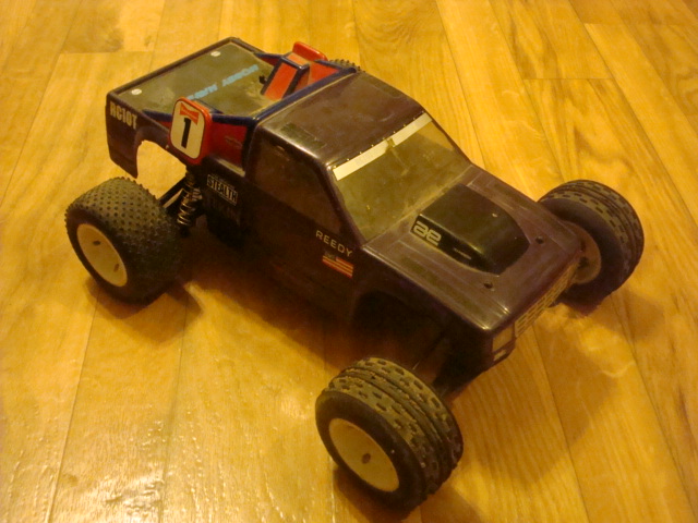

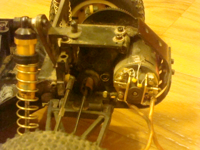

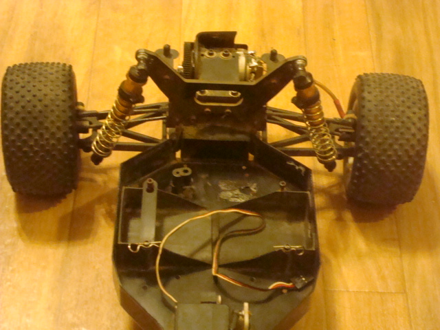

I know this may seem like it is in the wrong thread, being a truck and all, but I promise it will be a buggy in short order. Anyway, here are some pics of what came in the mail yesterday.
Overall, it is in pretty good shape for the $$. I was afraid it was a sport version equipped with bushings, but to my surprise, it is completely ball raced. Some surface rust on the fasteners, outdrives, dogbones.... the usual. Chassis bottom has signs of use, but nothing nasty like a bent chassis or anything.
The reason for this build: I got the wife started with a B4. First time driving ANY r/c vehicle on the track. Lo and behold, she really enjoys it!. I let her drive both the B4 and my '91 worlds car, and she prefers the worlds car better. Can't blame her, so do I. So to further her enjoyment with racing I told her I would make one of her own. I will not be cutting down the sides like mine, just leave the chassis stock. Build process will be documented including pics and part #'s. For anybody looking for a well balanced vintage buggy to race, copy this setup. It works.
