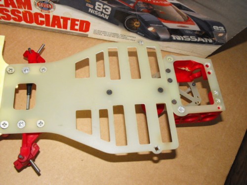

I just doug through the parts and put the I back together as much as possible. I need to find a rear pod top plate, and hardwere, and two post to hold up the radio tray. and were good unless you see something wrong. if so please speak up I have never had a 12 scale anything except a lunchbox.

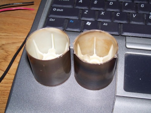

I soak mine in "purple power" cleaner for a few days, cut a slit in the foam from the inside to the outside of the rim and peel it like an orange. (It's slow, but very effective). Here is a set of rears from my 12lw I just "cleaned-up"

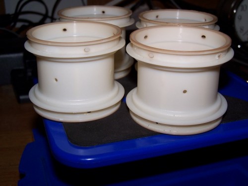

I use the method that bearrickster described verbatum...a 1 gallon tub with a lid, an old toothbrush, a razor blade (or x-acto knife) and some scraper's and I can clean just about anything. 8) I am right in the middle of restoring my MRC MT-10M, and I just completed cleaning the wheels. They had bits of rubber tire and CA glue pretty much covering the bead, but after a couple days soak and some elbow grease, they are ready for new tires. So yes, it works on rubber tires as well.
