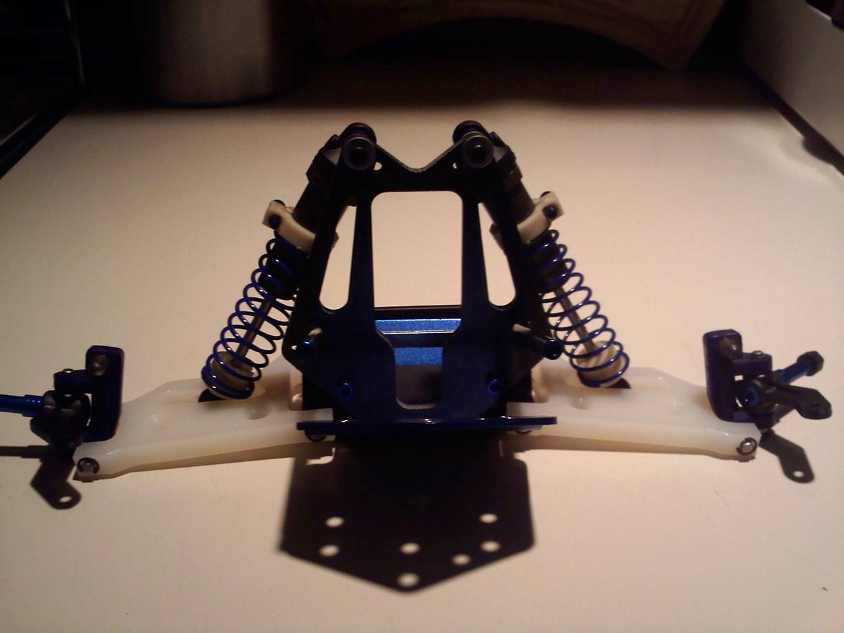

Hey everyone,
Just wanted to share my efforts of taking the old and making it new. Check out the attached pic.
Quick questions.
1) RC10 hinge pins in the front with the RC10T bulkhead and dynotech arms are too short. Do I need to get RC10T hinge pins to make it work?
2) The RC10GT noseplate can bolt up to the main chassis in two positions. Which one should I be using, the one farthest away from the chassis or the holes closest? Farthest away setting let's me bolt the GT Nose Tubes up to the chassis without any drilling but I think this is wrong. Do I need to drill new holes and bolt the noseplate closer to the chassis?
Thanks in advance for your help.
Quick questions.

Re: Jumping on the what's old is new bandwagon
Welcome aboard the wagon
Quick questions.
-- Yes, you will need to order a set of RC10T hinge pins.
7209 Associated Hinge Pin Inner 1.675" Truck
http://www3.towerhobbies.com/cgi-bin/wti0001p?&I=LX2916
-- You will need to use the holes closest. This will require drilling holes in either the tubes or the chassis.
Ed
Quick questions.
Ed
Thanks Ed! Lifesaver. So what do you think? I was very proud after finishing it last night at around 1:00 AM.
It's looking good.
Did you re-anodize or paint the nose plate?
Ed
Looking good TViz, one thing I like to do to these arms before mounting them is to round the edges on the hinges areas (specially the inside side) to prevent for the arm to rub with the chassis. You can look at a typical set of front arms and see that they are round around the hinge.
Keep the photos coming it is looking like a great start.

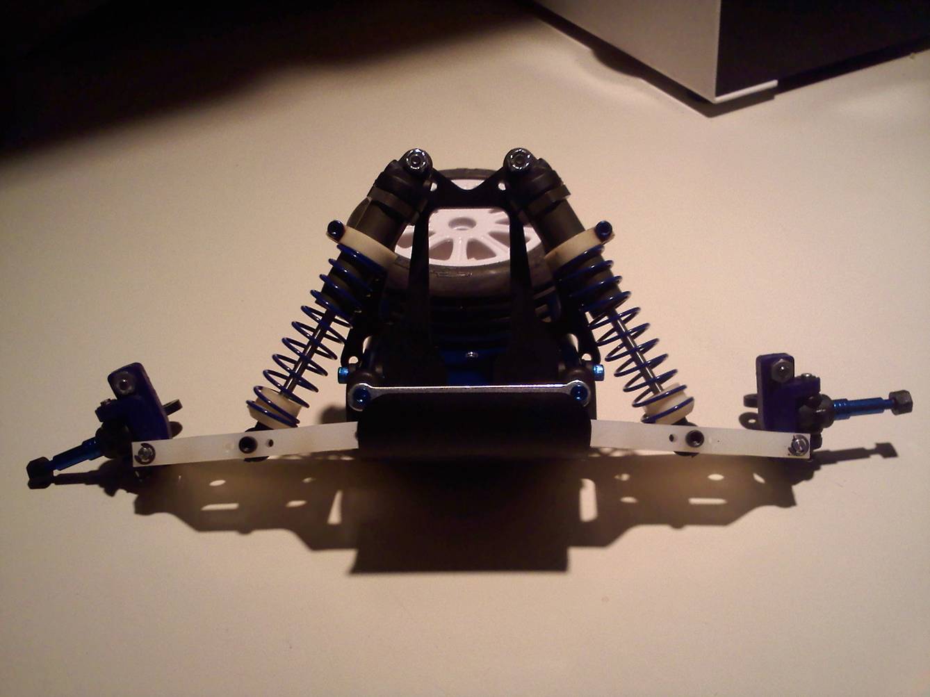

Thanks guys. Yes, blue was the theme I was trying to go with. The body will be white though. Pearl White actually with black accents like the ae logos and some other ideas I'm thinking of.
And Miguel, so funny that you mentioned the rubbing. After I finished putting the arms on last night, I tried to move them and they were a little tough. So I moved them back and forth a bunch of times and they became looser with the delrin bending as it rubbed the chassis.
I have all day Sunday to work on it and will break out the dremel to round off the inner edges a bit, shape up the chassis to the way I'd like it to look and finish the back end with the B44 CVD conversion and 2.2" wheels at all corners.
