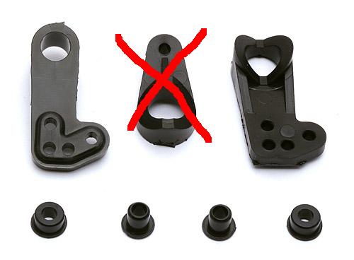

has anyone tried a T2/GT servo saver on a rc10? Just wondering if it will work before I try it.

I know that Lowrydesign has used those parts in an rc10 before, I just can't remember why...

If your talking about these: http://67.199.85.166/main/productdetails.php?text=7531&category=3015.10gtx
They work perfect
I actually bought a complete set and the instructions said "New steering for all RC10 Models except B2" or something along that lines...
You just need these too: http://67.199.85.166/main/productdetails.php?text=7306

http://67.199.85.166/main/productdetails.php?text=9155&category=3010.10b2x
These have the same geometry as the DS/GT bellcranks, except the servo is mounted in-line. They fit the standard steering screws, but the right one might need some reaming of the bushings, so they pivot freely.

[quote="SteveK"] http://67.199.85.166/main/productdetails.php?text=9155&category=3010.10b2x
Or you can use those and the servo rod mount from the GT steering and you wont have to change the servo mounting

Re: T2/GT servo saver on a rc10?
Thanks
That is great news I can now ditch the kimbrough servo saver and be able to adjust the tension of the spring.
