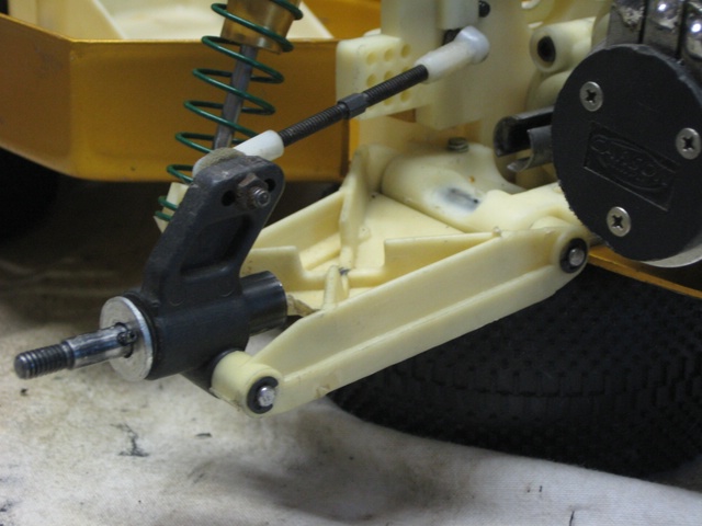

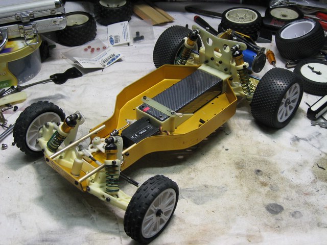

Here are some pics of what I´m building right now. I like to use B4 wheels on my RC10 gold pan car.

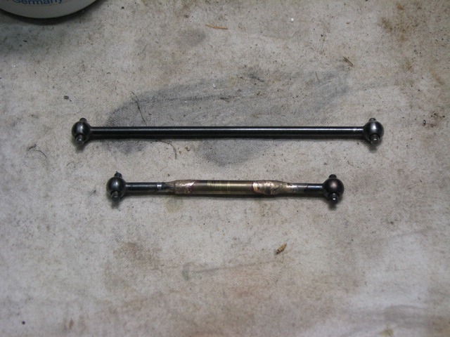

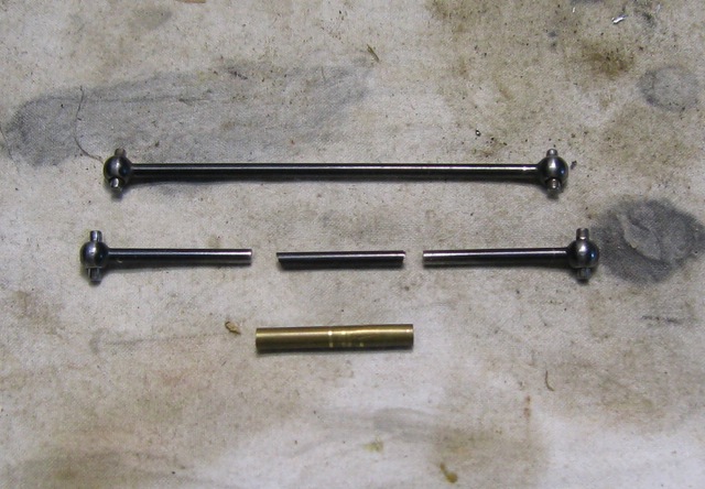

Just take the B4 hubcarriers and drill them with an 3.1mm bit and they fit right into the white rear arms. The only problem I had was the dogbones. The originals are too short and the B4 MIP´s are too long. So what I did was to tke a set of bones from my SC10 and cut a part out of the middle. So each bone end will be a total length of 33mm. Then I took a peace of brass tubing and soldered the two ends together. Thats it. Its not pretty but it gets the job done. Now I have to relocate the battery hold down in order to fit my hardcase LiPo´s in there and she´s ready to hit the track.....

It doesn't seem they would rotate true. I wish AE would just release some parts to run modern wheels.

I tried the B44 rear CVD´s the other day. And they are just a little too long for my car. So I raced my VRC10 last night in the combination I posted earlier.
The changes I made was to switch to blue springs in the front with WT50 oil and #3 pistons. In the rear I installed silver springs with WT50 oil and #1 pistons. I got to change that to #2 pistons, I think. The car really took off and had great handling on our carpet track.
I used Schumacher stagger ribs upfront and mini pins in the rear.
It is a blast to pass a B4 and gain seconds after seconds per lap
I love my VRC10
