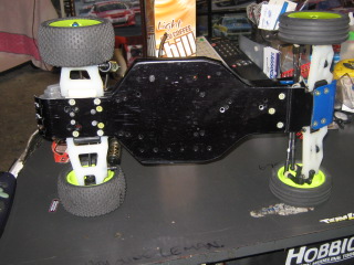

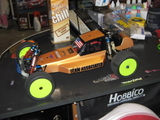

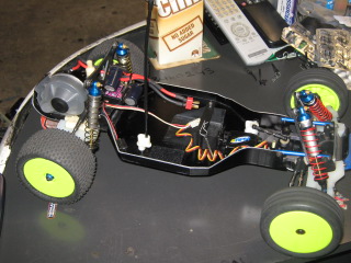

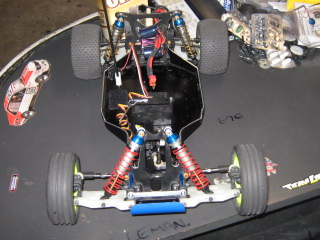

Hi all quite new to this, i picked up on ebay an RC10 from the US, it was listed as RC10 rpm hybrid. It has klien arms and rpm hub carriers and i assume b44 cva's on the rear and klien arms and b4 carriers and steering blocks on the front. It has only been run on carpet and is in very good condition and i want to keep it that way so i put chassis protection stuff on it and was wanting to keep arms new also so i am looking at rpm arms for it. Will they work without to much hassle so i can run it for the odd pack here and there?

if your looking at the rpm "team car" arms, they won't fit. they're shorter than the klein arms. you'd have to find rpm "worlds" arms, which is not gonna be any easy task, or a cheap one. just use the arms that are on it. you can always get more of them if they get beat up.

Cool thanks mate. I just sent them an email to see if they post to Australia. If i was to try the team car arms i would have to get new cvd's also?
Posts: 16816
Re: RC10 klien arms question
yes, shorter rear cvd's, as well as a buggy nose plate, front arm mounts, inner front hinge pins, front buggy shock tower, shorter front shocks, and different rims. the rpm "team car" arms are not worth all of this hassle.

If those are the Dynatech arms, you will not need an extra set. Unless you frequent brick walls at top speed. :mrgreen:
