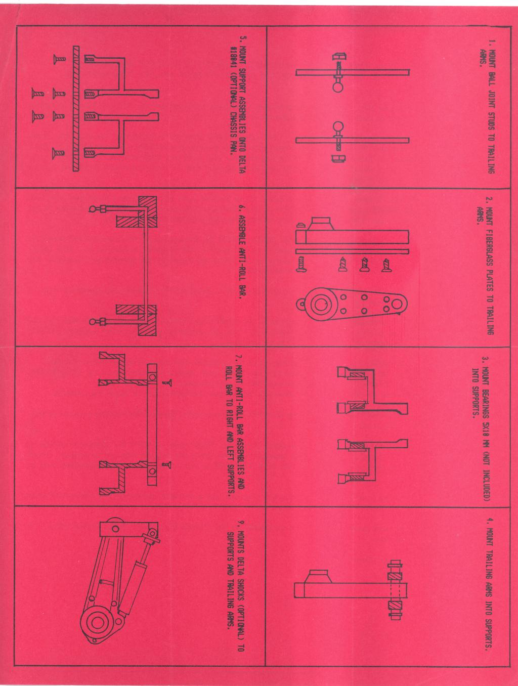

Re: What bumper for Yokomo 834B Delta Chassis?
I think they were originally pictured on RC10Talk in another thread but I have them saved so here you go. This is all I have:
Cool! That really helps.
so the rear shocks mount upside down, interesting. thanks ala01butal wrote:I think they were originally pictured on RC10Talk in another thread but I have them saved so here you go. This is all I have:
