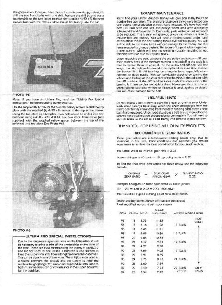

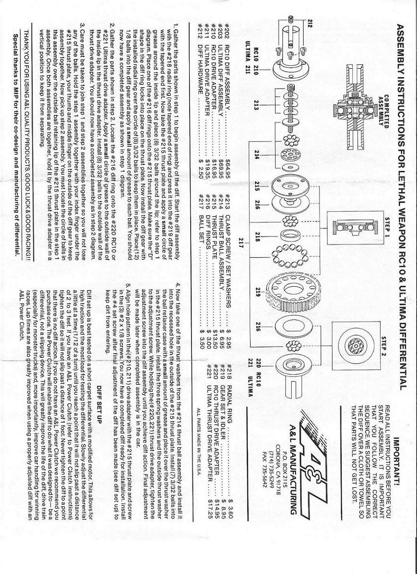

A&L Leathal Weapon Tranny Instructions
Post by tulsa »

Thanks for the scan, very helpful.
