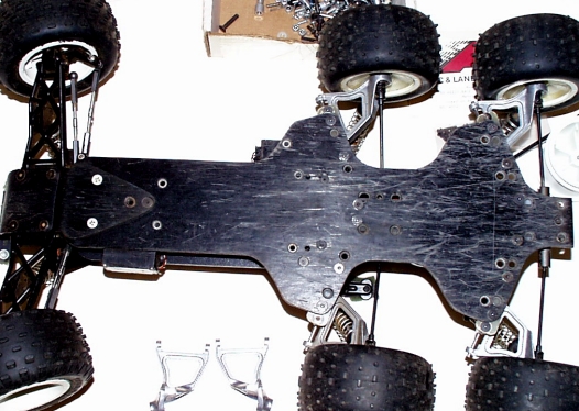

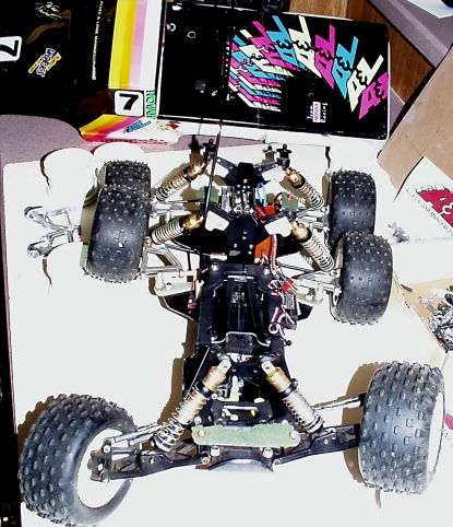

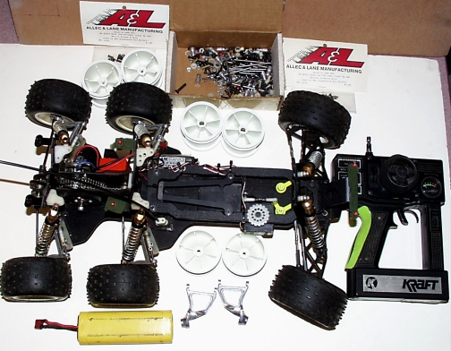

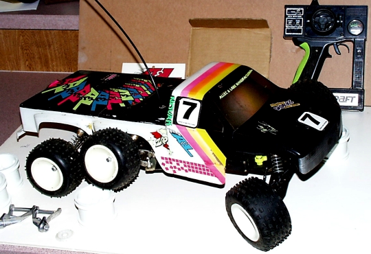

Here are a few shots of a three week project from 1992 or so.....

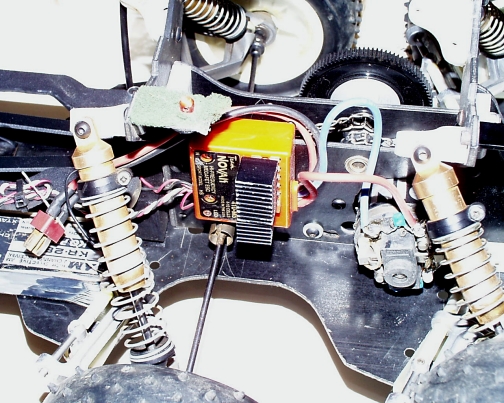

And of course an A&L Power Clutch...
6x4 6.jpg (175.27 KiB) Viewed 2602 times

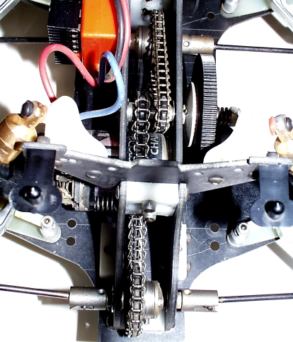

4WD 6X4 using Custom Works Dominater Chain drive and ball diffs.
6x4 8.jpg (179.72 KiB) Viewed 2603 times

very cool, 8) looks like it would be fun to drive :D

That thing is insane.
I'm guessing you have a basement/workshop full of California R/C car history. :D

That thing is mental Daryl, how does it drive?
Daryl Lane
Posts: 301
Joined: Fri Jun 01, 2007 9:29 am
Location: California
Post by Daryl Lane »
It accually worked GREAT, Went right to the front every race and stayed there for three mintues and then proceeded to DUMP....HARD!!
We did not have the Battries nor the Electronics to make it work back then. Another thought that was before it's time! :(
Chassis tuning was a breeze, to much steering more preload in the on the front/rear axle, not enough steering more preload on the rear/rear axle. Split the rear spring rates 50/50 which made the individual rear wheel spring weights really light, chassis stayed up off the ground and the wheels floated over the rough stuff like it was not there!
Oh yah - LOTS of forward BITE!!

I thought so. I remember seeing that truck in RCCA. Nice late 80s-early 90s graphics too. :D

Thats one tricked out ride Daryl, absolutely love it! Gotta have the Kraft radio for that old skool factor too!

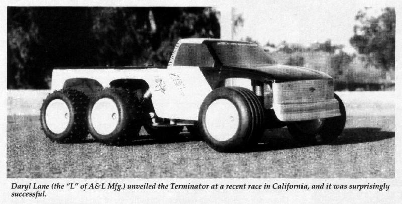

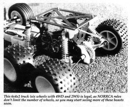

Nice one Darryl, it's great to see these old specials again. Here's the pictures and report from the very first race the Terminator ran in, courtesy of RCCA May 1990
