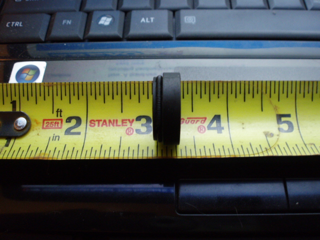

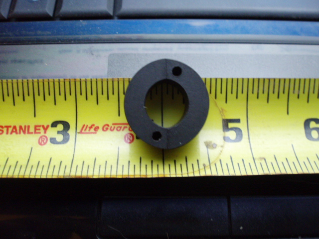

ok edit i need to play the lotto lol
as soon as saw the mip kit on the bay i realized i had seen that before, and sure enough i found the two half moon shoes and the spring.
as it was in a bunch of spares i got i don't have instructions is it as easy as fitting the shoes with the spring away from the motor ?
ill be breaking it in this week i was told it has to broken in in the truck ?
so ill run it with the stock setup and look out for the mip setup after run in ill be doing a little strip down to check a few things .
Paul

TH, that doesn't look like a GT clutch, it should be round when placed together like that, and it should have four holes, the second set being for the weights. That being said, if it fits in the assembly ok, then it should work fine. The spring goes out, and you will need to file down the clutch pins on the flywheel so that the clutch will sit flush against the flywheel. The spring causes clearance issues if you don't file the pins down, you will see what I mean when you put it together.
