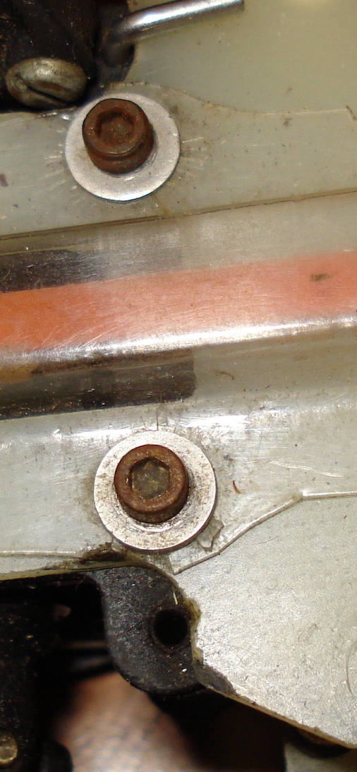

Re: CAT XLS question
Kaszal what is the orange plate, is it to spread the load on the top plate?
Did you make it?
Did you make it?
Hi Richie
You're right, it's to spread the load and stop the belt cover splitting. I made it with some thick lexan. I took it off and just dremelled away the belt cover around the holes. It's still sealed with foam tape. I used some reinforced tape to keep it securely in place. I've left the holes at either end to keep it straight. No more splits and no fear clamping the chassis together tightly!
I also borrowed a tip from someone... run the anti-roll bar UNDER the top deck so it doesn't get in the way of the belt cover.
