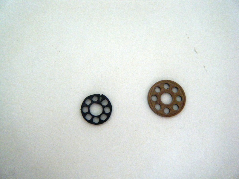

Post by RCveteran »
I thought I read Losi ones will work, one on left is Schumacher and 8mm across, all the Losi ones I have are like the one on the right and 10mm. Anybody know of something that is the 8mm size?

Re: Topcat/Cougar Thrust Bearing
Post by 8rad »
It must be the XX thrust bearing that works. It is smaller than the LRM one.
Post by Jay Dub »
The only thrust bearings I used BITD were the Losi units. The one you have there must be a later unit. -Jeff
Post by 8rad »
Now that you mention it I do remember the TB being smaller on the LRM. Is the larger one the heavy duty?
Post by dangermouse »
450 trex helis (and clones) use similar sized thrust bearings in their blade grips. They have a pressed cage that keeps the little balls captive.
I haven't tried them yet, but have a feeling they may come close to fitting the diffs of our old schueys.
Post by kaszal »
3x8x3.5mm thrust races are readily available from eBay but because the Procat axles are 1/8 inch (about 3.2mm) only one of the thrust plates will fit. I had to buy two bearings to make one. Is this also the case with the Topcat axle?
Post by RCveteran »
You are right, that thrust is all over the place, I am not sure I follow what you are saying about the axles though. The factory set up does have two washers and in addition I have read the back threads about using 3 belleville (cone shaped) washers as well.
Post by kaszal »
The bearing comes with two thrust plates, one with i.d. 3mm and one about 3.2mm. Only one of these will fit over the 1/8 diameter axle hence you need to buy two bearings. That's what I found anyway. If you find a proper 1/8 bearing with two larger plates let me know :D
Yep, don't forget the disc springs either :wink: for some reason Schumacher left these out of some manuals e.g. Bosscat.
Post by RCveteran »
I gotcha, I ordered some off ebay that appear to have both thrust washers so we shall see.
Post by Jools »
The 450 T-rex thrust assembly fits perfectly. Luke, maybe you got a defective set?
Post by kaszal »
Really, you mean both plates fit over the 1/8" axle?
Post by Jools »
Yup !
Post by Jools »
Ahh, just realised we may not be talking about the same thing. Mine's a Procat Axle/thrust assembly. The T-Rex450 jobbie fits this. Apologies if I mislead ya's

Post by kaszal »
No problem but the Procat diff axles are definitely 1/8" (3.2mm) so that's good to know both the T-Rex thrust washer plates fit.
