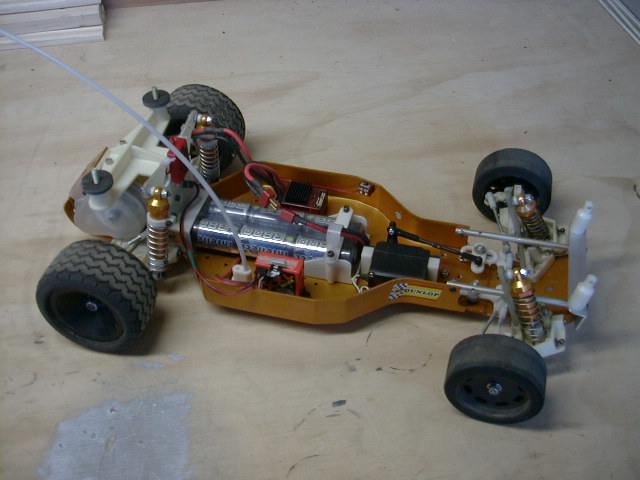

Re: gold pan on-road?
Front body mount from angle aluminum, rear mount is a CRP part (I think they may still be available on Ebay.) Rear tire is an old pair of proline strikers now discontinued, fronts are blue pan car premounts. I used to race "gearbox class" back in the day and no suspension mods were really necessary. Just drive it.
Looks cool.
Any idea for a rear rim/tire combo. if I want to take advantage of the crp "pan car" tire adapters?
