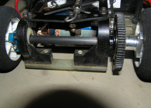

I decided to convert to the Associated 3-bolt rears for 2 cars since it's the only viable options I seem to have with sourcing parts.
1 will be with the older style silver 3 bolt hubs etc (RC12LC4?) and the other will be the newer blue RC12R5.1 hubs etc.
Hopefully both will work good, but if only 1 or the other will work that's ok too I can live with that :D
-Kevin
teman
Posts: 894
Joined: Sun May 01, 2011 5:57 pm
Location: Upstate NY
Been thanked: 6 times
Re: RC12 Wheels?
Post by teman »
Here's the combo I put together tonight with a new IRC axel and the the 3 bolt hubs I have. Seems to work ok at this point. I ordered the the matching blue right side and D-rings should be here any day.
