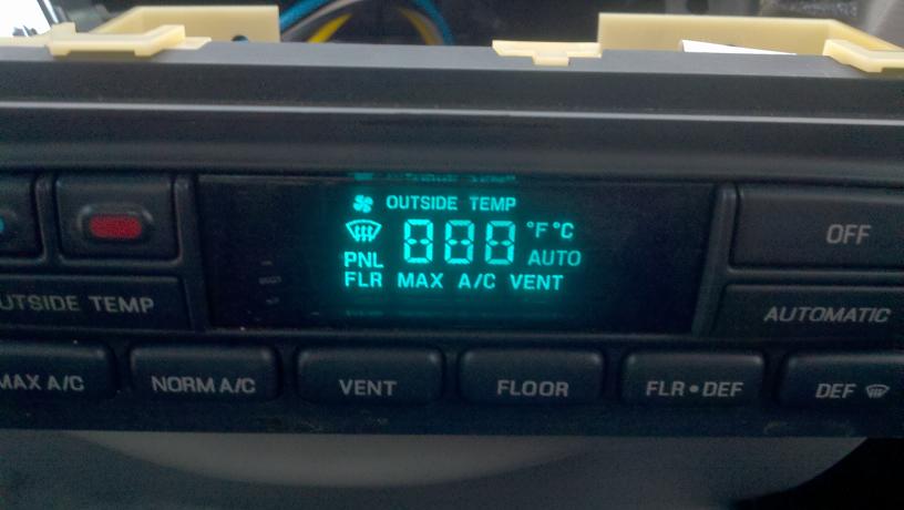

Just wondering if anyone here has some knowledge of automotive A/C, particularly Ford's EATC system. I got one that's giving me the run around.

well it all started as a simple accumulator replacement. recovered the system, replaced the necessary parts, vacuumed, leak checked and re-charged to spec. The compressor would not turn on even when jumping the low side switch. Did some simple test and found no 12v coming out of the EATC at the a/c compressor out pin. Ran the On-board diagnostics and got one code for ambient temp sensor open. inspected the wires and OHM checked. All looked good so I cleared the codes. A/C now worked perfectly... for about 45 min
I ran the on-board again and got 2 codes for blend door motor fault. Now this is where I'm stuck. I'm back to no 12v at a/c compressor out pin, The clutch won't engage when jumping the low side switch (naturally) And when the Proper pins are jumped for the Blend door motor it functions both ways, all related pins OHM as per Ford's trouble shooting steps. Now I'm not too familiar with EATC but shouldn't the clutch still engage even with a faulty blend door motor? And probably the most important part... the on-board diagnostics will not give me codes any more. All I get is the following screen:
I'm At a loss... Everything worked great until the accumulator needed to be replaced. The system never got below 1.5lbs of charge and nothing electrical was touched during service other than the low side switch.

4. When a module "jumps codes around" and then lights up the entire screen its usually bad.

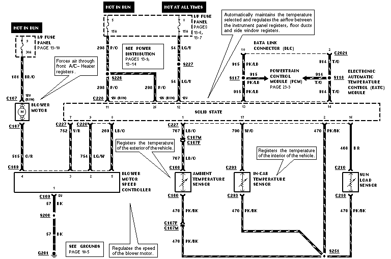

The EATC On-Board Diagnostic will detect concerns in the system control functions found during the On-Board Diagnostic and will display DTCs and intermittent DTCs for concerns occuring during system operation. The vehicle interior temperature should be between 16°C (60° F) and 27°C (80°F) when performing the On-Board Diagnostic. If the temperatures are not within the specified ranges, false in-car temperature sensor error codes will be displayed. Record all error codes displayed during the test.
Here is the diagram... Notice the shared ckts for the Sunload and the in car sensor... So the problem with the Ambient sensor dtc is either the sensor itself, the signal on CKT 767 Lightblue/orange tracer or the EATC.
