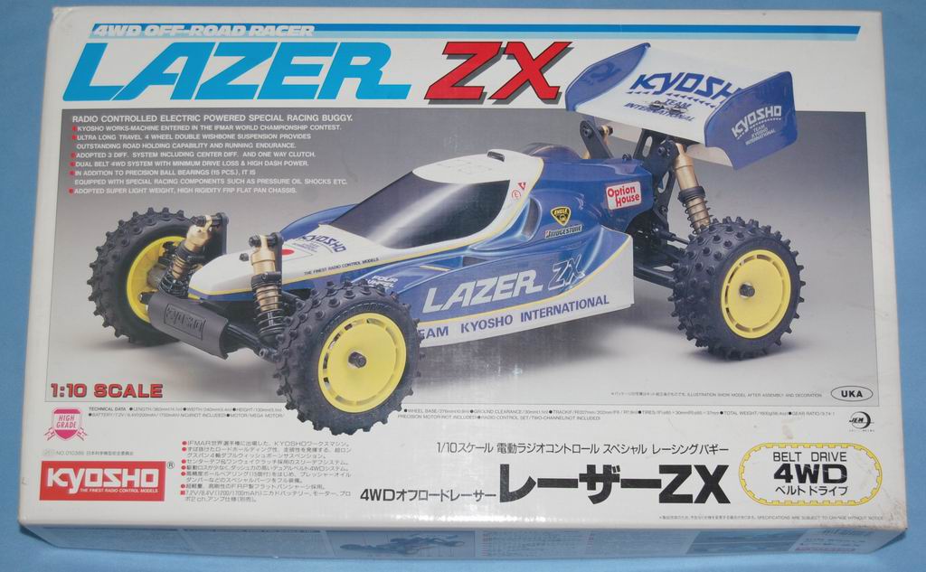

kyosho lazer zx late edition?
Anyone know kyosho ever released lazer zx late edition?the box as first edition lazer and just few differents as the first kit:tires and wheels & knuckle arms as the same as lazer zxr.

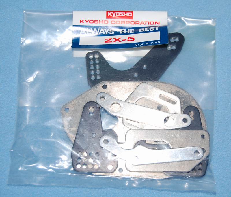

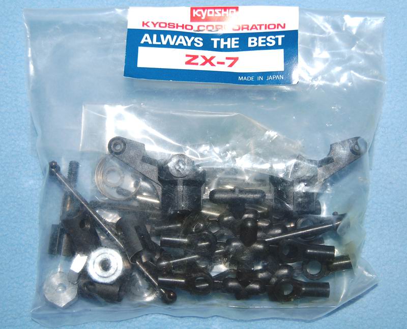

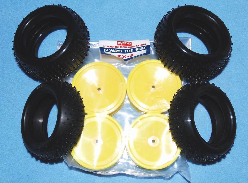

the lazer zx was releasted in 1989,I got the one NIB is first edition, ball diff center drive, gear diff, two pieces upper deck.
2.2 W-5026 W-5027 yellow wheels set packed as ZX-3
W-5631M & W-5641M tires the ZX-5 pack come with the steering plate look like the zxr ZX-7 pack knuckle arm OT-16 is plastics
but the kit come with the zxr wheel and tires.2.2 W-5026 W-5027 yellow wheels set packed as ZX-3

yes,lazer zx come with OT-121 front wheel rear wheel is MA-17, W-5031 front tire and OT-66 rear tire.
I think why my lazer with some zxr parts but no show in the parts list or manual,just later version and some parts change?

It appears that your car is a late edition, possible that the kit was originally opened to take spares from but luckily they replaced those items with the zxr items or as you said at the end of production of this car they upgraded certain things such as wheels and hubs (even though the hubs were a down grade) so its a bit special.

possible,but I checked all the label like zx-5 zx-7 their pack never been opened.but as say I still can change the original mint parts back it turn to the first kit.
