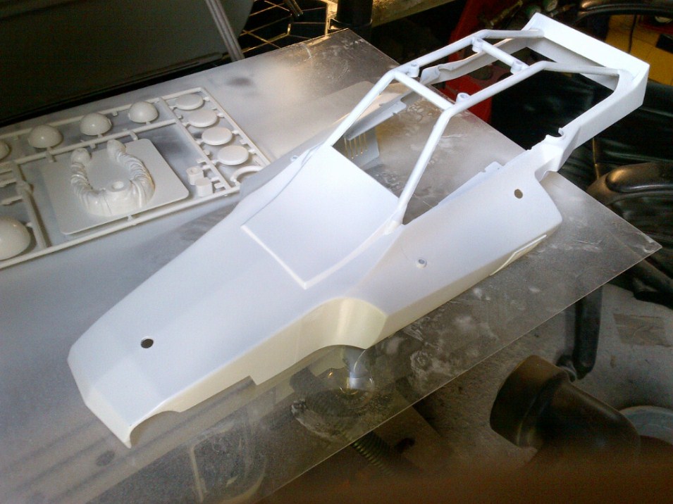

Re: Tamiya Super Champ Build
well tried painting the super champ body over here the last 4 days, total wreck lol.. the body was actually in perfect shape, after i removed decals and cleaned the heck out of it..
i used this spray paint, because on tamiyaclub a few places i read it was a good alternative to expensive tamiya paint...
http://www.rustoleum.com/cbgproduct.asp?pid=118
I used the same brand primer also, gave it 2 covered coats
then used black, first spray went on perfect.. didnt need sanding or anything, was like a dull glass. gave it a second coat and BAM total abortion. painted started peeling, i was crumpling in some areas, especially where the old decals where, i could actually read "belray" and "budweiser" through the paint, even though the decals were gone...
anyway, im going to home depot to pickup some grafiti remover, and to start from scratch... i always hated painting tamiya bodies lol.

Ahhh, I hate it when that happens! I think Easy-Off, brake fluid or Super Clean will strip that paint in short order.

Graphite remover will melt the body. Easy off in the yellow can is your best bet. Rustoleum good for lawn furniture bad for painting bodies.

I always have good luck with Castrol Super Clean to strip paint.

Thanks for tips Guys, i managed to strip paint over last week or so by soaking in purple power (thanks rick), did a good job of removed the black paint that just created a total fricken mess..
went to local train shop and got some tamiya thin primer, can of black, and some testor's gloss clear coat, the guys swear by it there over tamiya saying it works way better and isnt overpriced like tamiya lol. gonna give it a shot. gave the body a light sanding so primer will stick, a coat of primer, and after i let it sit for a day im going to try and spray a coat of black on it...
any tips for evening out the black? i tried some primer/black on a scrap tamiya shell, and little dimples formed in the black, like pinhead size, but enough to make it not look perfect, should i wet sand and clear coat to make perfect? or whats suggested method?

Sounds like fisheyes which would indicate that there was grease of something on the scrap surface.mikedealer wrote:i tried some primer/black on a scrap tamiya shell, and little dimples formed in the black, like pinhead size, but enough to make it not look perfect, should i wet sand and clear coat to make perfect? or whats suggested method?

possible maybe from handling the peice, anything i should use to wipe the primered surface down first?
