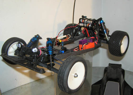

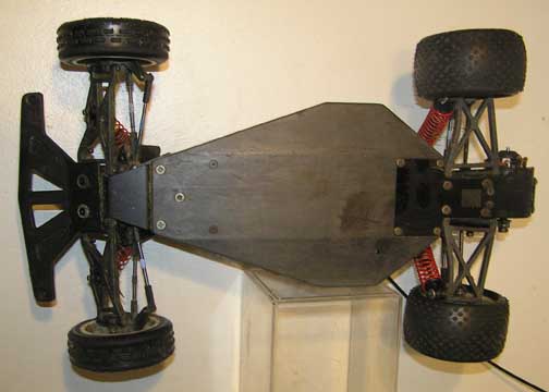

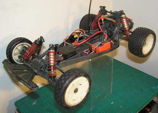

I Picked this a short time ago from a local for a "newer" runner, I basically was just curious about the newer car set up and stealth. I added the Novak C2 pretty quick, a RPM bumper and a random motor I have to get it rolling. The aluminum bottom plates are/were trashed and replaced them with black plates for now. The tires/rims are beat-up so that's on the list. A NEW body is needed, the body pictured was originally yellow. I overspayed it and did a B3 theme in vinyl for the time being. More to come on this one also, I was thinking team resto and my first brushless set-up.

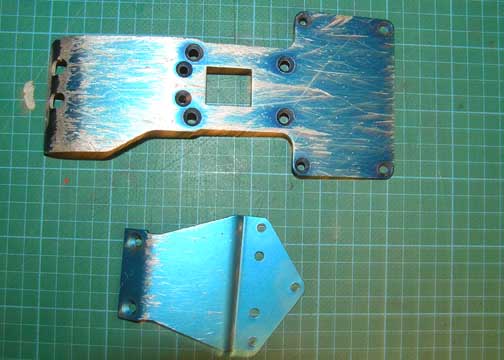

I finally got back to this project, just about everything but the chassis and transmission has been restored with some splurges on blue shock bodies/caps etc. I wish I could find nice blue anno'd chassis plates, but a black set will suffice. The current motor I'm using is the Speed Gems 15t double and the buggy runs great! New wheels and tires were sourced - it took a while for the actual B2-3 rims, but I have them now

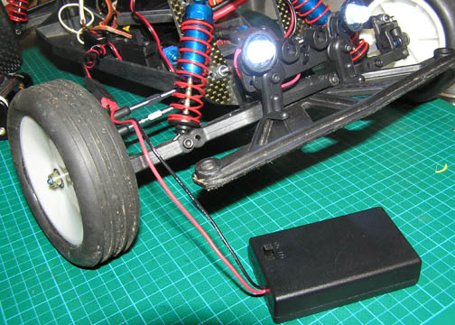

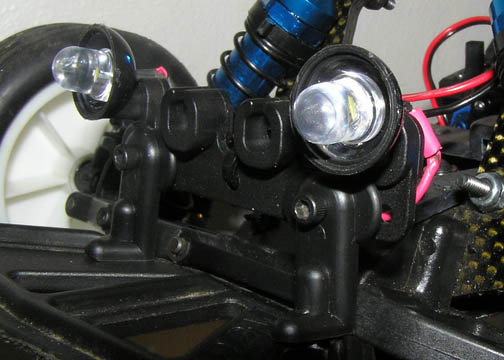

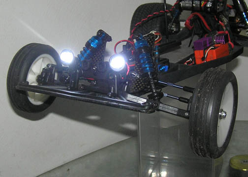

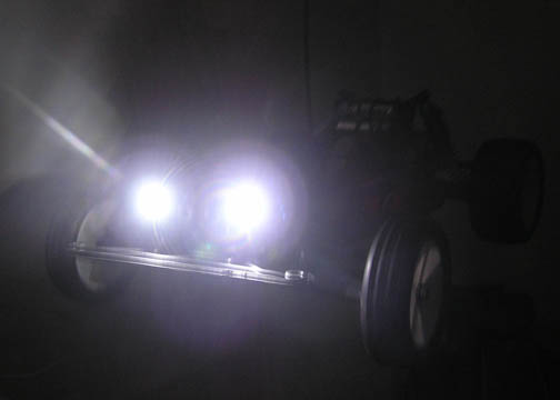

The most recent part of the project was lighting

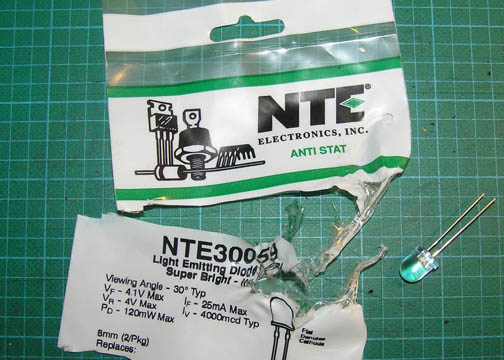

I started with the RPM light bar 80982 for the LED holders and used Asso truck mounts 7323 to mount it to the bumper. Instead of the small LEDs, I used NTE 8mm LEDs 30059)wired in series
To power these suckers I needed 4 AA's - the standard Futaba receiver pack and switch was perfect for this. I think it came out pretty good

the blue show up off an on on ebay. Sometimes expensive and sometimes never to get a bid. Last set of 3 pieces I seen go for about $45 and the pieces after that never got a bid at $5 a piece. Guy had the two pieces you have pictured. I had them on my watch list and wished I would've put a bid on them just to watch them but didn't that timeteman wrote: I wish I could find nice blue anno'd chassis plates, but a black set will suffice.

Interesting, I thought the blue plates were Asso Anno'd

Here's a couple more shots, I would've liked to use the lenses and grilles in the RPM kit, but it just doesn't work with this size LED
I find it odd that I didn't have to use any kind of resistor on the wiring, it just works perfectly as is
I see I need to re-glue the right side again though looking at the photos
The body fits OK, it's just a little tough to get to front the body clip. With the body mounted, the wiring from the LEDs to the switch slips OK outside to inside - I think it's better this way as opposed to wiring attached to the body.

Yeah. The blue parts are Associated anodized Factory Team parts if that was what you were thinking. Looking back at one of mine I was after the 2 chassis pieces like you have pictured but found out tonight I have a local guy that has alot of anodizing done that said he could add some of my stuff to his 1:1 bike parts on his next job. Gonna take a shot at seeing how close the blue is that he can get done is to the factory team stuff.
I like how you mounted the lights. The upclose stuff helped me get a better idea of what you did to incorporate actual associated parts into it
. Did that extra package of batterys do anything to the handling or haven't you gotten that far yet?

A bit less steering and more traction. It does add alot of weight back there which is going to force me to use stiffer springs - I was hoping to add the blue stiffer set.klavy69 wrote:... Did that extra package of batterys do anything to the handling or haven't you gotten that far yet?
I think the same set up would work with AAA's for a smaller footprint. I'm going to try that next, all I need is the battery holder and solder the Futaba connector on it.

Seems to work fine with 3 AAAs (4.5v) Not as bright as the 4AAs (6v) but much smaller footprint. I grabbed a couple yellow LEDs for the middle, I'll see how that goes *fingers crossed*

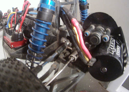

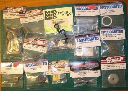

the old trans went into the rc10bt3 for some runs so I built an new trans and bought new shiney MIP CVD's for this (some of the parts aren't in the photo sorry)... came out great just in time for some inexpensive BL stuff ... a Reedy 3300/Trackstar 60a
It's nothing to brag about, but it will be fun to experiment with for a while then pass on to the sons b3 when he can drive better

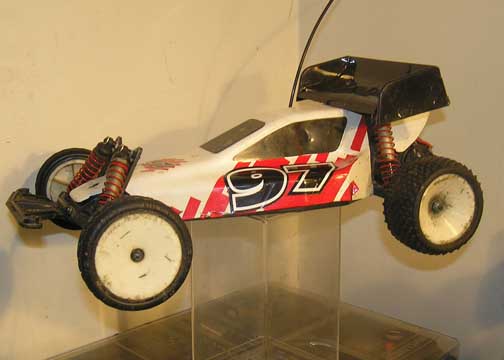

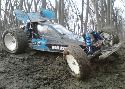

Here's a photo from earlier this week at my test track with the new body when there wasn't snow on the ground
