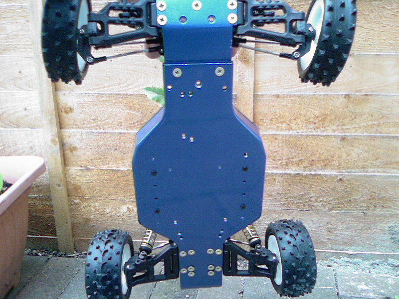

ok, i'm going for it. got some brake fluid and am going to start soaking it now :shock: .
heres a before shot.

Wow! What are those tires? sorry it a bit off topic.... What weels do you use also?
Volumiza
Posts: 301
Joined: Wed Aug 01, 2007 9:38 am
Location: Somewhere in the middle, UK.
Post by Volumiza »
the rears are trinity triads (that are too big for the rims actually :( ) and the fronts are trinitys also. the wheels are race masters for now.
