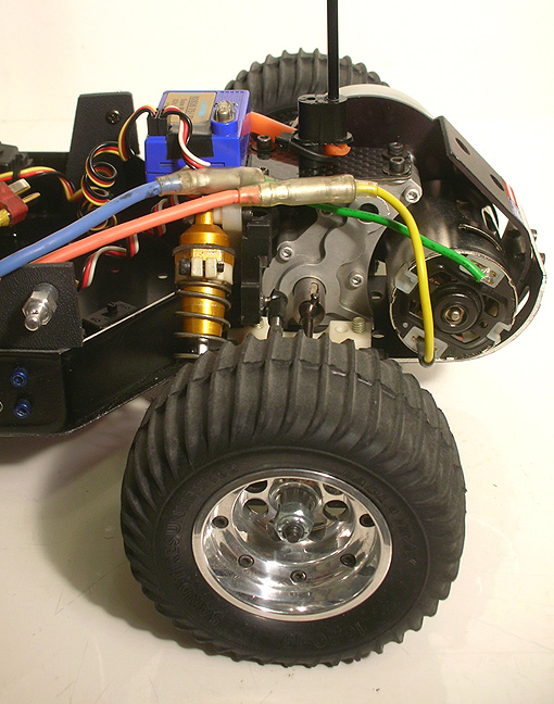

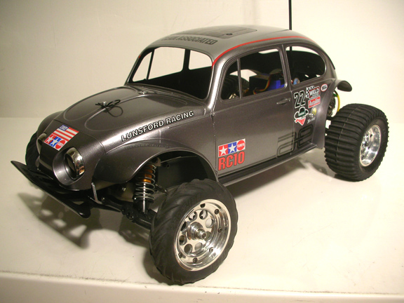

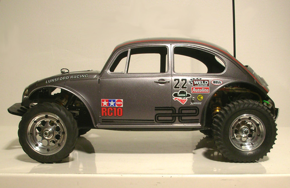

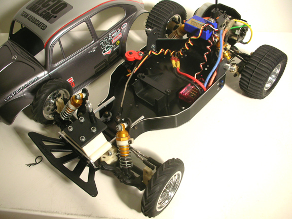

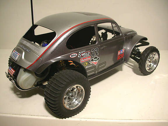

I finally completed my RC10 Sand Scorcher project. I started by taking a NIB black chassis and cutting 1 inch off the front. The front body mount is a chopped CRP RC10 truck body mount with a chopped body mount mounted to a Tamiya F201 body mount. It's got Losi aluminum bell cranks, Lunsford titanium turnbuckles, RPM front arms, Andy's rear arms and Technacraft wheels. The rear tires are Grasshopper tires, the fronts are vintage Proline. I used an oval lowering kit for the rear, because I didn't really want a big shock tower showing through the rear windows of the body. The tranny is an original Stealth, but it's got an aluminum case, the only one I've ever seen. It's dimensions are slightly different than the stock plastic case, in that the holes on the top are slightly more forward. So, I had to cut a custom tranny brace out of carbon fiber. Since there was no shock tower in the way, I extended the tranny brace forward to include a reciever mount. With an inch removed from the front of the chassis, I couldn't mount a servo up there. I ended up getting a micro servo, but even it would not fit in the smaller space. So, I mounted mid-way back on the wall of the chassis and took an old Tamiya link (I think from a Clodbuster) and bent it slightly to clear the battery cup. Believe it or not, this is a very effective steering set up, this car steers tighter than anything I've ever driven, including four wheel steering vehicles. The side body mounts are custom cut Kydex with Tamiya F201 body mounts scewed in to the side of the chassis.
I think that's pretty much it. Oh, the body is from a Blitzer Beetle kit. I'm very happy with the car and plan to run it. 8)

Should those rear tires be switched? Looks like they are made to "dig in" in the opposite direction, or is it "all in my head"?

MelvinsArmy wrote: With an inch removed from the front of the chassis, I couldn't mount a servo up there. I ended up getting a micro servo, but even it would not fit in the smaller space. So, I mounted mid-way back on the wall of the chassis and took an old Tamiya link (I think from a Clodbuster) and bent it slightly to clear the battery cup. Believe it or not, this is a very effective steering set up, this car steers tighter than anything I've ever driven, including four wheel steering vehicles.
The sharp steering is the result of the shorter wheelbase, I don't think the servo placement has anything to do with it.

Daryl, I was seriously thinking about a trailing arm conversion. I had been working on this one on and off for about a year, and I finally just sat down one night and finished it. Do you sell the aluminum trailing arms without the full chassis kit?
MONSTER, yeah I was confused at first too. But, the steeper angle is actually facing forward, it's just that the side ridges point backwards and makes it look a little strange. They will get the best dig in this direction.
Snake, yeah I knew the shorter wheelbase would make it steer on a dime. But, I figured a steering rod that long and bent would create some noticable slop. But, it's tight as a drum. I actually have a driver that I'm planning to put in the car, I was just so excited to finally have it done that I posted it up before the driver was done. Once he's done, that will give me an excuse to take some outdoor shots. And of course action shots. :twisted:
