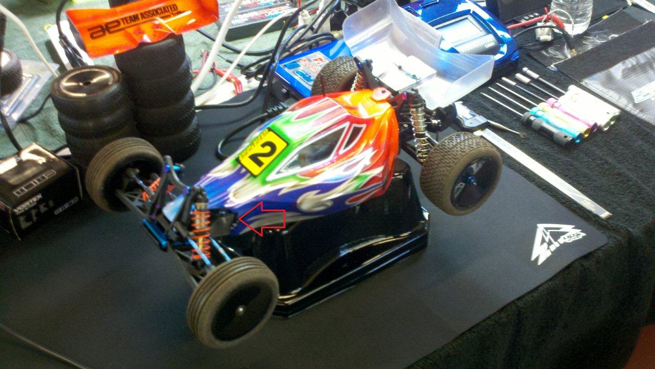

Re: B4.1 carbon or composite chassis
Here’s an old punnisher body that I trimmed to fit a +8 chassis. You just need to remove a little material behind the front wheel and it will fit pretty well.
I’m by no means a “hardcore” or “highly skilled” racer (only been at it for about a year), but not only did the longer chassis make the old car competitive against the newer buggies it helped me go from the “B main” to an “A main” regular at the local club track. If you’re going to bash there is nothing wrong with the short car but if you plan on setting the car down on a race track the longer car will jump better, be smoother over the rough stuff and overall just be less twitchy. My $.02.
