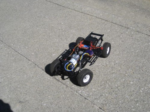

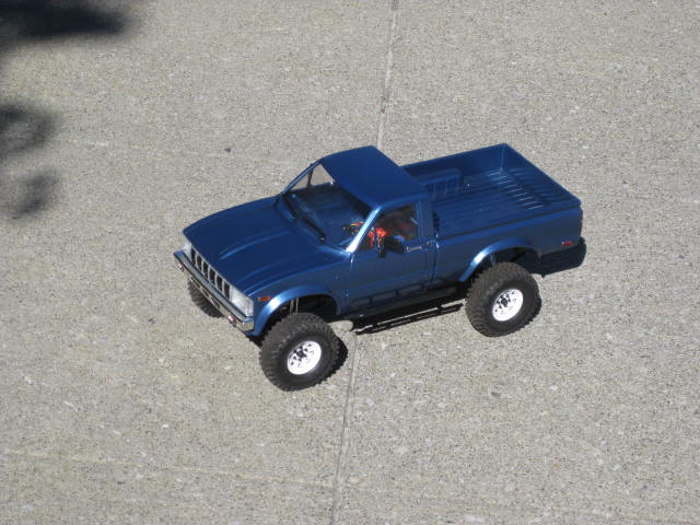

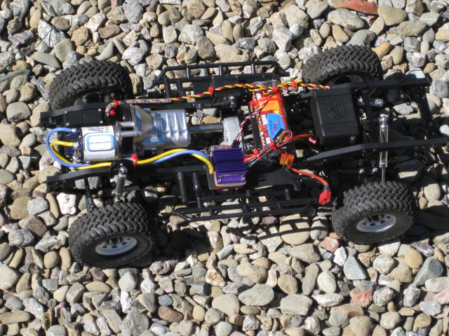

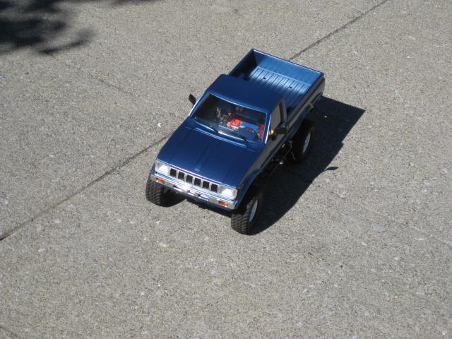

All is well , thing is fun,fun,fun. Had to get u bolts for the leafs, striped a screw, well that how I justified them. Was not to happy with the esc's that I had on hand so I picked up a Novak eiger still in the box. I will try to get some pic up this weekend
Thank for asking

Re: T f 2 so sad
Post by steve »
steve
Posts: 85
Joined: Tue May 24, 2011 11:56 am
Location: san mateo ca
Re: T f 2 so sad
Post by steve »
Just an FYI for you all ! The junfac drive shafts that people are saying work on the tf2 are the 95-130. For the ax10 , you will need to move the axels out and lengthen the wheel base. I should have got the scx10 set that has the 82- 117 and 95-130. Do not try and cut 3/16 off the female side, that will take the D shape out and leave a round tube
