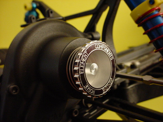

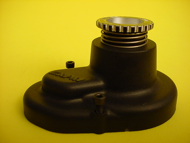

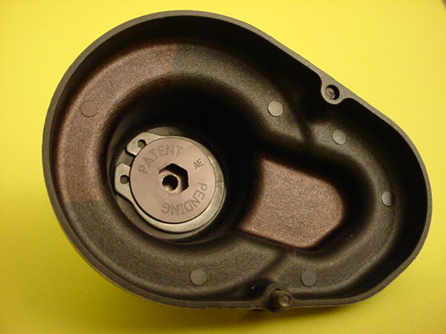

Hello Gents: I have decided to re-make some of a pretty popular item from the past- It was called a SCAB (Slipper Clutch Adjustment Button.) The pics should 'splain what it is & how it works, and I've done a bunch of checking of parts #'s, etc. but here is my question for you chaps that live & breathe this stuff. RPM gear covers say they fit the T4, T4.1, SC10, buggies, etc. I use these along with a precisely cut alloy unit to push in, adjust, & then it pops out of engagement from the top shaft nut. Since the covers fit all the different vehicles, and top shafts are the same, it should be a go: I do notice 2 different motor plate part #'s, 1770 & 9600. Are the 1770's just milled & blue but otherwise identical to the 9600? I hope I'm asking this clearly, I'd just hate to put out a bunch of these & THEN find out some snigglin' difference is causing probs- As long as depths are the same or damn close between the motor plate/top shaft length I'm good- The gear/ball diff housing thing should make no difference as long as the top shaft sticks out the same distance within a few mm. So, now that I've confused even myself, any opinions Mates? I count on your expertise when doing stuff like this, so Thank You for any insight! Cheers, Chris REC

I am pretty sure you're correct in your assumption between the 1770 and 9600 motor plates. Changed out quite of the black ones to the blue milled plates without any issues.
