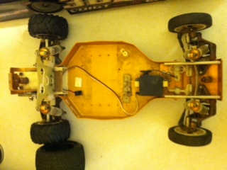

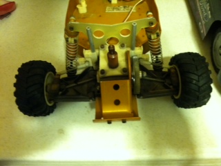

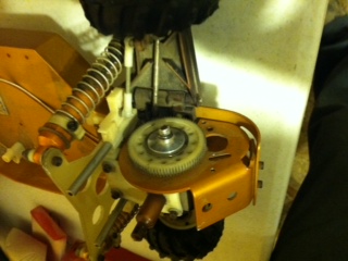

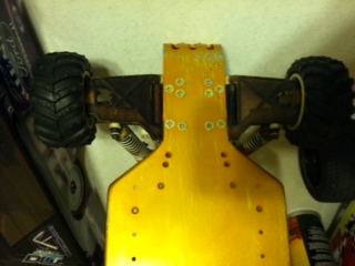

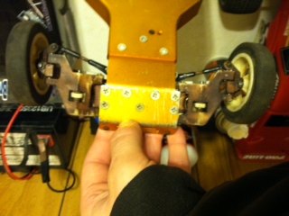

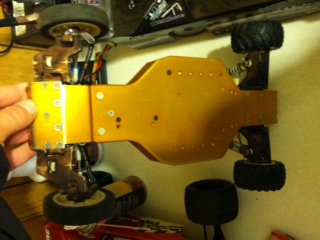

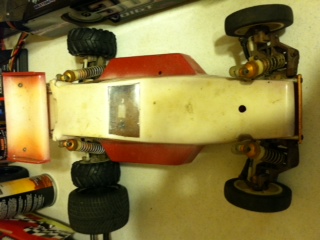

Well i finally found a gold pan buggy to make a runner it a pretty clean a stamp car... 6 gear trans seems ok all the suspension parts have a redish maroon tint to em... Is there any way to make em white? I have heard peroxide? Will the 6 gear hold up to brushless and lipo? Is there any way to make a lipo fit in the stock battery trays? It has the sideways mounted tray and a hard case will not fit... And i havnt tried on the gold pan but i mnow a hard ase and a soft case will not fit in the hole in the bulkhead on my losi jrx to mount the batt long ways in the chassis.... I have an aluminum steering bellcrank set im going to use and plan on going with all rpm ballcups and lunsford turnbuckles throughout the car and a new set of mip cvd's for the back.... Any other bases i need to touch to make he a reliable runner? Thanks dj

some pics

Dirtcar75 wrote:Well i finally found a gold pan buggy to make a runner it a pretty clean a stamp car... 6 gear trans seems ok all the suspension parts have a redish maroon tint to em... Is there any way to make em white? I have heard peroxide? Will the 6 gear hold up to brushless and lipo? Is there any way to make a lipo fit in the stock battery trays? It has the sideways mounted tray and a hard case will not fit... And i havnt tried on the gold pan but i mnow a hard ase and a soft case will not fit in the hole in the bulkhead on my losi jrx to mount the batt long ways in the chassis.... I have an aluminum steering bellcrank set im going to use and plan on going with all rpm ballcups and lunsford turnbuckles throughout the car and a new set of mip cvd's for the back.... Any other bases i need to touch to make he a reliable runner? Thanks dj

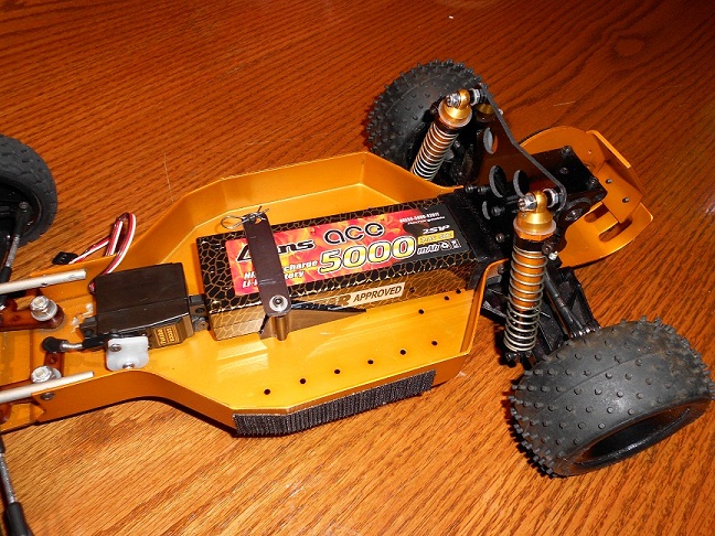

I'm building a 6-gear car for the local track, and upgrading all the electronics for racing. I got some 2S lipos in a hard case, and they barely fit longways. I had to cut the backside of a battery tray, and they'll clear the servo mount by about 1/4". It's REAL tight going in the rear bulkhead, but it sits secure.
As far as any goodies to make it reliable, I think you've covered all the bases. Look for spare parts to keep in your toolbox. Check RJ Speed for a 48pitch spur gear. They drop right in.

Here's what I'm talking about by cutting the battery cup for hard case Lipos:
