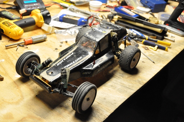

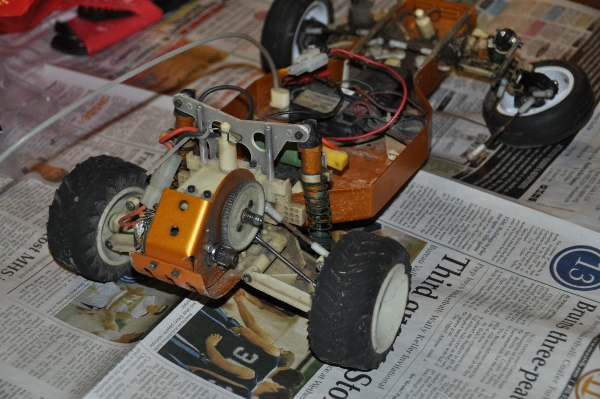

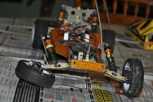

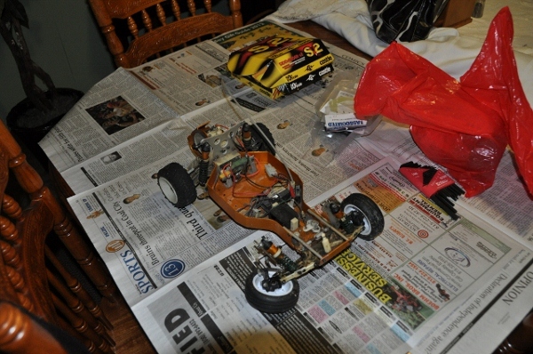

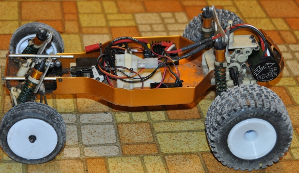

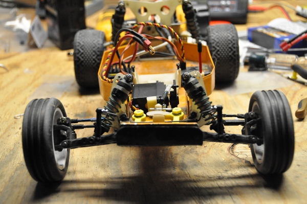

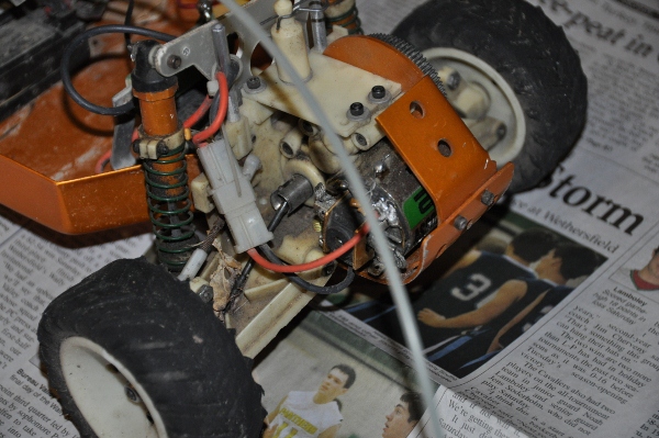

Here are some pictures before the upgrade. The upgrade is complete, pics to come.

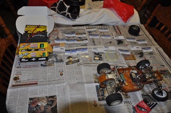

And one more with most of the parts.

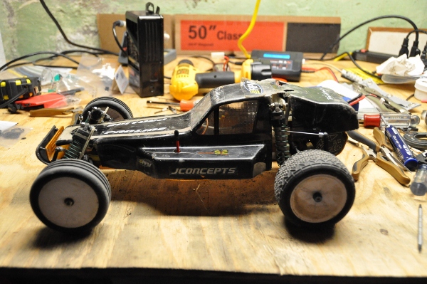

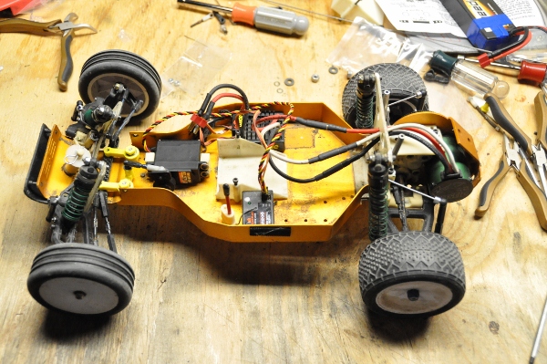

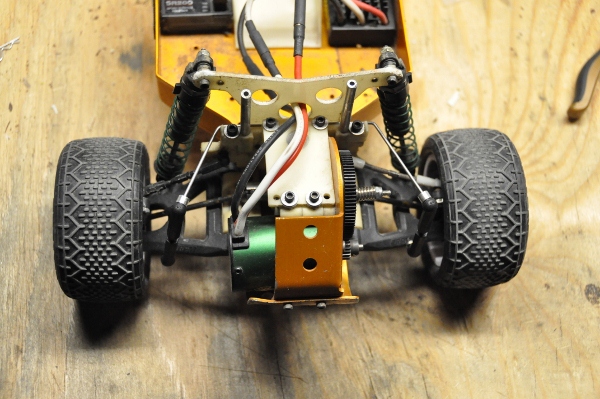

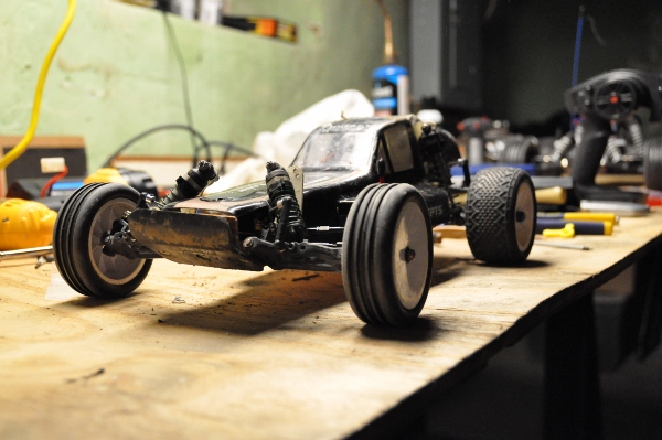

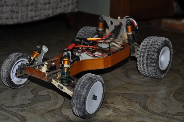

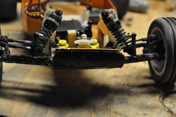

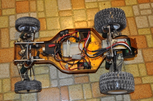

Here are the currently updated pics. The wires are a mess and the body isn't painted, so I didn't show it. Had to unfortunately replace my old AM radio this weekend. Bought a cheap Spektrum that does the trick.

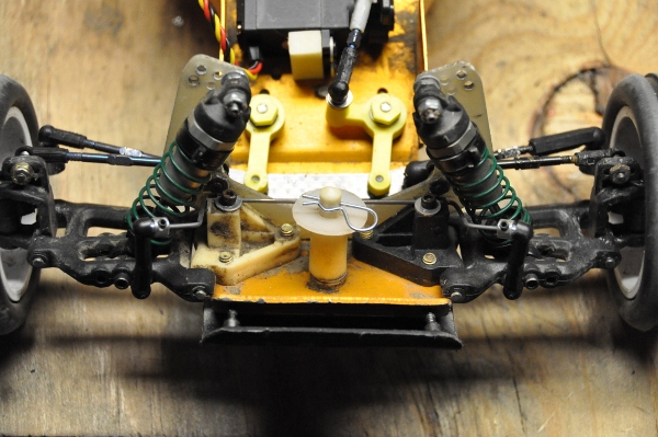

I got most of my upgrades finished at this point. Custom made sway bars made out of music wire. .55 in the front and .62 in the rear. I just wish it was a easier to get this car to sit lower without compressing the shocks most of the way. It already has a good deal of abuse on it from testing, bashing and the track. Drilled holes in the rpm arms on the rear to put the ball studs in for the rear sway bar. Let me know if you guys have any suggestions.
