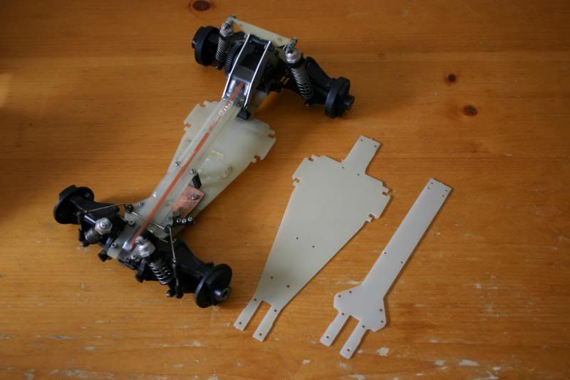

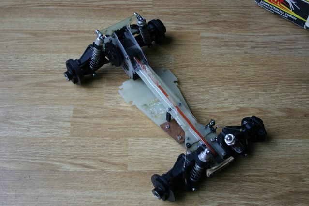

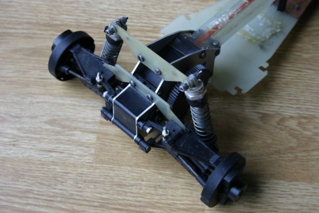

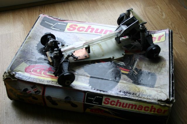

I know i'm a sucker for buying cars with problems, but this one has a lot of them. On the good side it has MMS diffs front and rear, plus the layshaft. It's also got the rear suspention mod kit fitted to widen it (the paperwork for it is in the box), but the front is still narrow. I'm not sure if i'll return it to the narrow spec yet.
As you can see from the pics the bottom chassis has been snapped in two and repaired, functionally not too badly, but it looks terrible. The top chassis is broken at the front too as well as having a missing bumper and wheels. I'm probably going to be hunting for parts for a while to replace those.

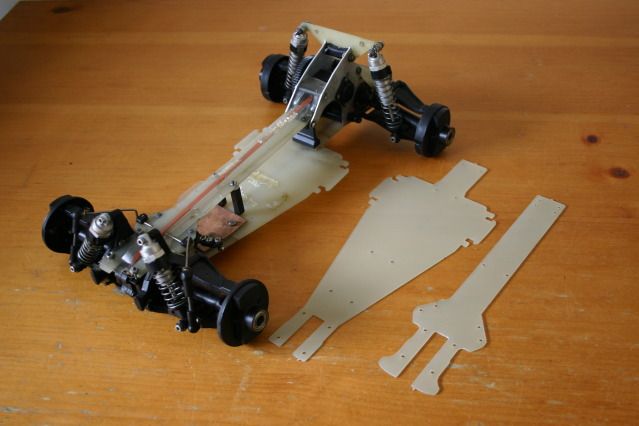

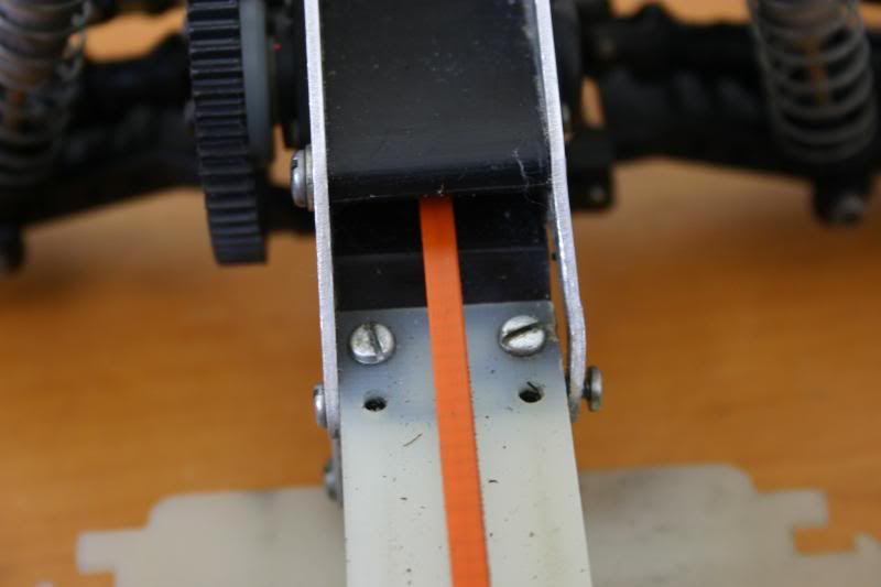

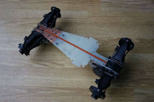

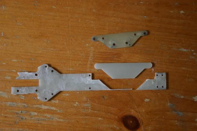

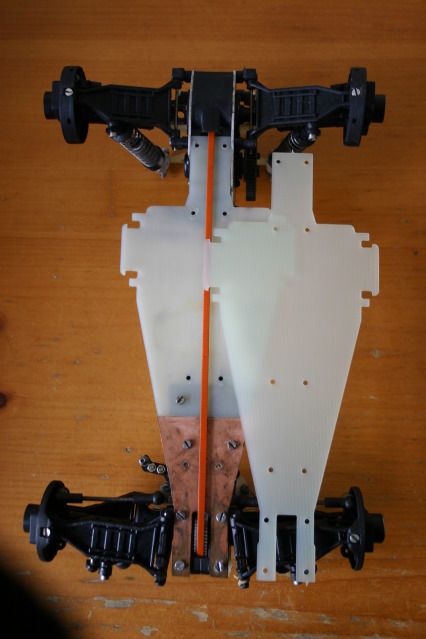

Well i've been really lazy recently with anything to do with my collection, but today i dug this out to try and make some progress. I bought a new chassis a while ago, but it's a bit of an oddity. The seller (am old racer) told me it was an XL chassis, however it's a bit shorter than XL/XLS, but longer than SWB. It looks like a Schumacher chassis for sure, and it still has the flashing from where it was cut, just like the originals. My XL bottom chassis is 275mm total length, this chassis is 265mm. The top plate is similarly shorter. Anyone ever heard of a mid wheel base? :lol:

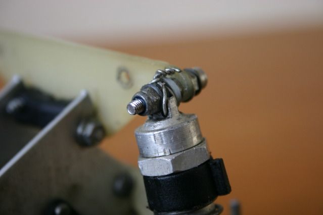

I also had a good look over the buggy and noticed this lovely mod to the rear shock... I think i might need a new shock cap :?
Paul.

Wierd! I wonder if the 'repair' was is actually a modification to make the SWB chassis longer? But then, what about the belt & top deck??
Or perhaps its something simple like that the XL wasn't quite as long as an XLS?

I'm not 100% sure myself Dan, the topdeck on the repaired one matches the lower chassis length, so it's not been extended.
As far as i'm aware the XL and XLS chassis were identical in length, if they were not i suppose there would have been another length of bodyshell.
The bodyshell is the main reason i have not just used this chassis, i'd have to modify the body length to suit.

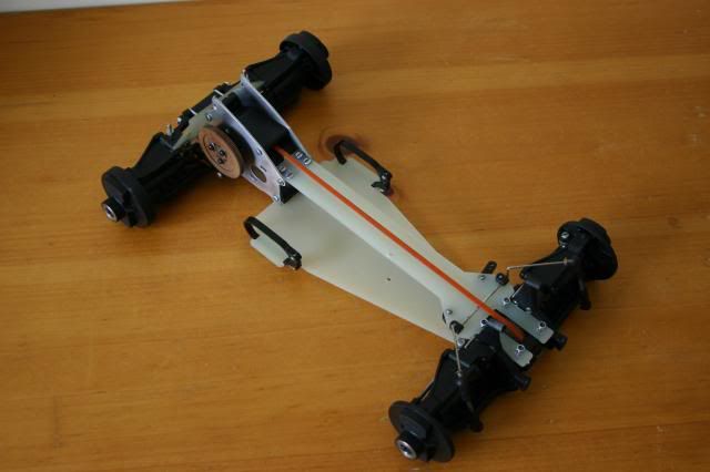

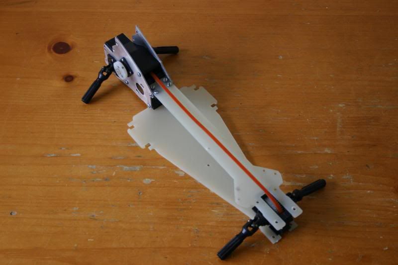

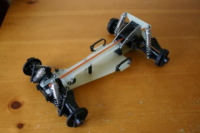

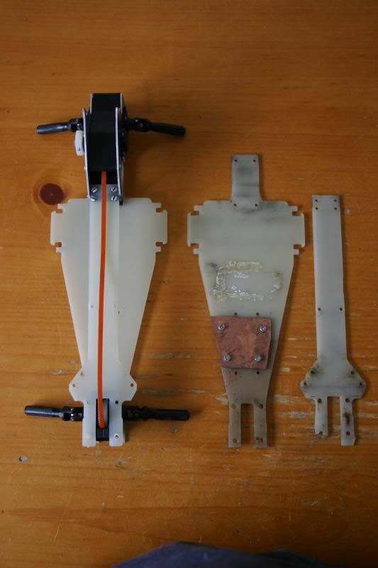

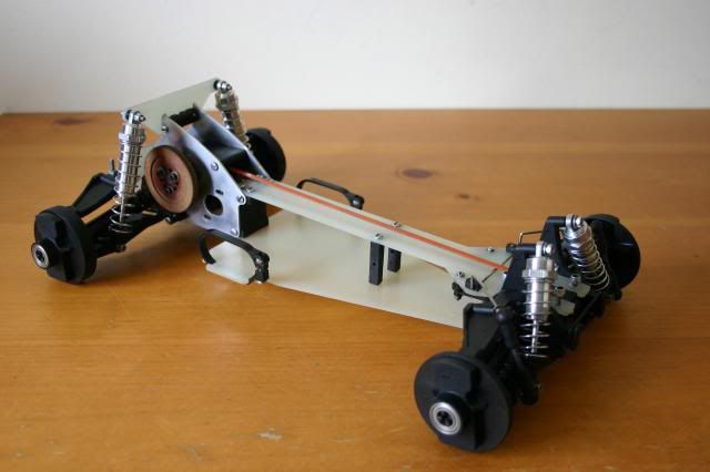

Well i managed to get myself a lightly used chassis set, this time the same length as the original.

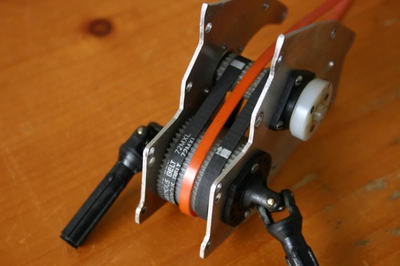

While i was stripping the car i noticed the right hand gearbox plate was bent (how??)
I hammered it flat with a rubber mallet and rebuilt the gearbox. The MMS diff and layshaft were in good condition and just needed a quick clean. The diff seems to be the drum type without the pulley guides.
This chassis set looks so much better :)
I need to get working on the shocks next as they're in pretty rough condition. I also need to see if a can clean up the rear shock tower.
Paul.

Thanks Dan. I've been working on the buggy a little more today.

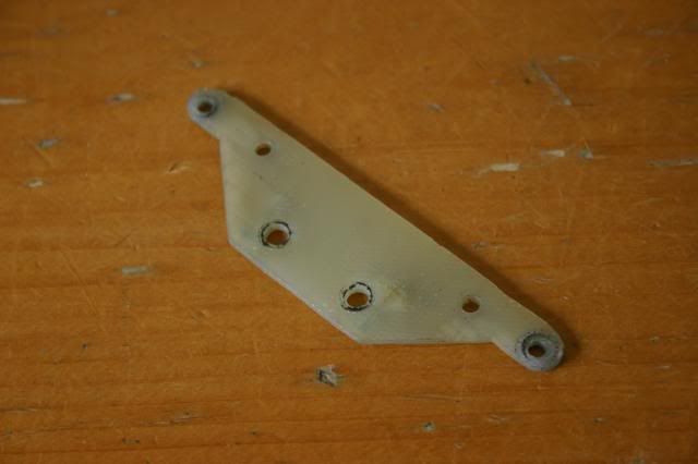

As you can see from this pic of the rear shock mount, i think it might not be salvagable. It's got a stress crack, extra holes and is very different in colour from the chassis now.
I think i have a good idea to replace it though. The top deck that came with the buggy originally is broken at the front, but the rest of it is in decent shape and should clean up well. I think i'll use this shock mount as a template and cut a new one from the top deck material :)
Paul.

I attacked the old broken top deck with my dremel yeaterday...
My hand cutting is getting slightly better, and the colour match to the chassis is perfect :)
I polished up the shocks and attached the new shock tower. I had to replace one of the shock caps on the rear, but the rest of the shock parts polished up a treat.
