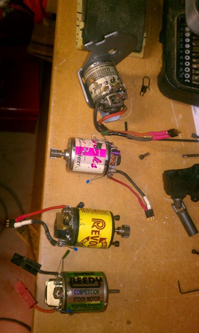

Thanks for the welcome. Anybody ever try something like JBWeld to fill in the groove or is that just a recipe for disaster? All the other gears look fine. Bad gear aside, is this transmission strong enough for 7 cells? Currently it has a Trinity Speed works motor. The motor has a silver can with a gray and white label. Not sure if this motor can even handle 7 cells. Have a few other motors to pick from.

Here's a shot of the motor if that helps determine 6 or 7 cells. The others are a Speedworks Joel Magic Johnson, Team Losi Revolution Racing and two AE Reedy green label motors. Should I just stick with the Trinity Speed works that is currently mounted to the JRX motor plate?

The transmission should be able to handle 7 cell NiMh. I've run more powerful modern combinations through mine without a problem. Does this car have a slipper clutch? I couldn't see the transmission in your original picture.
The motors should also be fine. Since the motors are all used, you might want to check the condition of the brushes, armature, bearings, etc before you start running them.
