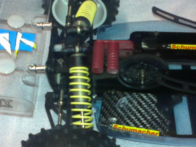

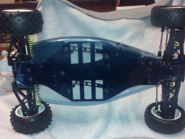

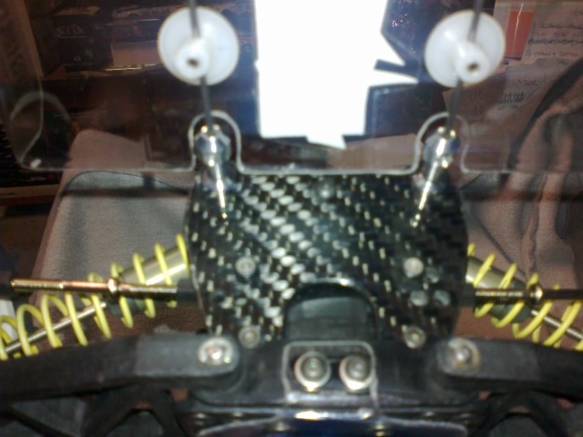

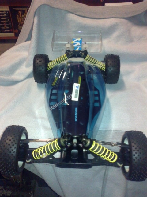

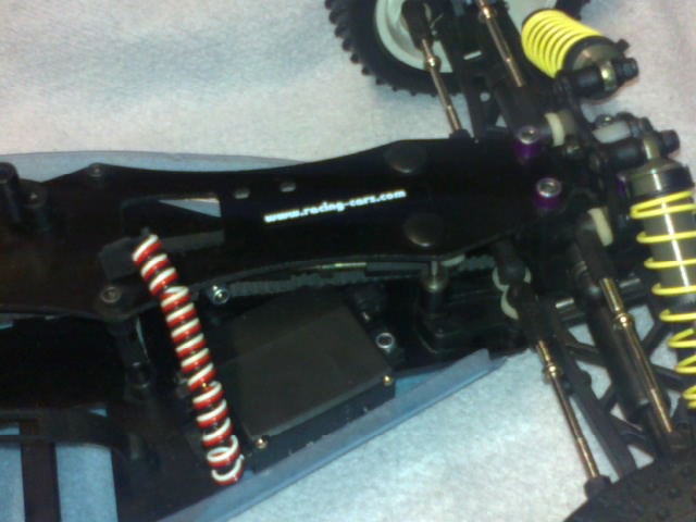

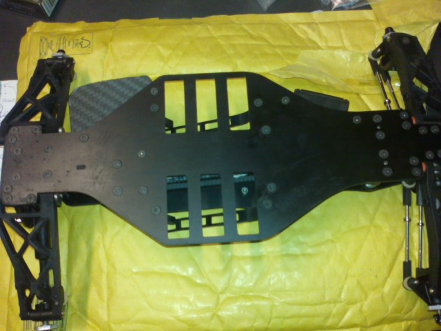

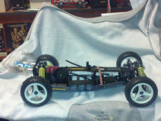

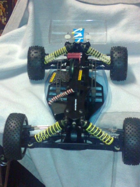

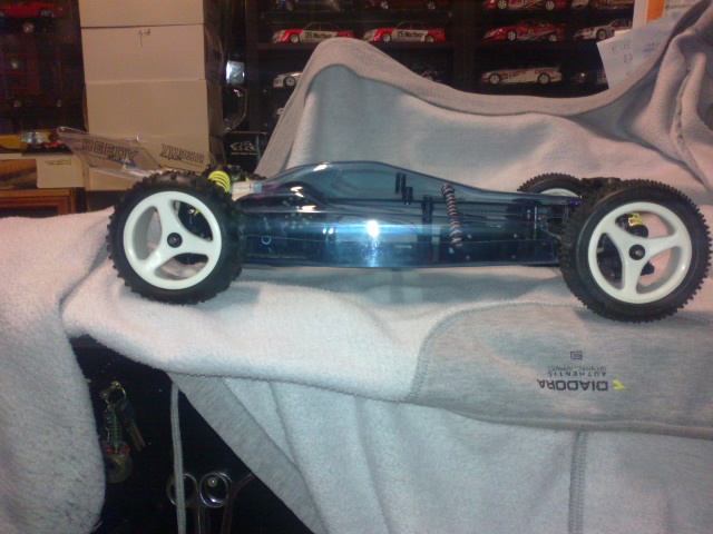

This is the cat 200ec when i first got it.. Had to do new shock shafts,shock bottoms an seals,shock mounts an spring cups,most of the suspension pins,new body an undertray.The rear wing mount piece had both corners broken off an the actual wing mounts were broken so i made a new wing camber link mount out of some carbon sheet an used some A+L wing mounts an i made it the same width as my other wing mount dimensions like rc10 so i can share common wings..The mount i made lowered the wing an the new body had some imperfections along the mold line so to have it cover the rear shocks would have shown these up so i slammed it down an i think it looks killa. I also made an esc mount out of carbon all screws were replaced with hex screws an all nuts replaced with black nylocs..Turnbuckles are new but they are cheapo ones i thought looked like the original one but they are useless. The tyres are old losi ones that were in the box on some well used wheels so i did the acetone thing an put em on new wheels with black serated wheel nuts.Not sure if i will paint it up an use it yet.Sorry about not so good pics
How i got it
How i got it
How i got it
stickboy007
Posts: 745
Joined: Sun Sep 16, 2012 6:13 pm
Location: Mahopac, NY
Been thanked: 55 times
Re: CAT 2000ec now with pics
Post by stickboy007 »
Those 3-spoke wheels are killer.

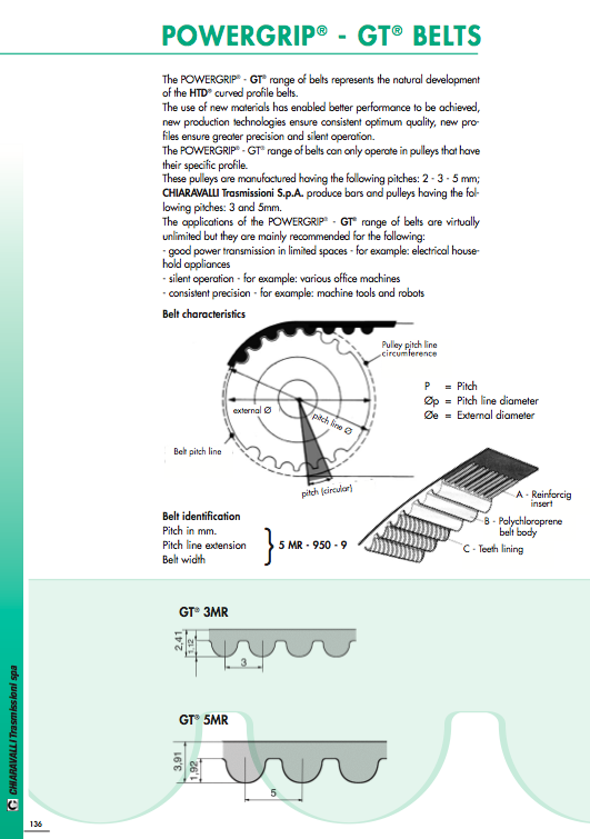

The writing on my front (U1491) and rear (U1492) belts is as follows:
U1491: Gates PowerGrip GT 3MR510 KEVLAR
U1492: Gates PowerGrip GT 3MR195 Aramid
Based on the catalog screenshots below, both the Gates 3MR and Bando S3M have 3mm tooth spacing. However, the Gates PowerGrip GT tooth profile and measurements are slightly different than the Bando "3M" style belts. Have you experienced abnormal wear on the pulleys or skipping with the alternative non-Gates belts?
Gates PowerGrip GT catalog screenshot
Bando catalog screenshot
