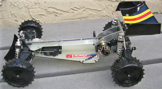

Re: Differences ?
well, here's my CATs.
not sure if the car on the right is an XLS or Procat
I think PRO...
the car second from left has some new part on already, and I have a brand new chassis and some plastic parts to go on with one of the new bodies to do a Masami replica one day...
I think PRO...

Re: Differences ?
The two outer ones look to be Procat as the XL body wouldn't fit, the rest are XL I think, but I could be wrong and may be some XLS. Here some links to manuals which may be of help.

Re: Differences ?
The XL and XLS have a few differences, but they both share the same stick pack chassis. The saddle pack chassis was an option part that fit both cars.
XL has solid front pulley (no diff) and one way roller driveshafts
XLS has front ball diff as well as one way driveshafts
XL rear suspension arm mounts bolt directly to the gearbox, the XLS has extra spacers to increase overall width.
XL front suspension lower arm pivot pin goes through the suspension mount, XLS front suspension again has spacers to move it out.
Because the suspension arms have been moved out the XLS has a longer steering centre link and rear upper suspension mount brace to match.
The Procat is easy to spot, it has the rear suspension from the Topcat/Cougar, with a normal adjustable turnbuckle link instead of the moulded upper arm.
Looking at the picture the cars at the top are most likely XL, the shape of the front of the upper decks is an early style, the lower cars with the narrower front piece is the XLS version, but apart from the front section it is identical to the XL one.
The fibreglass saddle pack chassis is a Procat chassis mounted on an XLS, and the 4 cell slots should be on the spur gear side of the car. The chassis is too wide to fit the XL/XLS shell. The XL/XLS saddle pack conversion was narrower and the cells sit in the chassis at an angle to lift them up at the outside edge.
