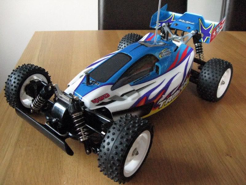

My son's Rising Storm , with alloy towers..
Wheels now replaced with 2.2 disc wheels and mini pin tyres, ground clearance improves about 1/4"

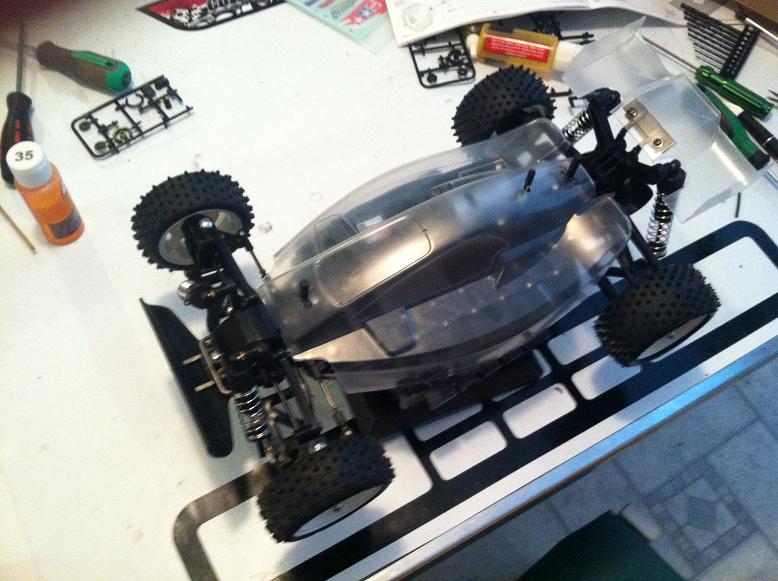

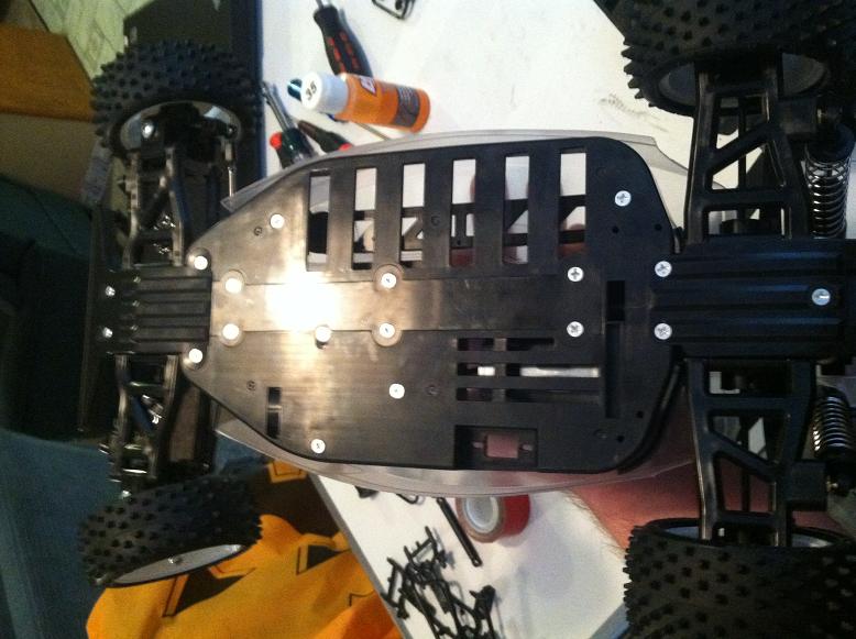

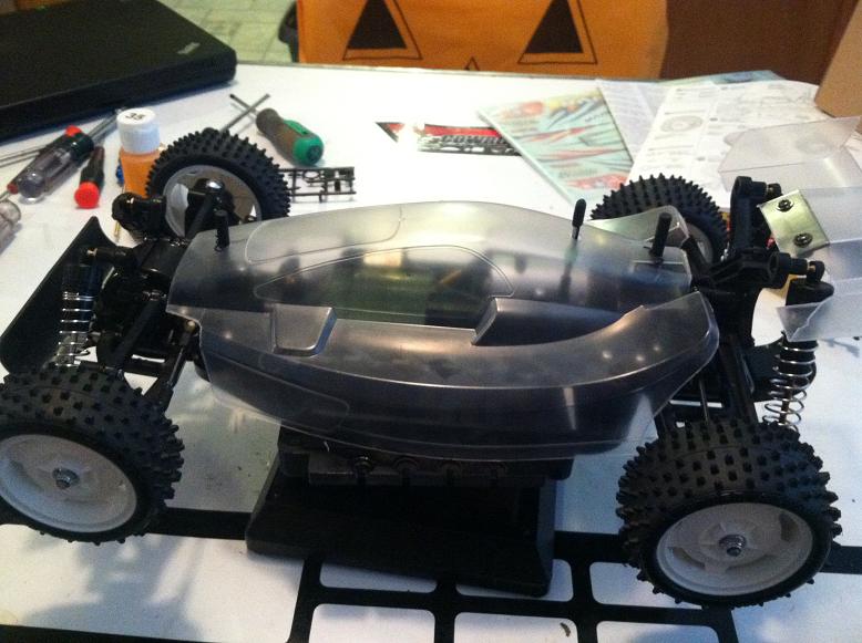

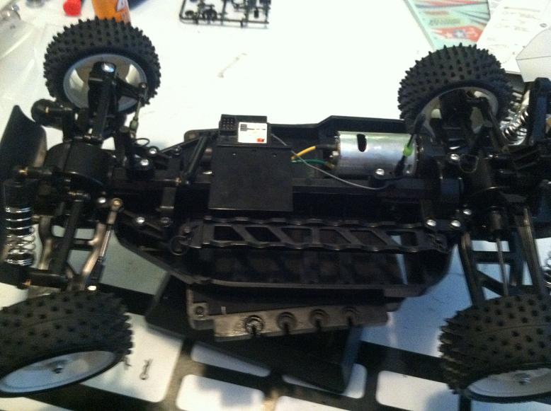

Well my daughter is getting a new Tamiya Rising Storm for christmas. She has wanted a 4wd buggy for a while and with my Tower Hobbies discount I was able too get it with free shipping for $130.
As typical with Tamiya it was a fun build and everything fit together perfectly. I have always loved the looks of Tamiya vehicles. They always have some sort of spaceship shapes too them. This one has a really cool looking body.
Everything went together smoothly, but I was dissapointed in one thing. As normal Tamiya it had plastic bushings for the axles. So I ordered some new rubber sealed bearings for it.
I was also a little dissapointed that the diffs aren't sealed for tuning them with different weight oils.
I was impressed with the shocks though. I have never used any Tamiya oil filled shocks before. The front and rear shocks have different colored bladders in them which I thought was odd until I assembled them. I set the shocks up with a base track setup of two hole pistons front and rear, 35wt front oil, 30wt rear oil. I have never had shocks bleed so well before. Even my Team Associated Factory team shocks didn't bleed as well as these did. Once the shocks were assembled without springs I found that the bladders different color is on purpose. The rear shocks do not have any rebound in them. the fronts have 100% rebound in them. I'm guessing this is too aide the vehicle in jumping. Making the front pop up quicker and the rear is a little softer too allow better acceleration?!
I have the buggy assembled with the stock motor in it for now. I won't use the stock ESC though as I will get a waterproof one. I installed an extra Flysky receiver as I will be giving her my Flysky radio. I need too get a servo for it as well and see what servo saver will fit. The stock Tamiya one is far too weak for racing or any sort of fast bashing. I found that AE B44.2 wheels bolt on so I will be getting jconcepts wheels and some tires for the track. The kit tires will be great for bashing. They are a firm mini spike pattern, but are also soft enough to be flexible enough too give and provide some good traction without wearing too fast. The stock wheels are cool looking and I would get more of them for racing, but they feel a little on the heavy side.
So for now this is where the buggy sits until I get the remaining electronics for it. I also want too get aluminum shock towers for it as I have heard those are a weak spot until the aluminum ones are installed. I also want too get the aluminum center drive shaft to replace the plastic one. The outdrives in the diffs and the axle shafts at the wheels are metal with plastic where the dogbones go in. Those will be replaced with aluminm ones as they wear out.
