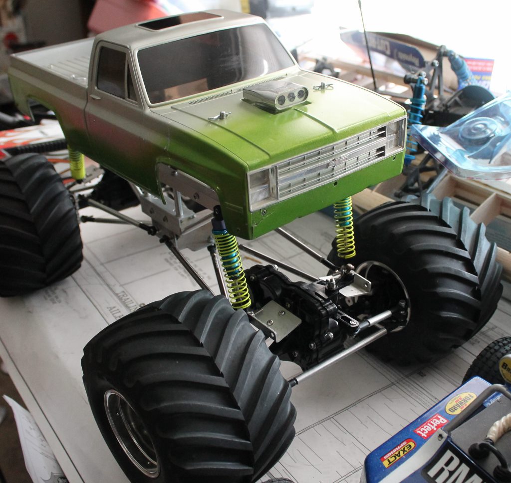

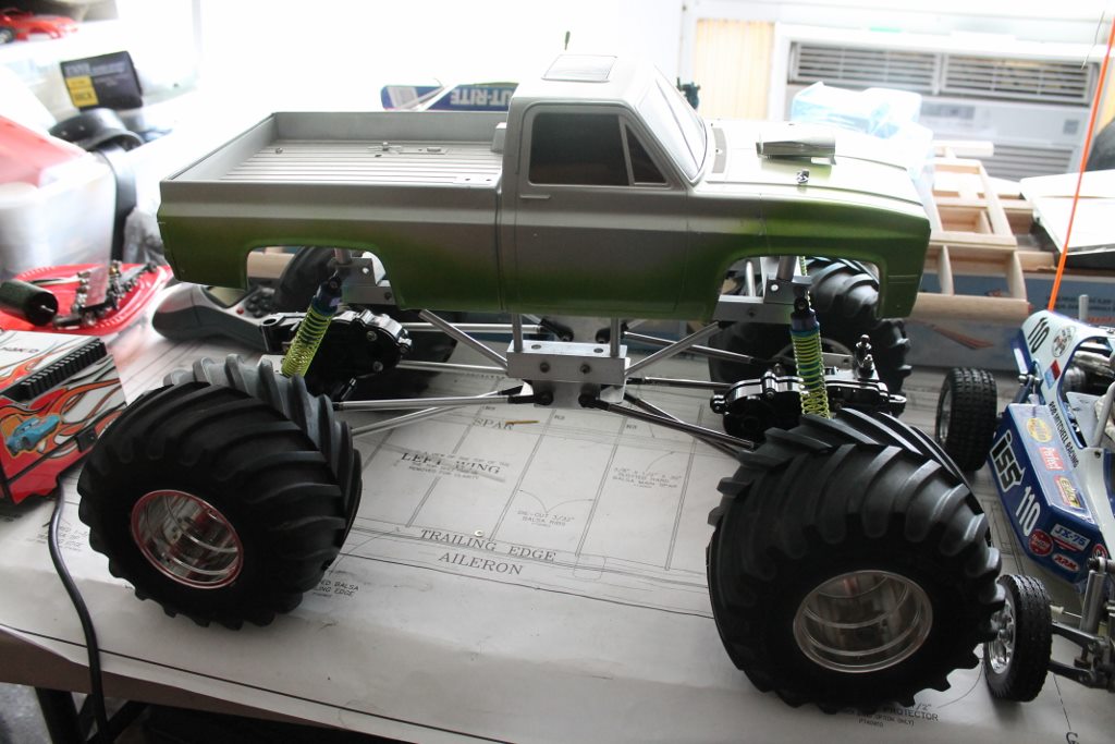

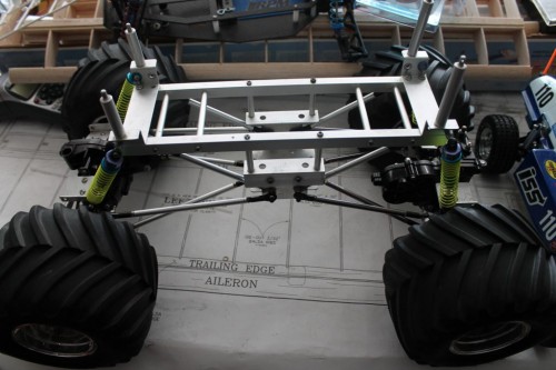

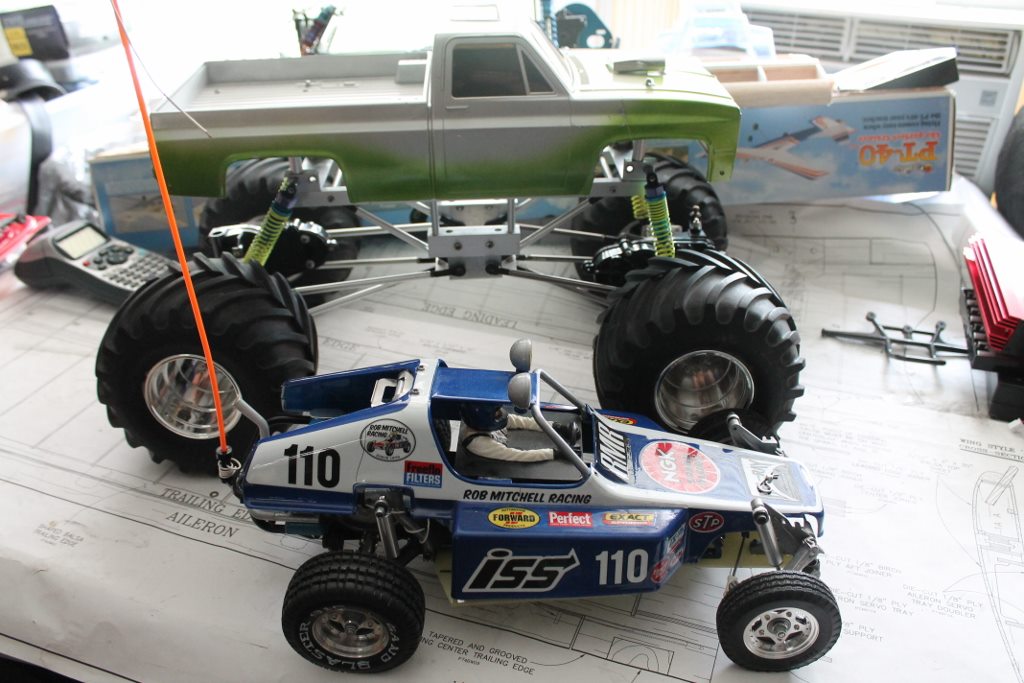

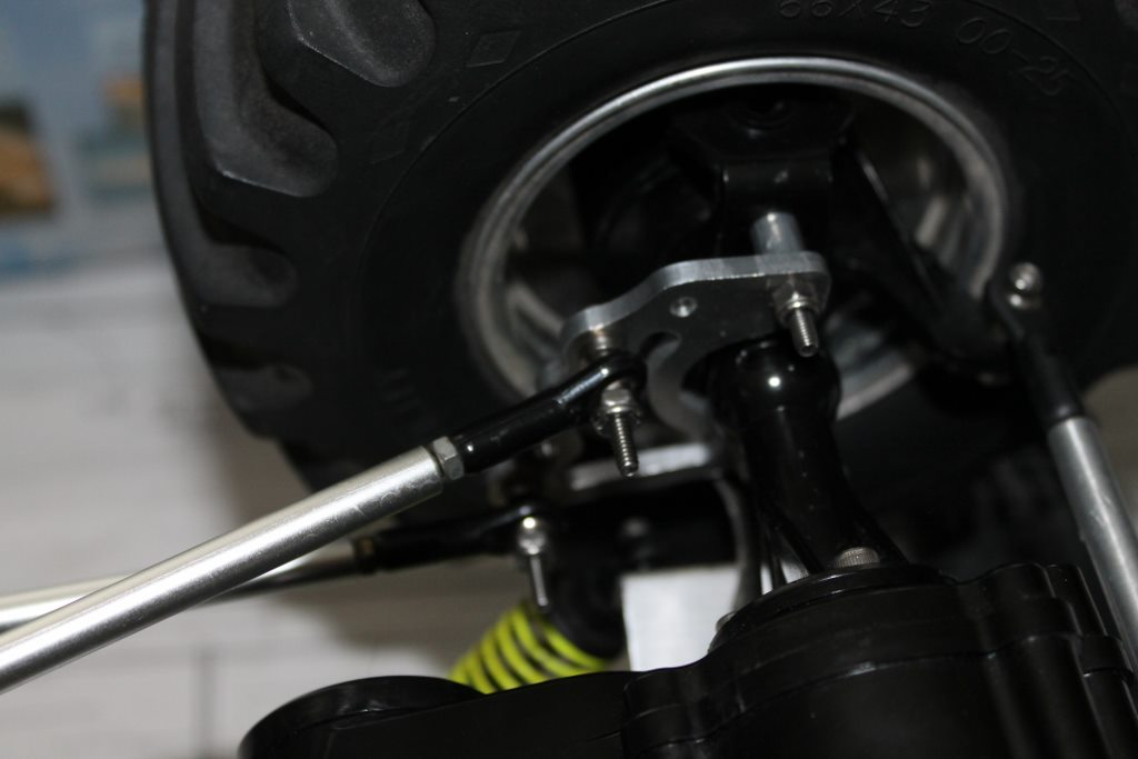

Well I tradded for this a while ago ripped it all apart and started working on it. It has a Clodzilla 3 chassis. well things weren't going so well putting it back together, I couldnt get the 4 link bars the right length, so I tossed it in a box and in the corrner it went. last week I found the plates I needed to fix my Rod length problems, ofrdered them up and put it back together today. its coming along I still need to order more parts for the steering and lock outs for the rear. motors a speed control. this is going to take a while as I want to run dual brushless. and thats going to be Money :lol: looking for a new body. but this thing is a BEAST you can see my buggy champ for size.

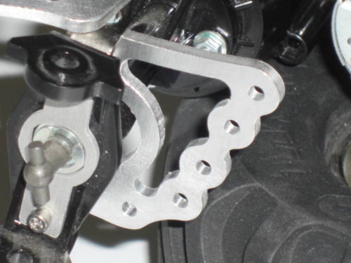

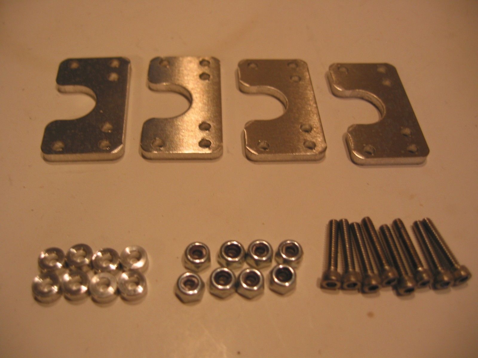

this truck is a Clodzilla 3 chassis and the links were binding and kinda all over the place so I bought some CPE 4 link mounting plates well the 4 link bars are all the same lenght. but not being mounted in the same place on the chassis made the gear box all wonkie, and bind. it was ver frustrating!!!!! to say the least. so changed everything and tore it apart to find it had bearrings and bushing mixed all through. so I ordered new gear cases axle houseings bearrings. and still nothing was soing together the way I wanted. then last week I saw Level3rc had a different staggered mounting plate that was just the ticket. and they were on sale :D to boot so I orderd up a few sets. bolted it back together and the gear boxes sit level like I wanted. the front was a little long so I changed the front links to some Axial 6x91mm ones I had left over from my SCX10 Bronco build it brought the front end back almost 1 1/2 the back is still long for now thats how its going to stay. I want to see if I can do a little racing with it when its done. and the lenght I think will make it a little more stable. the Level 3 mounts also have a plate on the inside to strengthen the axel housing. very nice parts and they even come with all of the mounting hardwere. I also did the mod to remove the axle houseing from the out side.
CPE 4 Link mounts
CPE 4 Link mounts
LEVEL 3 RC
LEVEL 3 RC
LEVEL 3 RC

I bet this is no longer 1/10 scale its more like 8th scale or little bigger. pull yours out and post up some pictures I would love to see it.
