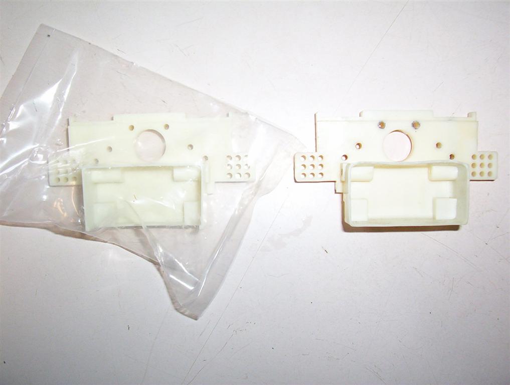

Here is a pic of both rear bulkheads, in the battery area the re-release has no floor and the roof has
been raised.
Cheers, Dave.
been raised.
Cheers, Dave.

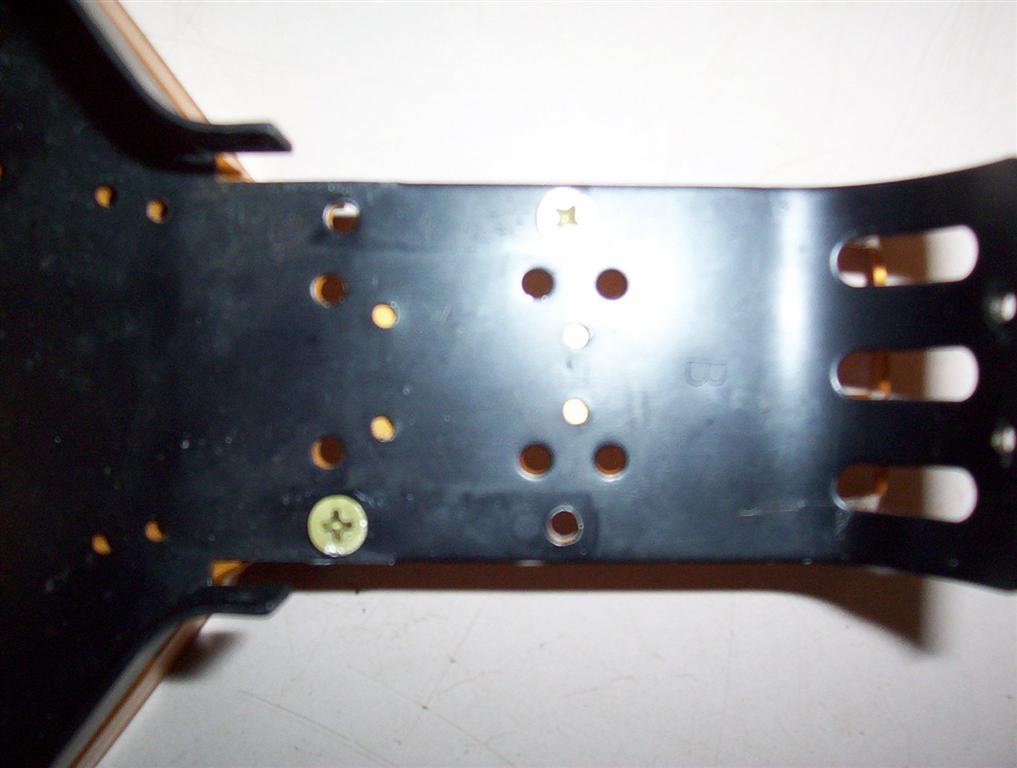

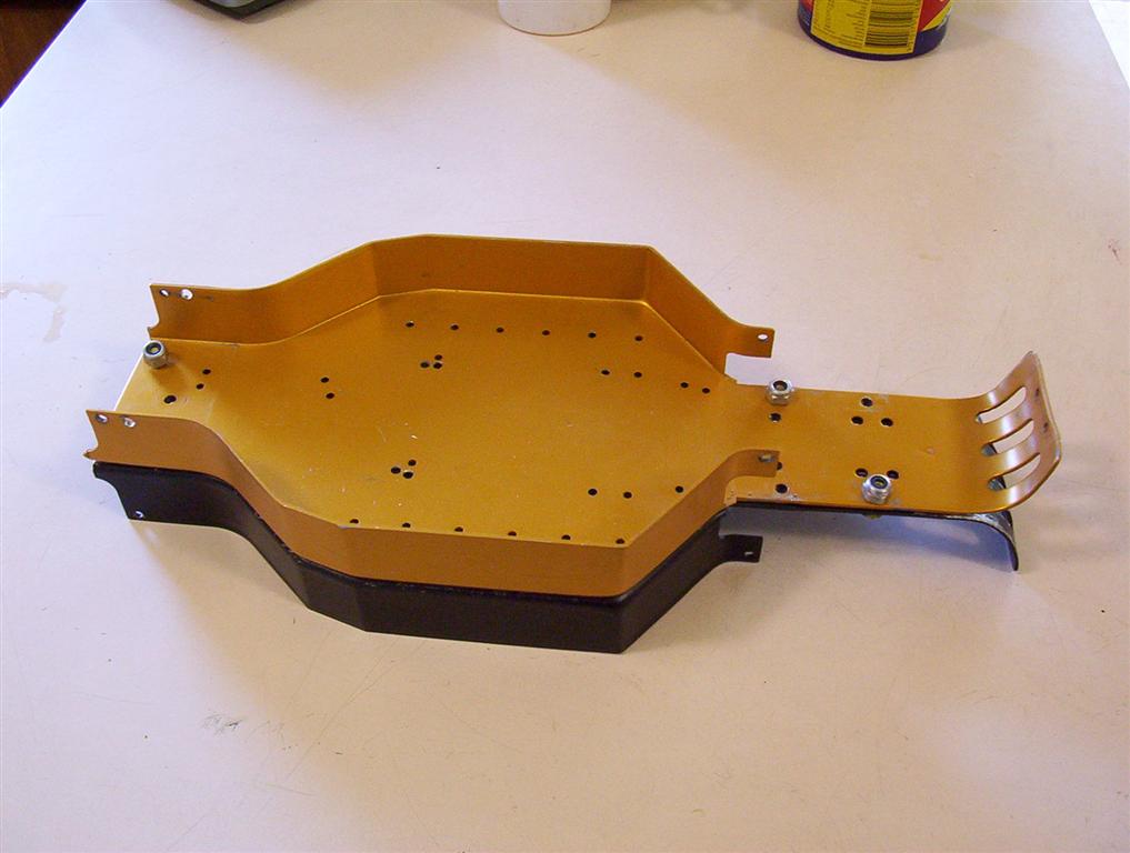

I use an old B stamp chassis that has the inline battery cup holes and the holes for the stealth
gearbox as a drill guide.
Bolted together like this you can drill the inline battery cup holes and drill for a stealth if needed.
Cheers, Dave.
Cheers, Dave.

Re: Original gold pan: properly securing a lipo pack?
Re re bulkhead and a good quality double sided tape to put the front batt cup as far forward as you need are my top tips mate, just remember to clean the chassis an batt cup with wax an grease remover or something similar that won't leave a residue prior to sticking the tape on.. I race every cpl weeks an have had the same tape on my 10T batt cup for a cpl of years at least so if done correctly it is very effective an saves any unwanted holes in the chassis...
Dave is right if you have a chassis with stealth holes bolt them together an use as a jig..
