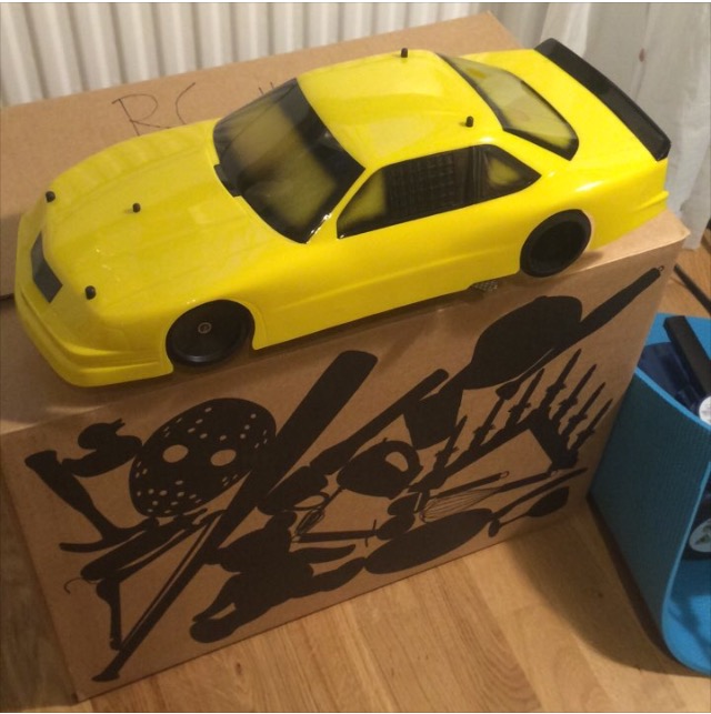

I'm painting a full body Lumina (#4 Kodak) and going with a Faskolor Fasyellow with a few drops of Fasorange in it, but now when done it's too bright yellow.
Can i back it up with Fasorange or Fasred to try get it warmer in color?

did youi back up the yellow with white or black ? if so you are going to have to live with the color

Nope! just yellow at this stage. I did not want to try backing it up until I talked to you guys.

as long as the yellow is a flat coat with no heavy spots back it with a red will push it more orange .. black will make it a duller yellow .. dont do white as it will be a brite yellow
