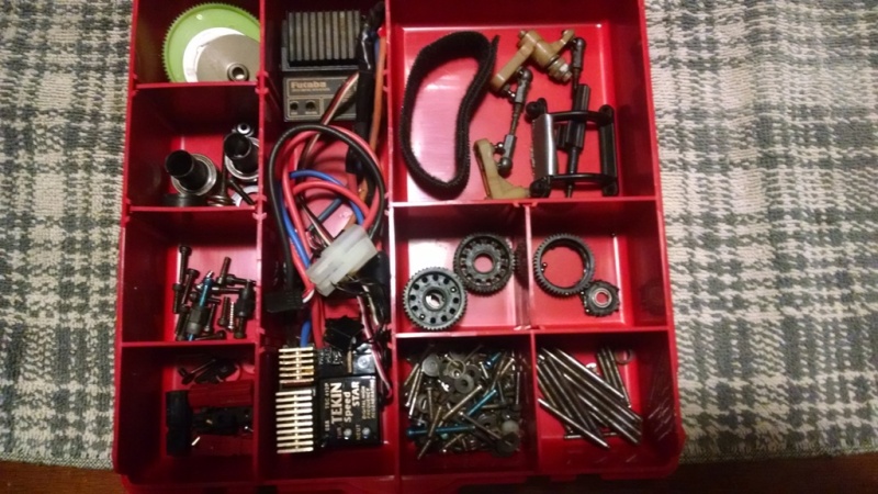

Looks like you have the dual disc slipper in 1st picture in top left. thsi was used on the XXT+CR and XX Kinwald. It's a great design and can handle brushless no problem.

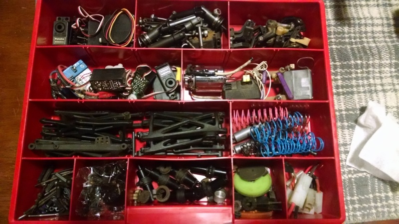

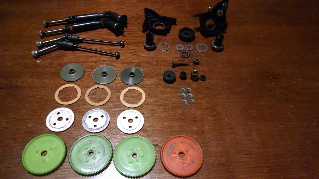

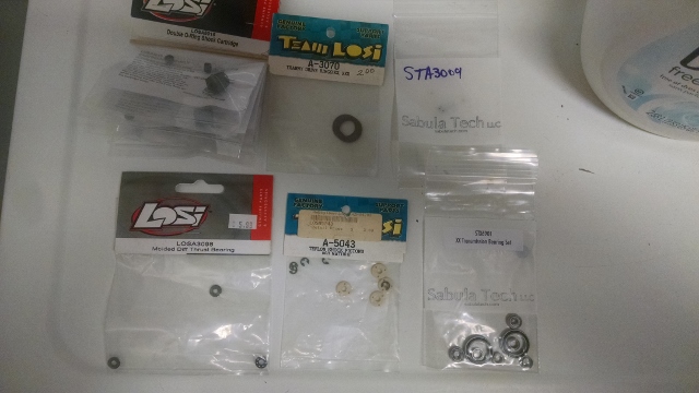

My main problem at the moment, as I see it, is that I have a bunch of parts without knowing what came from what car originally. So, lets tackle the diff first. I'm attaching a pic of the parts that I think I need to assemble a complete diff.
As far as I can tell, I'm missing a few shims (#80 1/4 x 5/16 shim, #82 thrust bearing seal, all bearings, and diff tube (#73)). I will also replace the ball bearings (#79), diff washer (#76). Do the six beveled washers (#72) need to be replaced as new?
As far as the slipper, I definitely want to use one. Looks like I have several sets of single slippers. The first green spur is an 88t, the Orange is a 90t. The middle two greens are not marked. So, to make a double slipper (based on the instructions at vintagelosi) I just need the special dual disk spur, but I got the rest of the parts. Correct me if I'm wrong.
Thanks again, all!
RCveteran
Posts: 1498
Has thanked: 26 times
Been thanked: 200 times
Re: New Member - Trying to rebuild an XX-T
Post by RCveteran »
Yes, looks lie all you are missing is the dual slipper spur.

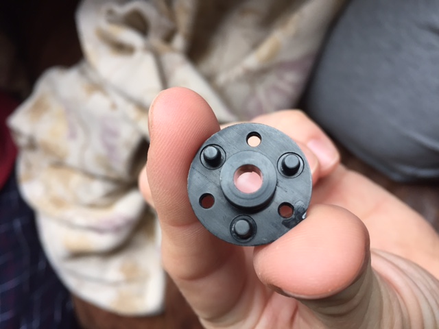

Anyone clue me in to what this is, how it's used? I think it's some sort of adapter from Kimbrough Racing.

Got some goodies from OldRC.com. Just waiting on my clear and black goo to arrive, and then I can rebuild the diff. While we wait, Ill work on the shocks.
Looks like the silver and black aluminum shock bodies are the same dimensionally, any difference in which RCs they were offered on? I have both, don't know which to use.
Thanks!
RCveteran
Posts: 1498
Post by RCveteran »
The silver are earlier JRX2/T, the black ones would have come with your XX. Yes you can rebuild both with same cartridges, Losi 5015 part #.
