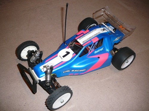

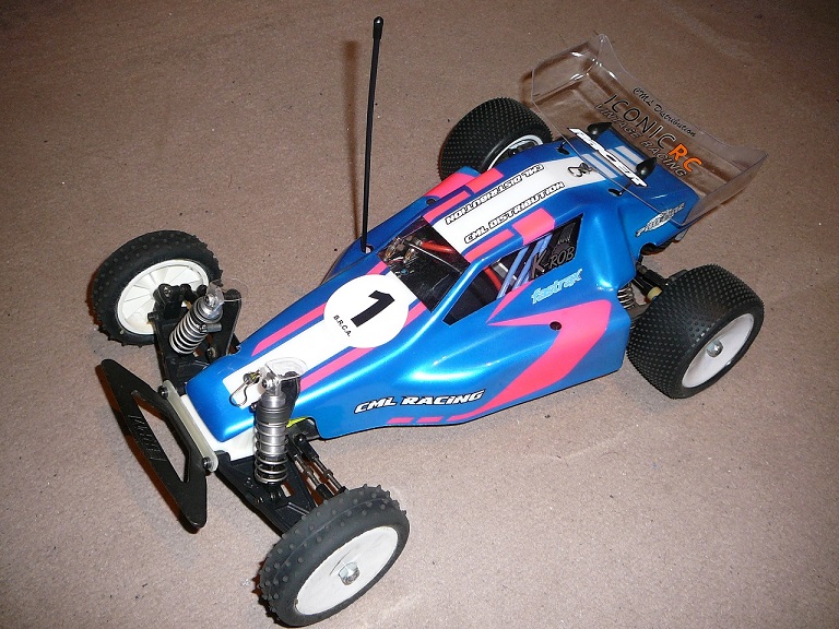

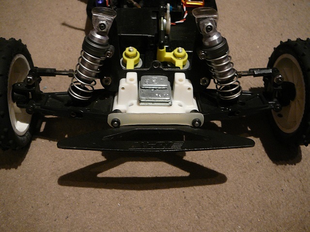

Having had a JRX-2 back in the day and having a few other vintage cars I decided to get one. Was a bit of a mess but tidied up okay.

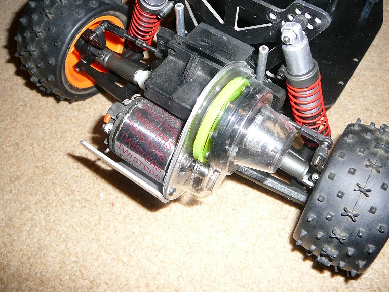

I then decided I wanted to drive it but I have nightmares thinking back to the problems I had with the original gearbox (seemed to be forever eating diff thrust races).

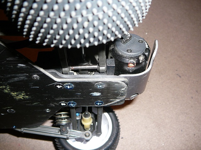

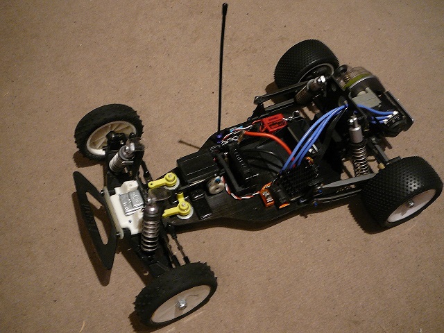

So thought I would experiment a bit and found a XX retro fit box which I knew would be reliable, unfortunately it's not a straight fit due to the diff sitting so low. Didn't want to cut the JRX chassis so just made a up a 2mm plate to raise everything else up.
Worked a treat and had the added bonus of making the battery slot on the bulkhead higher to take Lipos.
And it's now a racer :D
Still suffers power on understeer but added plenty of weight up front and gone to shorty which helps. Cracking fun 8)
Had to fit a rather ugly bulkhead brace as I bust the original and they're not cheap :cry:

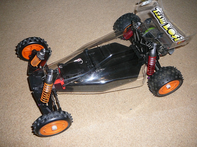

Also got a JRX Pro sitting on the shelf with hydra drive (yes I know this came along later but it just looks so good!!)

I always thought that the retro fit XX transmission was a direct bolt on fit. That is not the case? What didn't fit?

It is a direct fit on the molded chassis such as the Jr.2 but not on the the JRX2's flat graphite chassis. Here's the recess in the transmission section of the molded chassis.....

Gotcha. I didn't remember that the molded chassis had the recess under the transmission. Its not often that I remove a bullet proof LRM from its chassis. 8)

I run a shorty Lipo pack in my racer JRXT pushed way forward to middle almost up to steering servo, helps keep car much more neutral and counter the understeer you are finding. I am hardly a top driver but it is the most balanced JRX I've come up with yet.

Looks awesome! Interesting you've looked at moving the cells around. Mine was definitely better with the shorty forward compared to a standard length pack.
A friend has just made an alloy chassis for his JRX2 and has offered to make one with a cut out for the gearbox - I'm seriously considering it! Could also get more kick up at the front to bring it in line with the Pro chassis.
