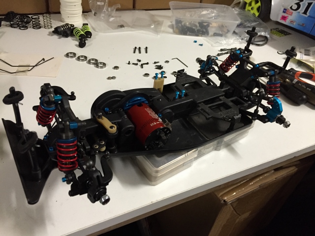

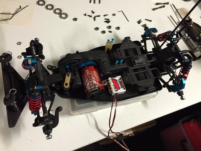

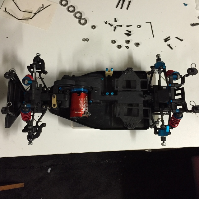

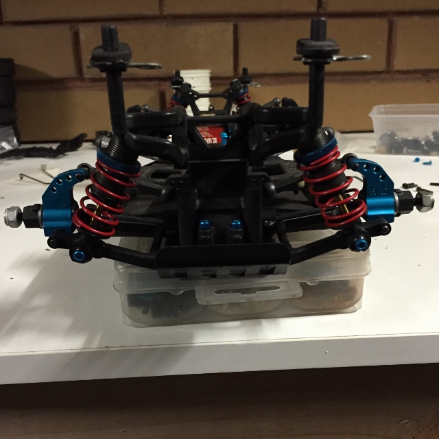

It has been a while since I have posted up pictures of a build. I decided to dust off my old Street Weapon, 1st gen kit that has had very little use since I bought it when it was released.
Unfortunately I got carried away and forgot to take progress pictures :roll:
I've been collecting parts for a few years, on and off as I remember. Still after a few to complete the build and get it on the track. I aim to run it in 13.5 which will be plenty fast enough.
I started with a compete tear down and rebuilt the diffs with new balls, plates, pulleys and ran with a set of Tough Racing belts. I then also purchased a bearing kit for it and replaced all bearings including the plastic bushes in the steering. The MIP aluminium drive shafts finish off the driveline quite well
Some of the other bits I bought was a Tuning Kit off eBay, sway bar kit and some threaded shock bodies. Most of the nice blue trinity bits I had laying around waiting for the right Losi project!

Next steps are to try and find:
  • Trinity blue motor mount (seem to be harder to find these days!)
    Titanium steering link (I've lost the old steel one)
    Servo
    Figure out gearing for the 13.5
    wheel solution since the old street weapon uses an 8mm hex!

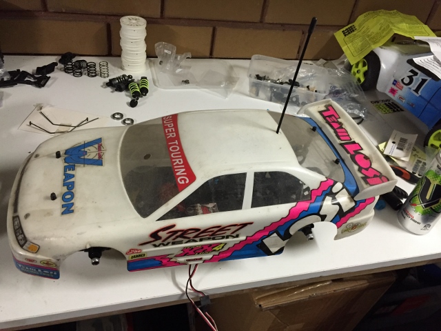

hello, I am actively about you, here is mine,
always like that. :(
Thank you.

YUM!!! box art!!! (or close)

Lonestar wrote:Image
Looks better now since giving the body a good wash! I think it had a good 15 years of dust on it!

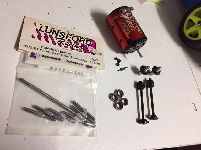

So I've managed to find some more parts on eBay..
I purchased a Lunsford Ti turnbuckle kit which also included a Ti steering rod. I picked up a XXXS hex kit which I hope will sort out my front hex issue with modern wheels. Ordered a Tekin Gen2 13.5 which should work well with the RS speedy. I topped the lot off with a bunch of Ti ball studs to bling it up a bit!! Just need to keep my eyes open for a Trinity blue motor clamp!
I just need to sort out an RX and a servo for it and it is more or less there..I also dug out an aluminium lay shaft / slipper assembly for my xx-4 parts bin.
I'll get some pics up as the parts arrive!

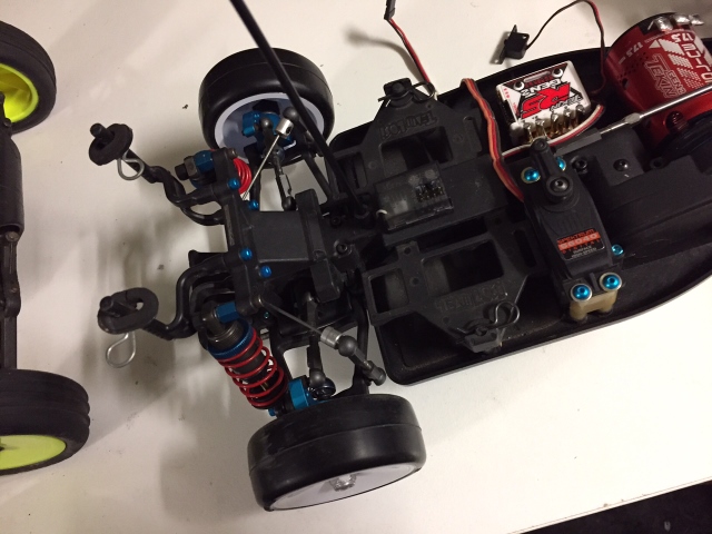

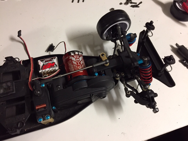

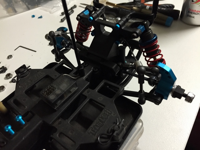

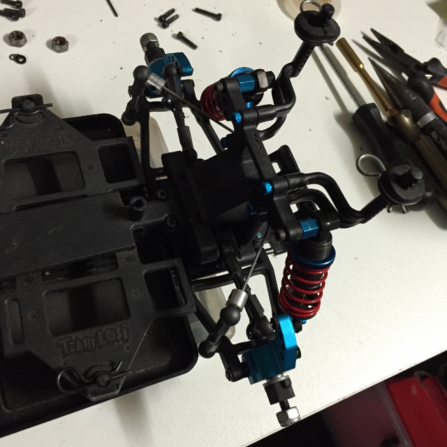

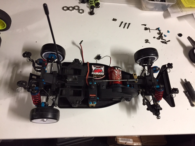

Small update for my build..
The xxx-s hexes have arrived but I realised that I am missing the yolks for the front MIP axles (I must have stolen them for one of my XX-4 builds :roll:
The Lunsford Ti turnbuckle kit arrived as did the 13.5T Tekin Gen-2 motor. I also managed to find a Trinity blue motor mount from a generous member on this site too!! :wink:
I've installed a Spektrum 6040 servo and started the installation of the shiny Turnbuckles while I wait for a few more parts!
