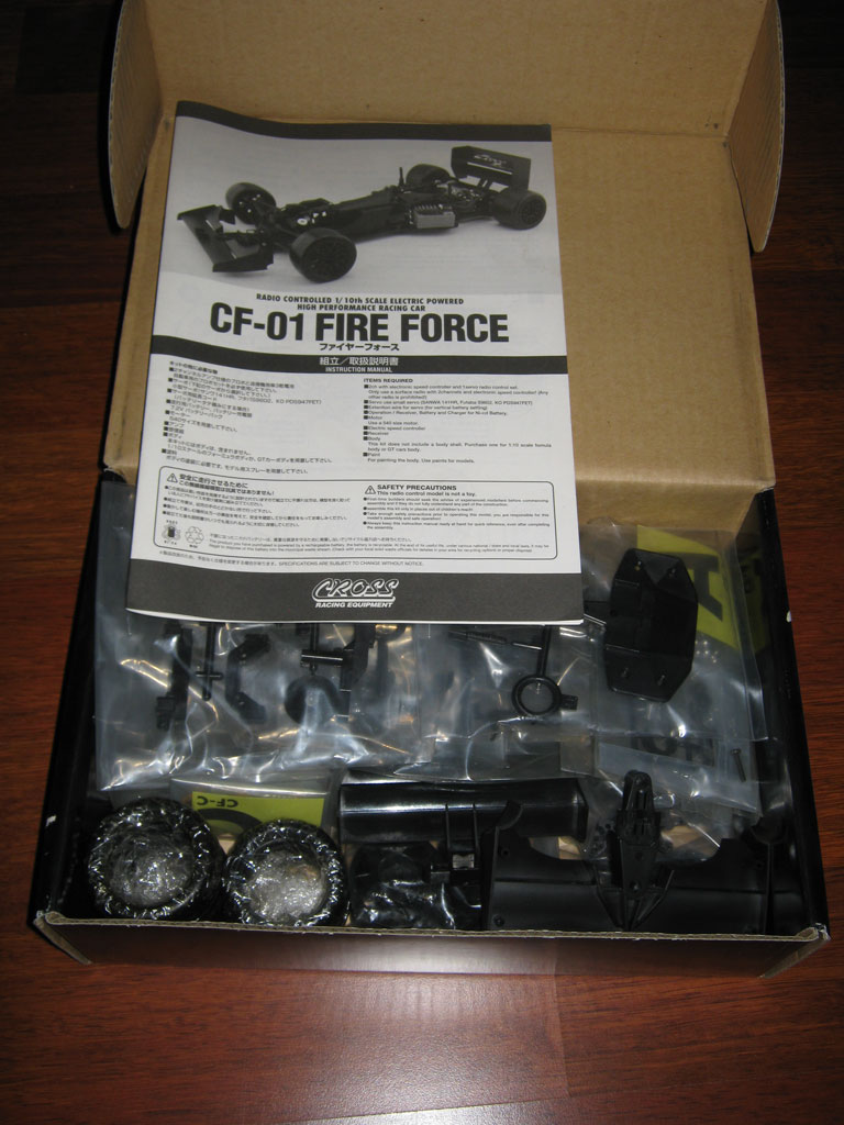

This will become a build thread for the Cross Fire Force CF-01 F-1 chassis. However, before I actually start building this car, I will need to complete my Kyosho Impress, because I want to have the ancestor finished before I tackle the descendant (for comparison purposes) :mrgreen:
In case the preceding is incomprehensible: Cross did development work for Kyosho on the Impress and might also have produced the kits for them. The Fire Force is basically a very evolved Impress, released a few years after the Impress stopped being available.
Box & open box:

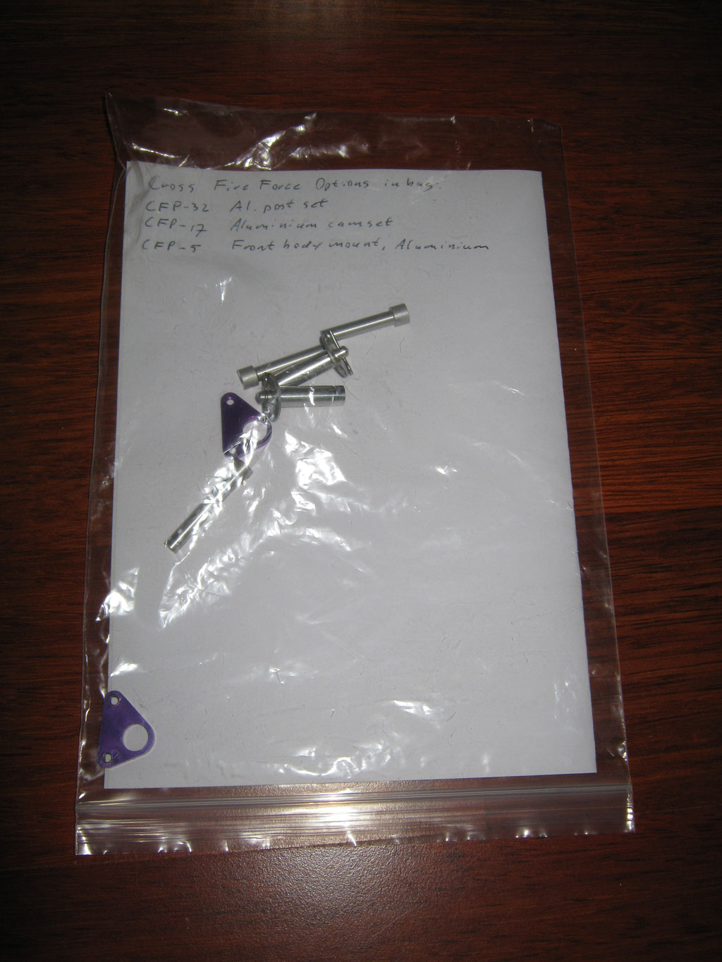

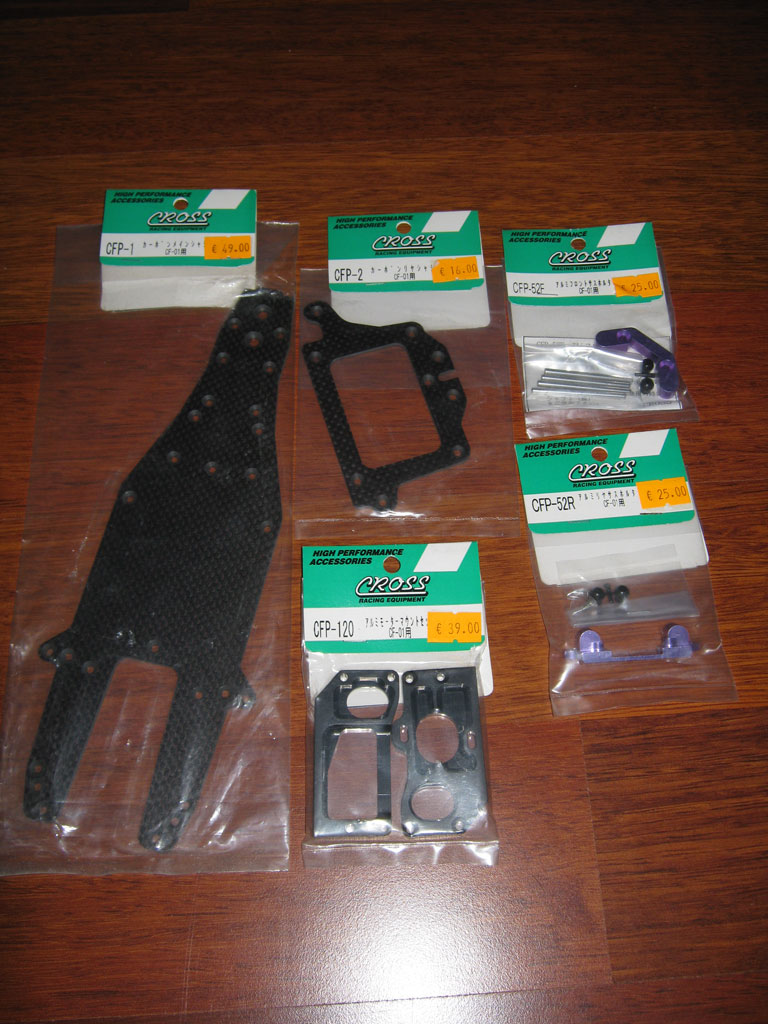

Optional parts found in part lots:

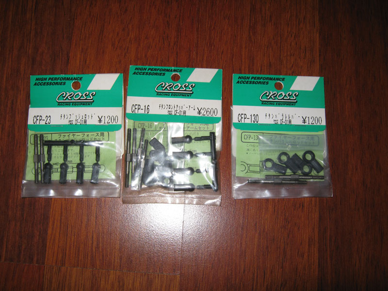

Recently bought optional parts:
I still need to buy a few optional parts such as turnbuckles and the like.

Turnbuckles have shown up:
I also received the ball bearings some time back.

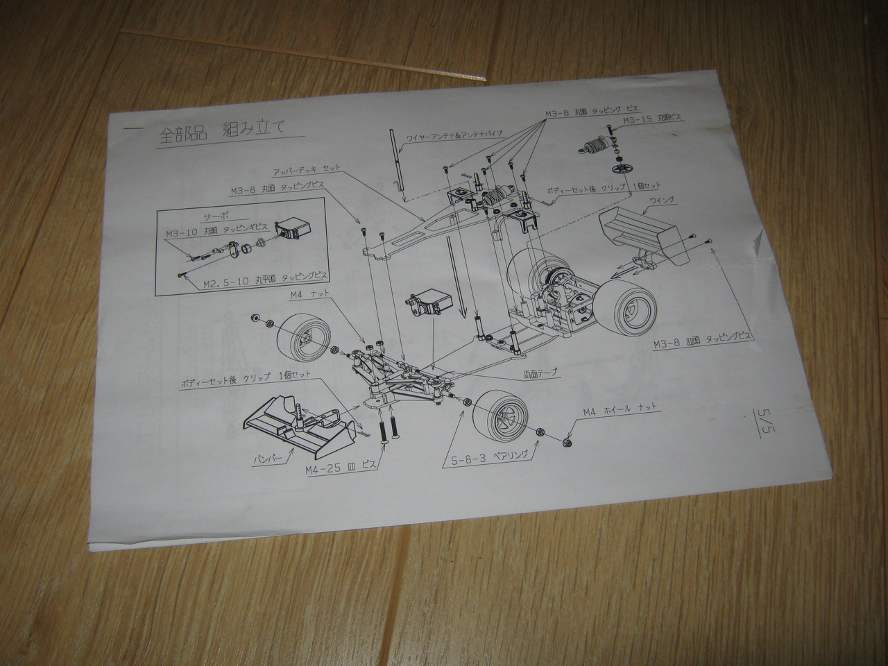

A manual that consists of a bunch of photocopied A4 sheets stapled together, all in Japanese:

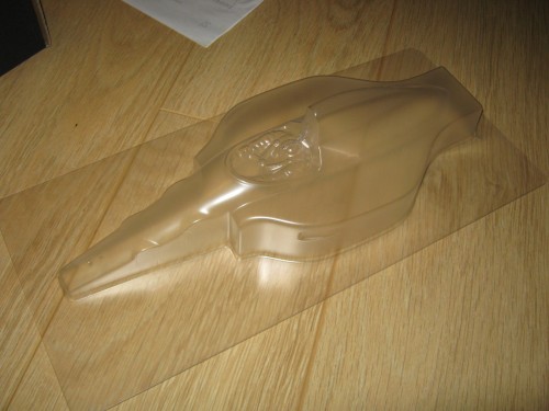

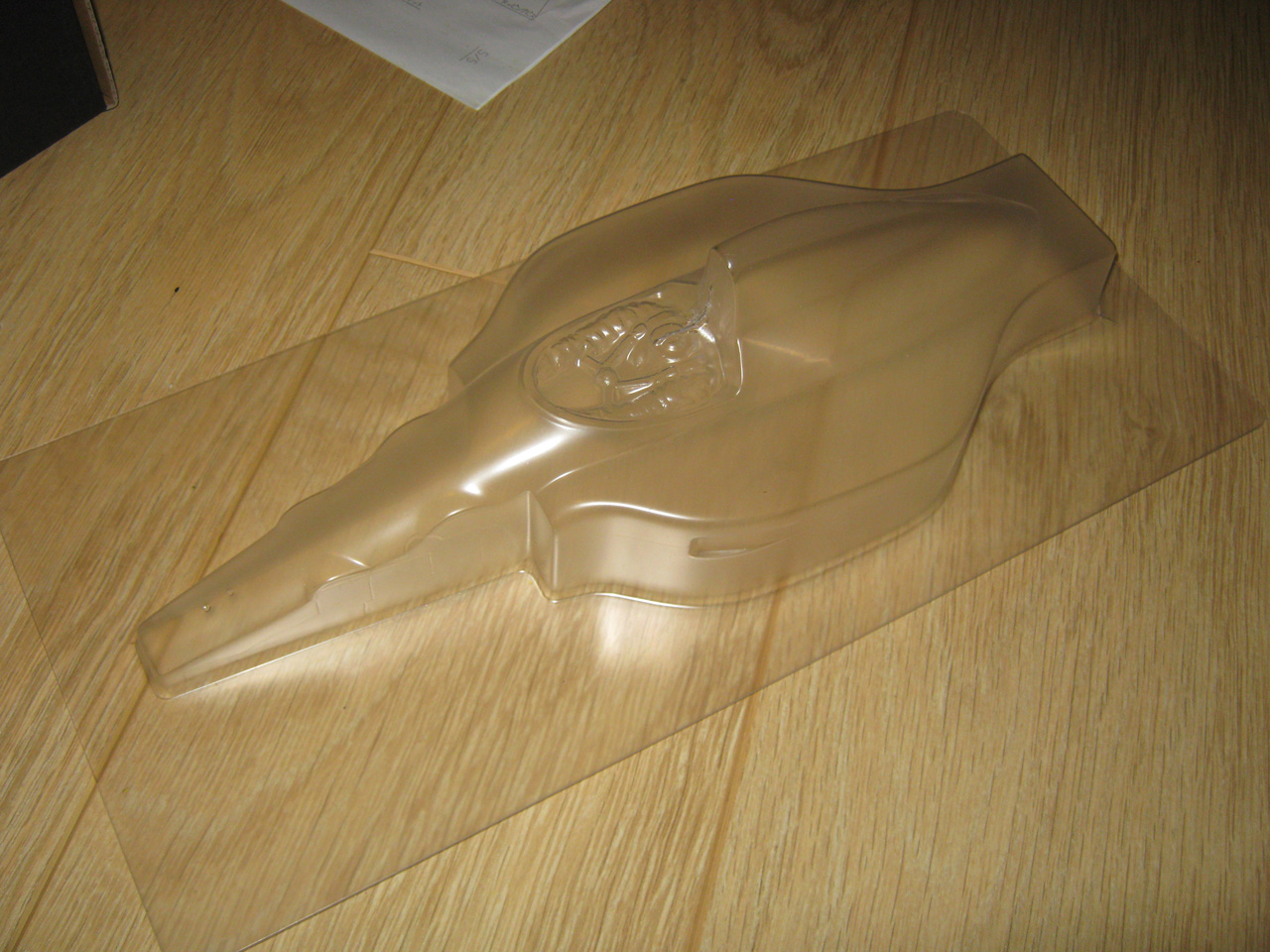

A clear F1 body of uncertain make, probably produced by Cross:
Now I dislike Cross' bodies for one particular reason: they're not made of lexan/polycarbonate and tend to shatter on impact. So I don't have too high hopes for this getting used for anything else than display...

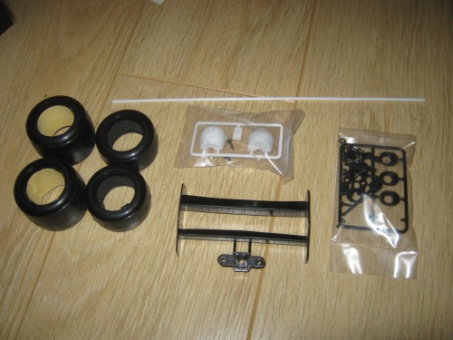

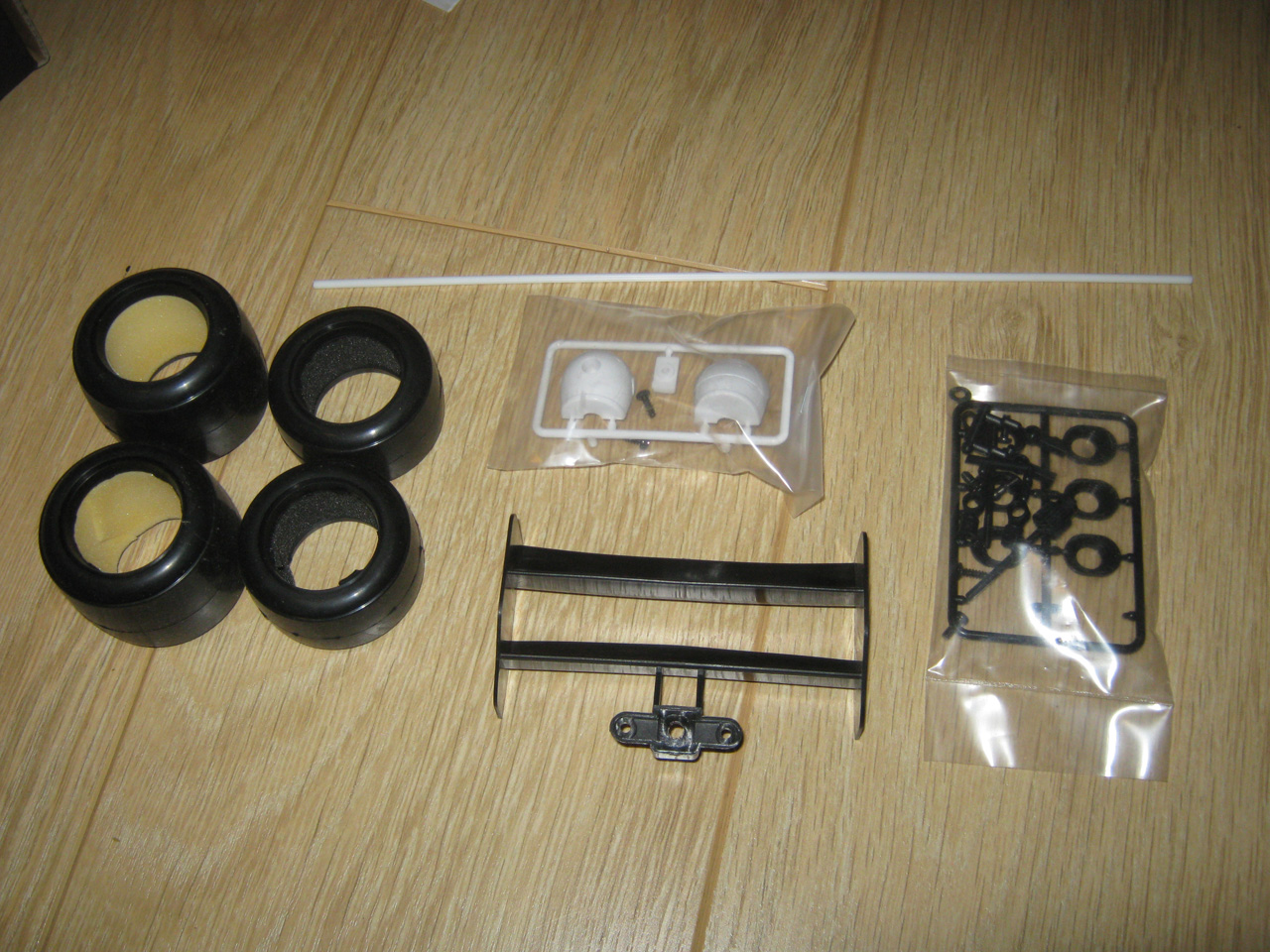

A driver helmet, misc. parts baggy, antenna tube, rear wing, and four tires with inserts:

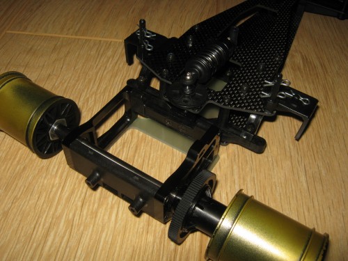

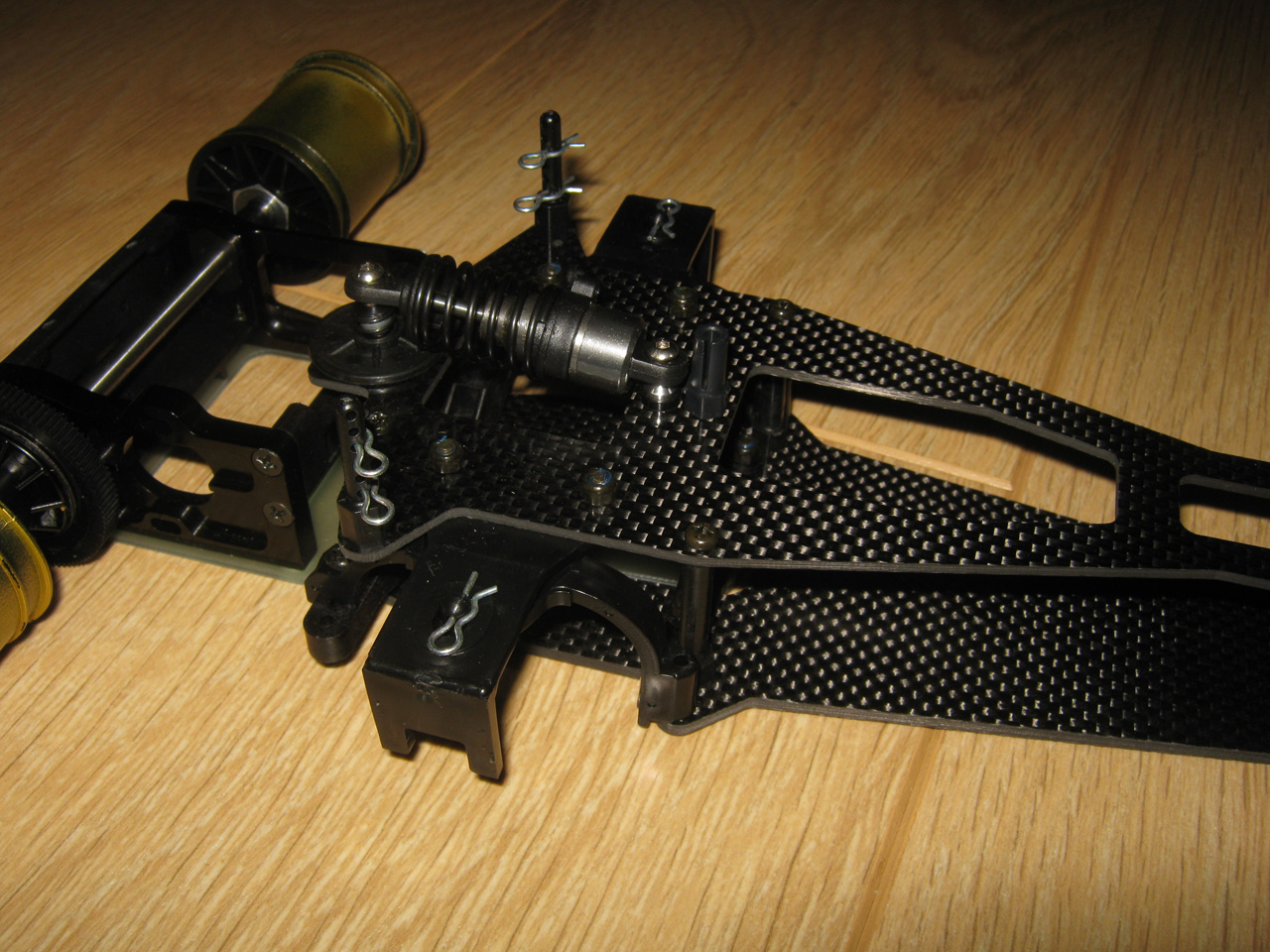

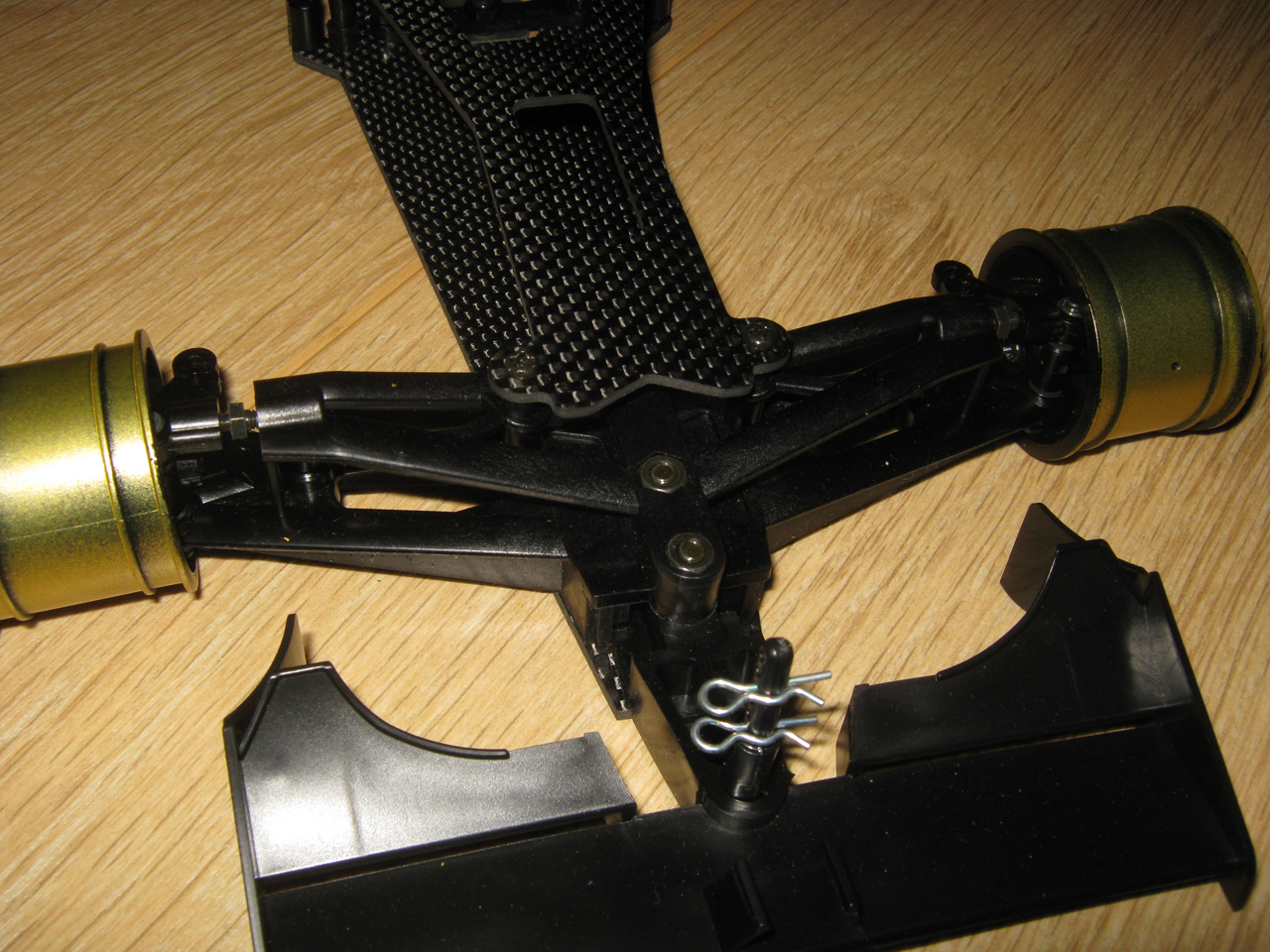

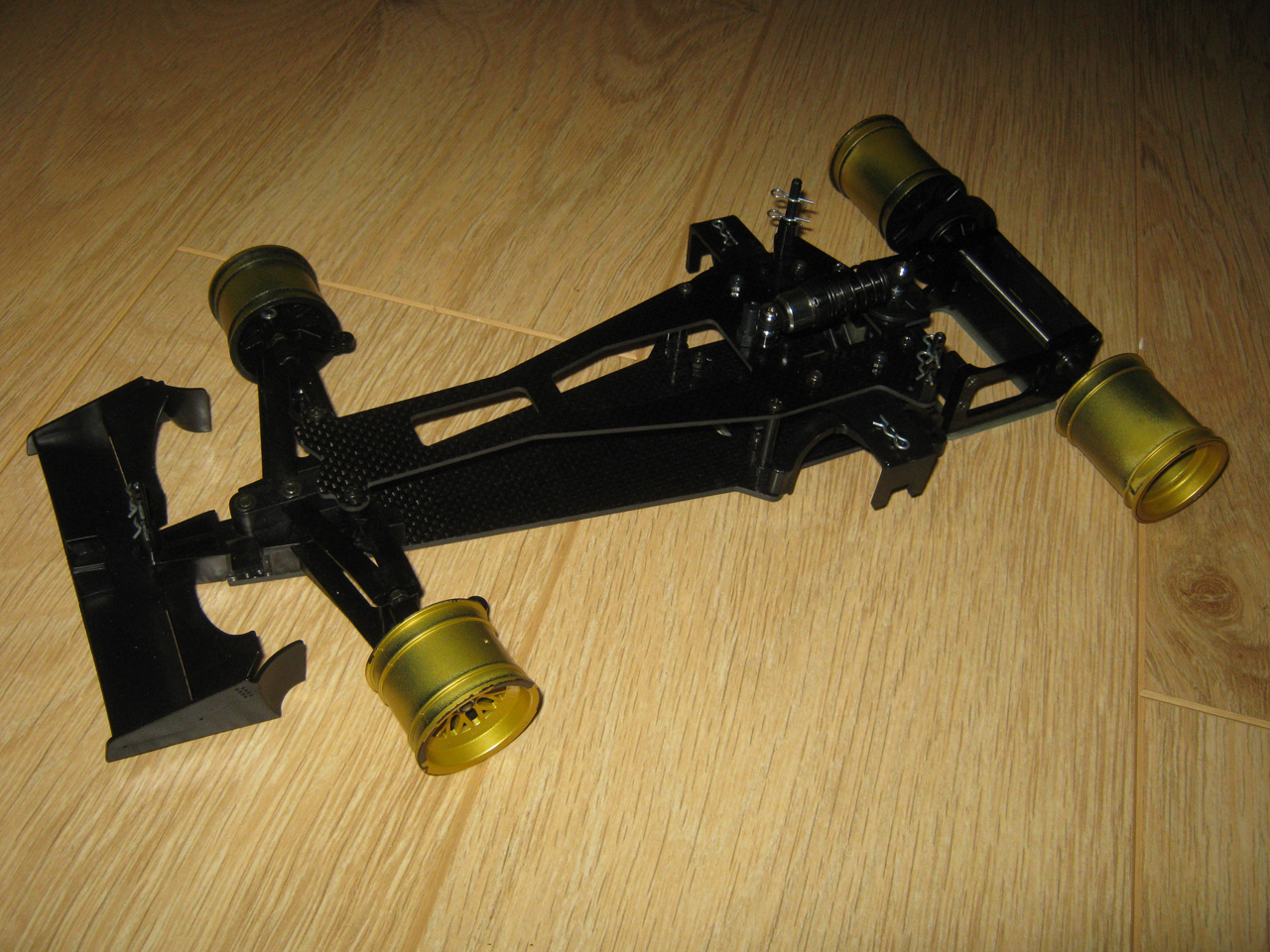

...and the car itself, which comes almost fully assembled:
Unfortunately they forgot to degrease the wheels before painting them :roll: , so the paint flakes off...

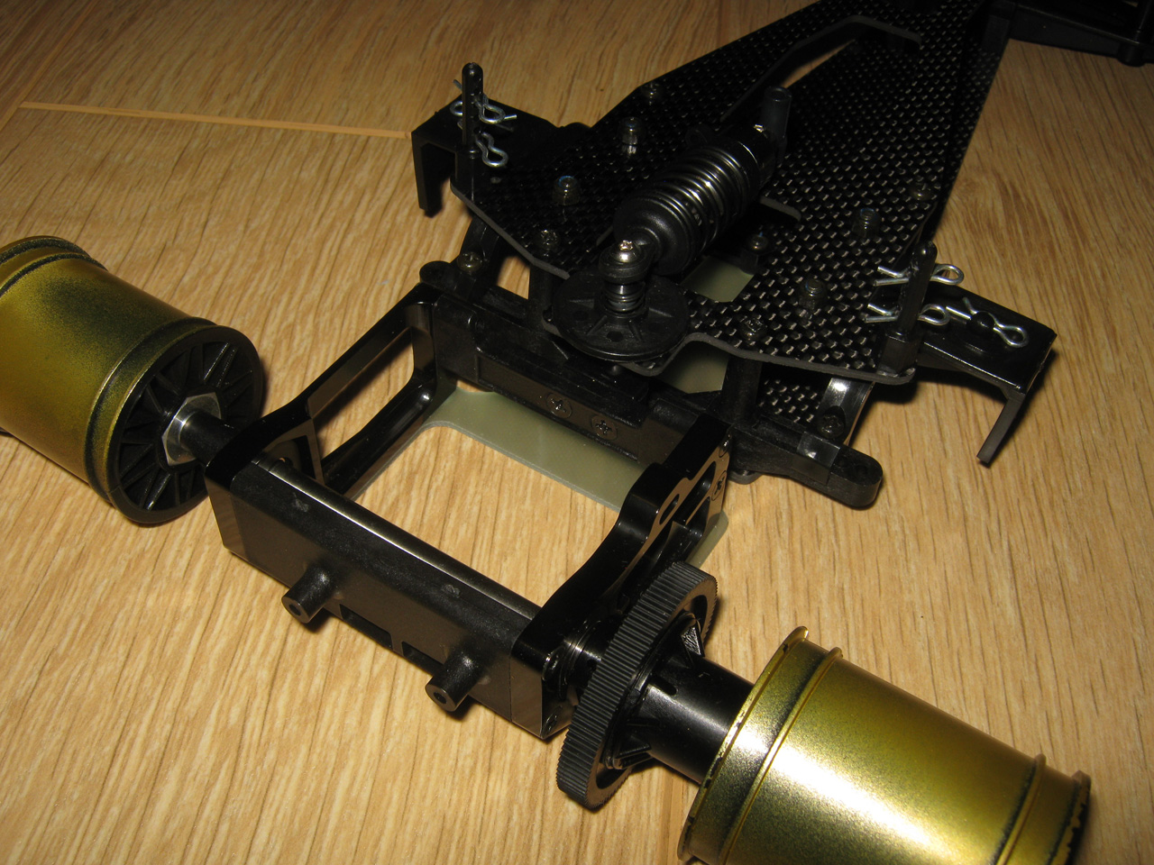

It has a few advantages over the previous version, namely coming with a carbon chassis and top deck, alloy pod parts, fibre reinforced plastic parts, alloy shock, and adjustable camber at the front:
Unfortunately, it also has a bunch of regressions compared to the previous version:
- no rear link suspension, but a t-bar without tweak screws.
- the servo needs to be taped to the chassis, which means high-torque models and mini servos are not an option.
- no more cool cantilevered front suspension design (of course the new suspension is lighter...).
