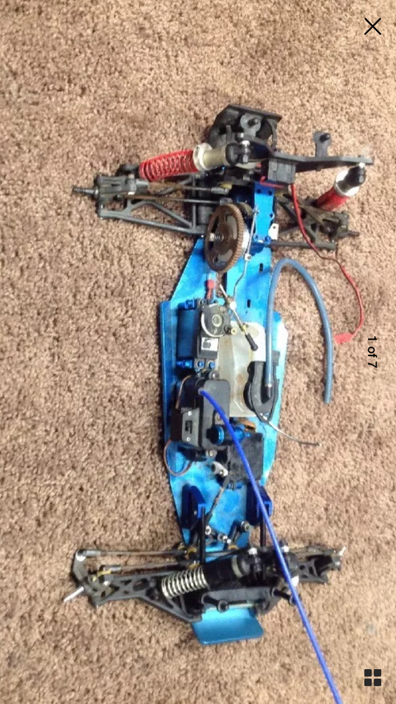

Here is the truck
Some aluminum upgrades that will be coming off.
Well Photobucket not letting me post.

nice. Trinity tranny brace, MIP boost bottle, Robinson Racing steel spur, aluminum nose tube mounts. good platform to start with...
Re: Reluctantly bought a rc10 gt
I thought its was all cheesy aluminum stuff. I actually ordered all the factory stuff. Is all that trinity stuff? Has aluminum servo mounts, tranny case , and trans mount. I did recognize the Robinson spur but there is also a brake attached to it that had a strap around it. Anyone know who made it?
your lucky I didn't see that one then if it was on ebay
The drum brake should be a Crescenzi Racing brake setup. I only did a quick look but yeah, alot of the alloy for the gt's are cheesy but that looks to be a trinity tranny brace. The brake assy is nice and gave the gt some stopping power vs. the original stuff.
