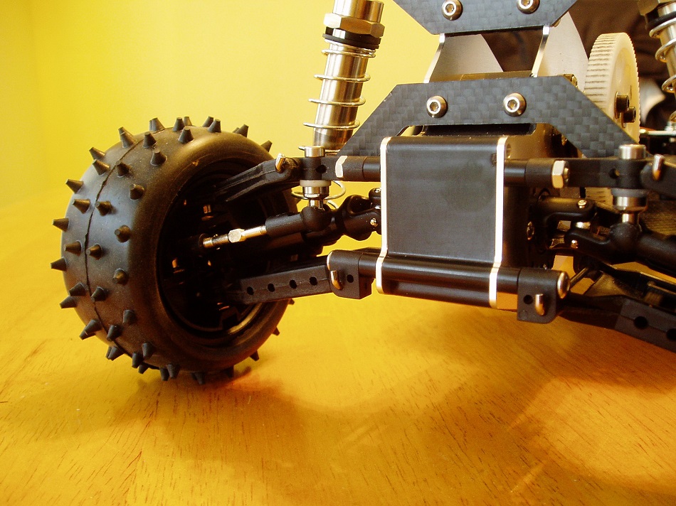

After assembling the re-re XLS’s rear suspension in accordance with the manual, I’ve noticed what I would consider an excessive amount of rear wheel bump-steer (perhaps 5 degrees or more per side). The manual has you adding a 2mm spacer under the inboard ball-stud so I added another 1.6mm nylon washer and that seems to have removed most of the bump-steer (total spacing is now 3.6mm). I believe that a small amount of rear bump-steer would be beneficial on a loose track to correct for oversteer but, as assembled per the manual, this seems to be way too much and could possibly result in some strange handling characteristics in rougher areas of the track. I’ve had a look at my old original XLS and I have its inboard rear ball-studs at about the same height setting (about 3.2mm total spacers). I’m curious if anyone who is running their car has found a need to dial back on the rear bump-steer and if you could please also describe your track conditions. Thanks!

I found the same, and added a similar washer which all but removed the bump steer. I did the same to the front steering ball joint in the hub as there is a lot of bump steer on the front too.

Hey thanks for replying. Yeah, in fact I am doing precisely the same thing to the front (added 3 x 0.6mm thick nylon washers). Its good to know I'm not the only one finding this problem.
This seems pretty basic; I would have expected Schumacher to have this sorted out before they launched the kits. Anyway, it's an easy fix and could be attributed to the challenge of building the kit.
