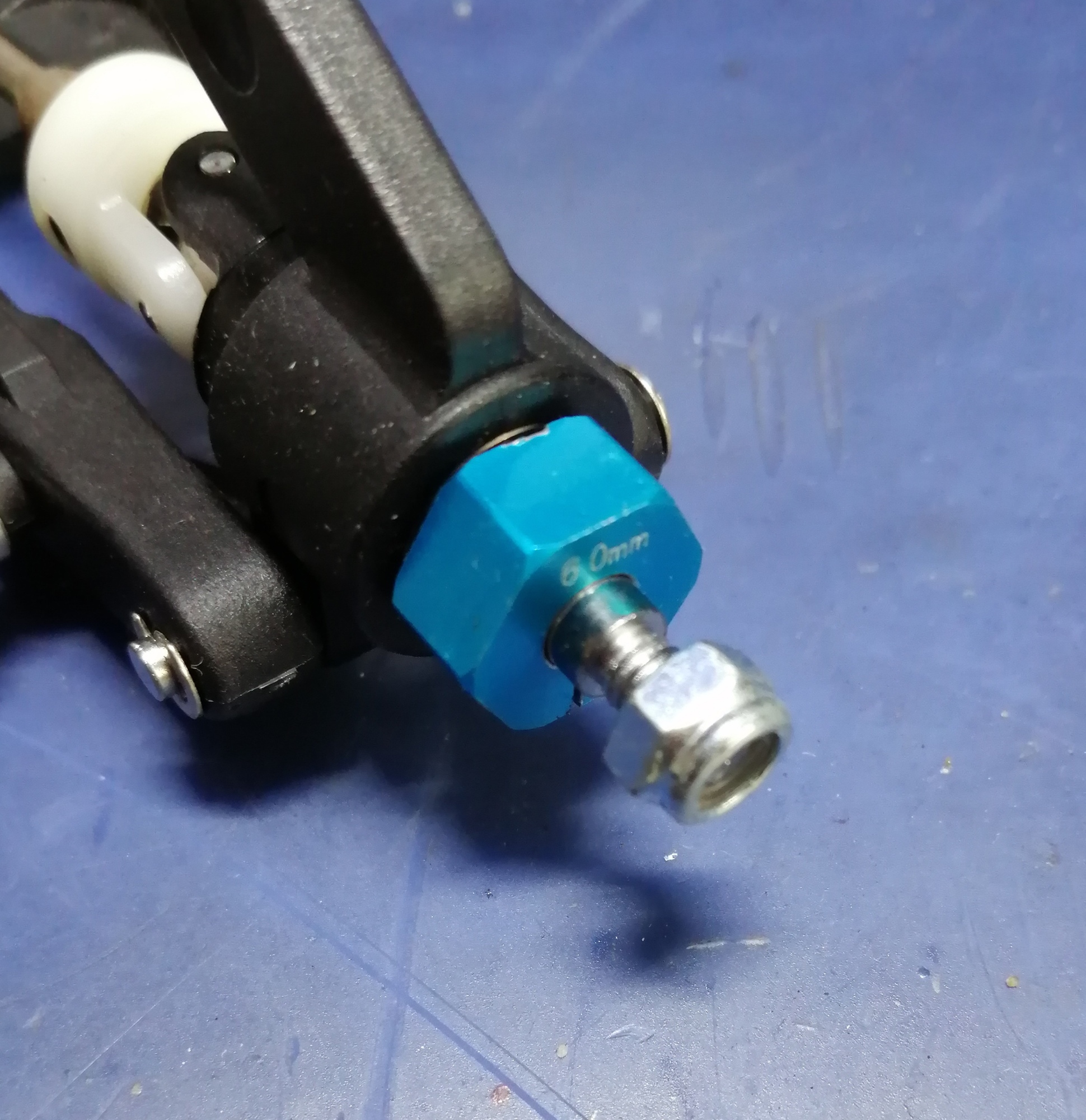

Re: TRX-3 wheels
Look forward to the build.
Found the hexes I used. 6mm and drilled out for the axle.
They give roughly the same offset with a modern wheel as the original wheels gave.

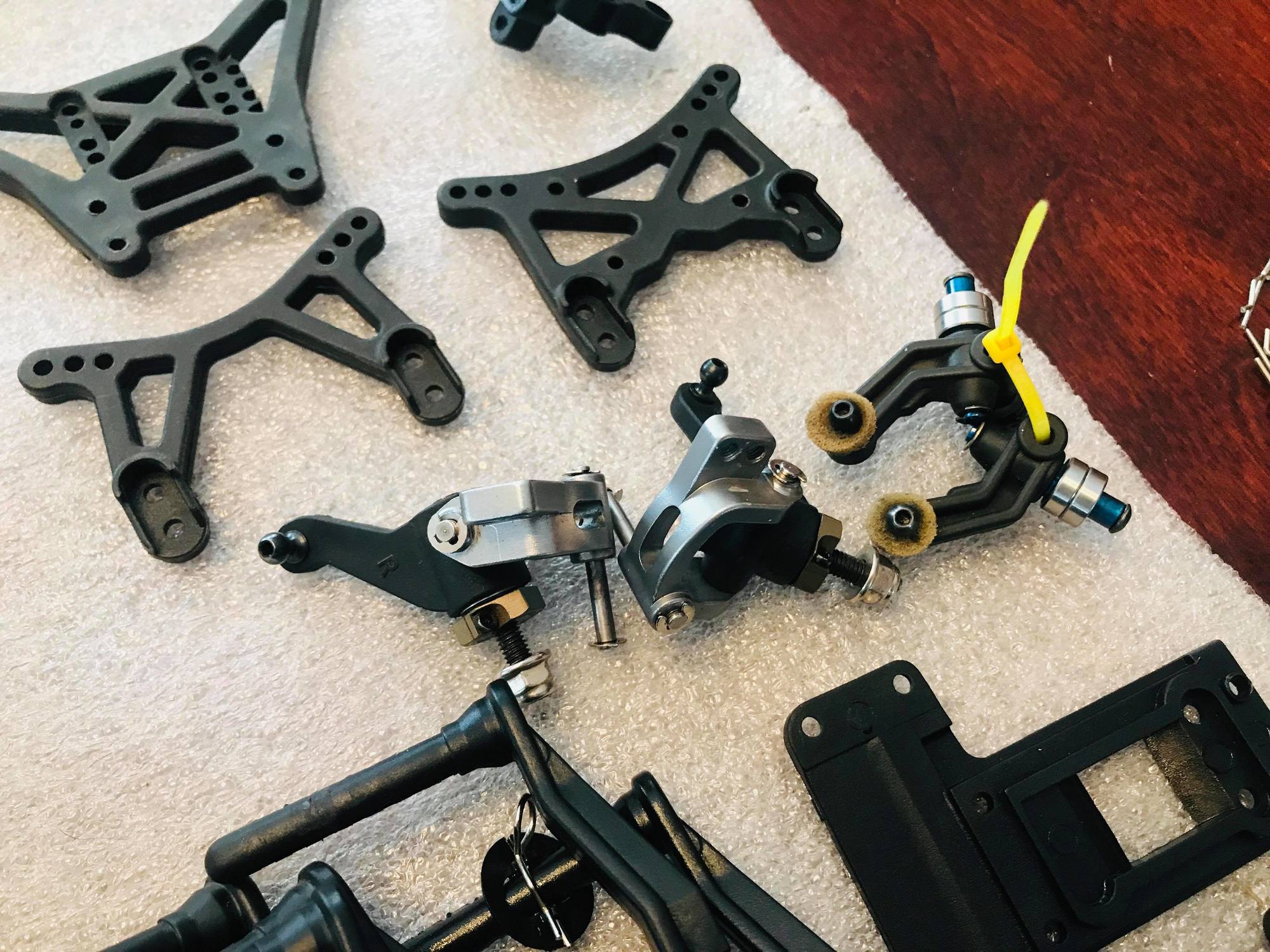

Re: TRX-3 wheels
I used a set of LS2/SRT rear hexes on my TRX1 and AE/Losi style rear wheels, no issues. For the front, I was able to get a hold on some Team C (not sure what the UK brand name is) front carriers/knuckles for hex. Fit right into the arms like they were made for them. Worked on bump steer a touch with some shims and boom. 12mm hex all around on my TRX1, using AE wheels front/rear (I also run a B6, so I had plenty to go around).
The alloy knuckles are the ones I used.
